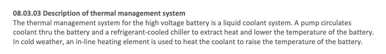

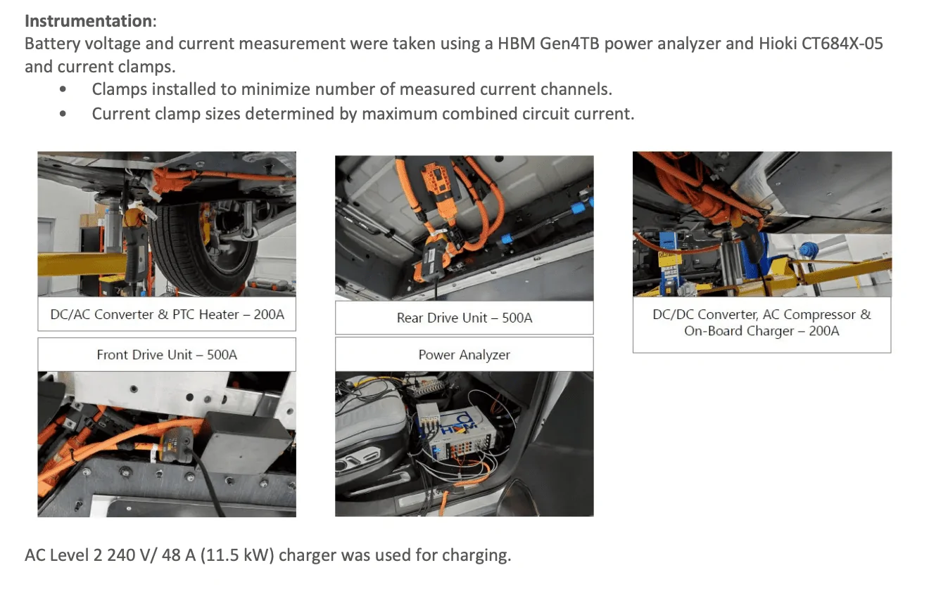

Just to stir the pot a little on this topic, the EPA filing contradicts what the Munroe team in the video claims.
Team Munroe said there is no PTC heater, but the EPA filing says otherwise. Look at the caption for the first photo below. In the text, they state an "in-line heater element is used to heat the coolant to raise the temperature of the battery". ?
