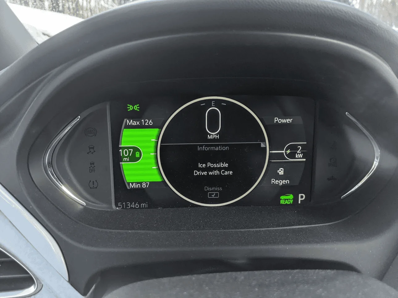

It does on all EV's and PHEV. At 100% there is no room left for adding regenerative charge.
The Bolt will still do around 18-20kW regen when the car stops at 100% charge if the battery temps are good. 100% is not 100% SoC, and even if it were, the battery specs allow overcharging by a slight amount if it's only done for a brief period. It will eventually stop accepting any regen if you were fully charged and went down a mountain. I don't know what that voltage is as I've never had the opportunity to do this. In a Tesla, 100% is 100%. They do that so they can maximize their EPA range. It's not great for the battery, and I don't think other automakers are willing to do it.
