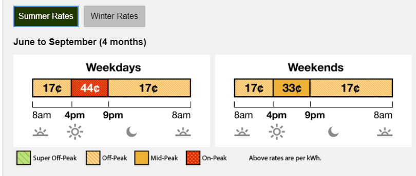

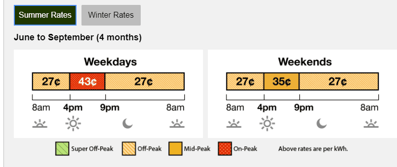

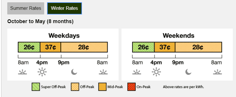

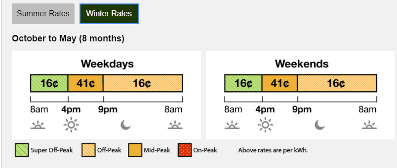

Wow, I thought my rates were high with SCE.
An example of SCE for the TOU 4-9, They also have a 5-8 and a prime 4-9 but these are probably the best rates.
Rivian R1T R1S 80A L2 charging 1621881852577
Rivian R1T R1S 80A L2 charging 1621881888495
Prime(4-9) if you have an electric car or solar
Rivian R1T R1S 80A L2 charging 1621882188616
Rivian R1T R1S 80A L2 charging 1621882220685
