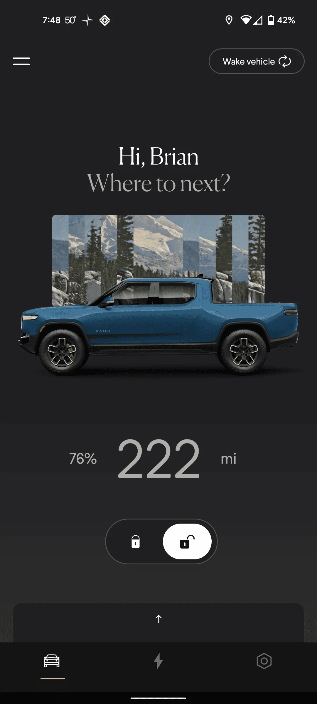

My truck is off at service right now. I was also having an issue with the truck not letting me remote condition occasionally because it thought there was someone in the vehicle. It would make sense that if that's still happening, that the truck wouldn't actually go to sleep based on what's written in the R1T manual.
How do you know if your R1t is "ready" or "off"? Does your app still talk to R1T when it is off?
That's a good question. Right now if I look at the app, I see this:
Rivian R1T R1S Any tests done on Vampire battery drain? Screenshot_20220428-194839
The truck is at the Rivian service center, I can't say I remember seeing this "Wake Vehicle" thing before. Since sleep is the opposite of wake, I have to believe that it's in sleep right now. Hopefully that means they fixed the issue that was causing it to always be awake. Hopefully it isn't just able to sleep just because my phone isn't 50 feet away anymore. I'll check the battery level again in the morning.
It raises the question what “sleep“ means if it still can tell the app what SOC is and if it still can scan for your smartphone. Sleeping with one eye open still uses some energy.
Telematics is likely always on. It probably periodically wakes subsystems to check stuff like the voltage level/temperature of the pack/cells. When the truck is "Ready", that means all the subsystems are going to be active and in a state where the vehicle is prepared to drive. I assume this is what happens if you manually wake the vehicle.
I wonder how much energy goes to talking to the mothership. Can you turn off WiFI easily through the settings or you have to delete your network completely?
Wifi has a slider for on/off.
