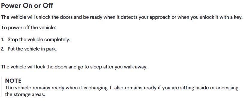

My truck is off at service right now. I was also having an issue with the truck not letting me remote condition occasionally because it thought there was someone in the vehicle. It would make sense that if that's still happening, that the truck wouldn't actually go to sleep based on what's written in the R1T manual.
