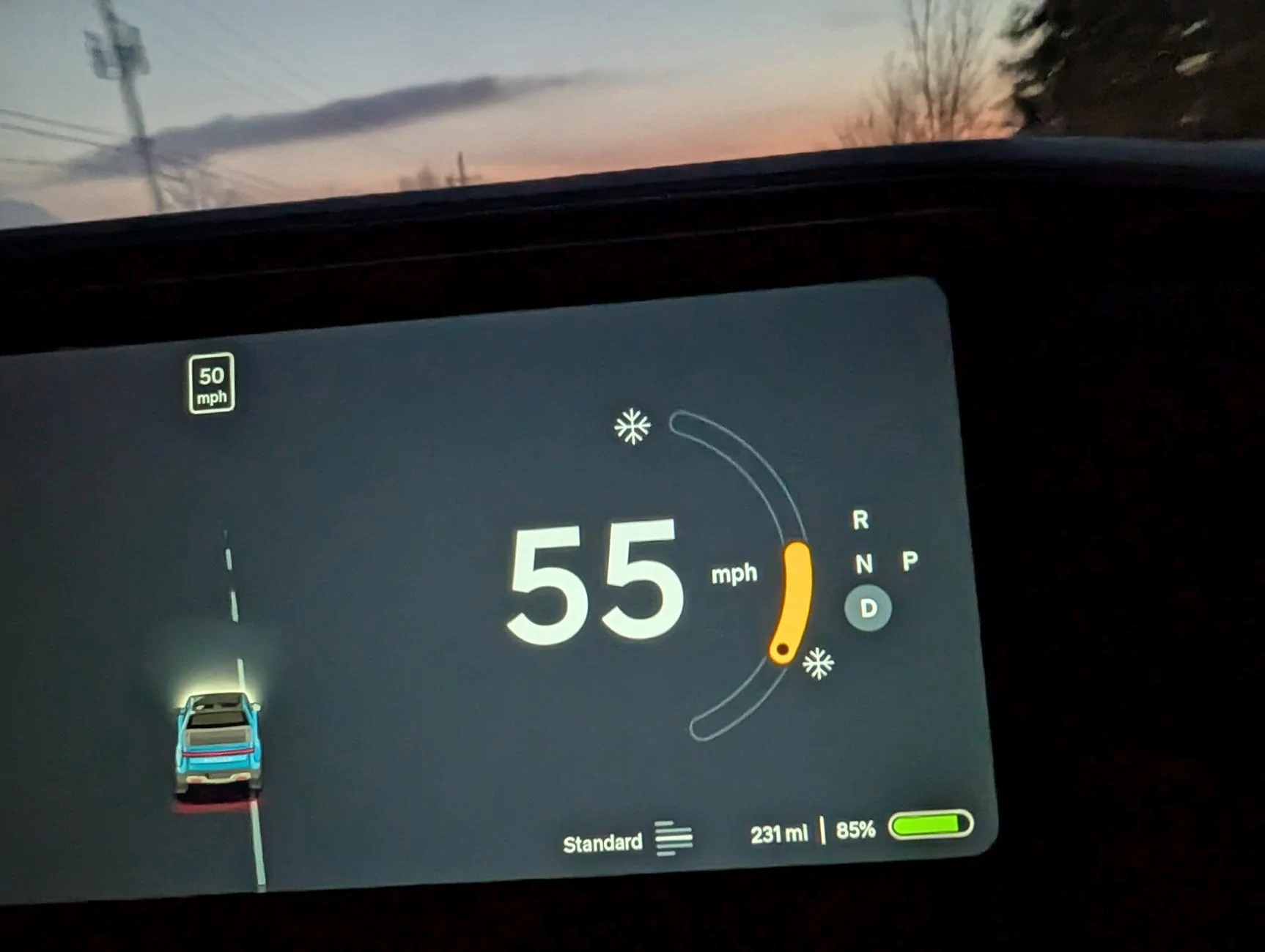

This has me really confused...
Most of the day yesterday it was -3 F. By the time I went home, it was -7 F. S sat for 11 hours while I was working, so it had plenty time to get cold and frozen. End of the day, I hopped in the S, put it in drive, no warning lights, and everything worked like normal. Battery was at 78%, and when I got home, it was at 69%. Thats even normal efficiency for me.

My rear motors turn off when it is cold like that, and the dash tells me i have motor faults
Speed gets limited to 42 mph . Rivian is not built for cold.
Something wrong with your vehicle then. No extra warnings for me with a 5 F pack besides the one about performance and Regen being reduced due to the cold battery this morning. And it wasn't lying, slower than conserve mode would be under normal situations, but no speed limit I noticed. Too much slow traffic and slick roads to get much above 60 at any point, though I don't recall any abnormal limitations above 51 mph.
I'm having this issue too. I posted the details in a different thread last evening: https://www.rivianforums.com/forum/threads/motor-failure-message.38637/page-2#post-709262
Rivian roadside assistance assured me it's not because of the cold weather, but I highly doubt that. Because it's happened twice now on consecutive days, they are going to service the truck. Very frustrating to be dealing with this.

OP,
I had a failure to charge earlier this week at -16°F.
My L2 home charger (a Grizzl-E rated to -22°F) was operable, but the vehicle wouldn't accept power).
Turned out the Rivian computer that controls charging was cold. Blasting the cabin heat on HI for about 5 minutes fixed the problem and the vehicle started charging normally.

I'm in MN too and haven't had any issues at all. My truck sits outside all day while I'm at work and, even in the -20F weather we've had the past few days, it does just fine and doesn't throw any weird faults or issues.
