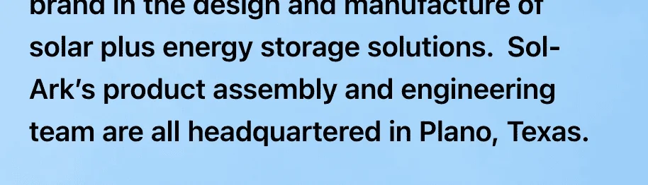

Sol-Ark is another top brand that can blend power. I have a Sol-Ark 15K and it's pretty impressive. It is on the high-end when it comes to cost, but it has a ton of features.
I'm seriously considering the Sol-Ark 15k for my system install next spring. I've been studying the specs and manuals for the past week or so, I don't think there's anything on the market with all its features. Looks highly flexible. Made in USA..... +1.
It's not made in the USA. The company has received flak for stating that in the past. They do offer US based customer service that is top-notch.
Good to know, I was going by this statement on their web site "product assembly and engineering team are all headquartered in Plano, Texas." But I guess they could be assembled overseas while "headquartered" in Texas...
One aspect of sol-ark to be careful of is the hard amp cutoff at the rated output. Also check the spec for the amp difference allowed between L1 and L2.
The software may be U.S. made, which is more important support-wise than the hardware. I assume Victron, which is Netherlands based, is also mostly custom Chinese hardware.
