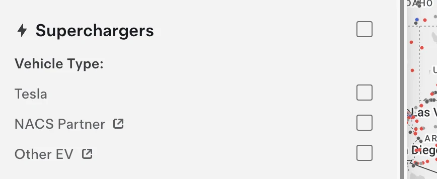

Some of the verbiage here is confusing. Shouldn’t we simply say it’s just not open to non-Teslas? Saying it’s not NACS doesn’t seem accurate since teslas themselves use nacs and the actual connectors on the stations are in fact NACS, aren’t they?
Tesla refers to these as NACS Partner or NACS sites. It is Tesla, NACS Partner, Other EV (magic dock).
Aha thank you. Was confusing without the “partner” part of it. Makes sense now.
