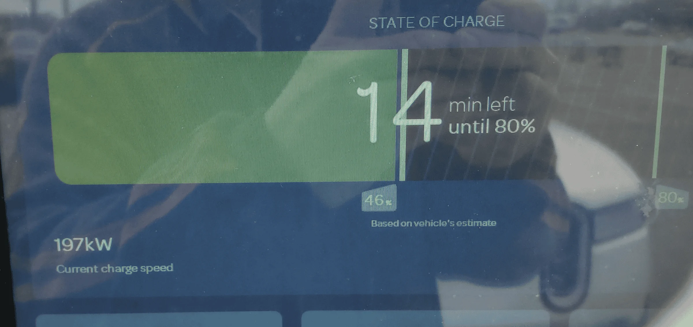

Annnnnddd.. here’s some proof that there is no 350A EA limit…
Nice! Was it an ABB? Were you able to avoid the infamous battery conditioning?
rhuber
Sep 14, 2021
181
1,219
Peoria, IL
Model S Plaid, 64 Mustang
It is a signet. And it didn’t throttle once

EA stations most probably adhere to CHaRIN standards. HPC350 stations are limited to 500A. To get 200 kw from a 500A supply requires 400V which an HPC350 station can easily supply if the vehicle asks for it. So nothing noteworthy in a car getting 190 kw from an EA 350 kw station.

197kW seems to be a common ceiling:

That's 300A limited.
180kw+? The R1T is would max out at about 135kw at 300A with peak pack voltage at about 450v.
That's what I've been seeing. I wonder if starting with a cool, balanced battery at say 20% would result in the 60% step down happening at a higher percentage. Hopefully Rivian hasn't hard coded those steps; why would they? Is this a kludge till they finish code for pre-conditioning, etc.?
I was told "200 +" is the limit today and "300" is the expected max.
The 800v LFP changes everything and hopefully arrives with more than the discarded NMC 180kWh.
196kw is the max we've seen so far with Rivian limiting it to about 450Amps.
The steps in that table are it throttling a little early, most likely due to thermals.
Welcome back. The topic at hand is a large number of EA stations (though not all) are not giving out more than about 350A. Even when they should be capable of 500A.
Cause: unknown. Could never EA. Could be how Rivian and Mercedes are communicating with a specific series of chargers.
I think it's 350A, but I'm also not sure about the actual voltage, just to say it's not pack limitation.
My R1T showed a steady 197kW (flickering around that number, I think I saw 200+ for a few blinks but it wasn't sustained, so it's not really relevant and could just be software in that instrument readout.)
According to Kyle / OoW the steps were arbitrary (not related to temp) and the battery temp management was the initial dip-recovery at 25% then the zig-zig steps down.
For now, I think we can conclude Rivian will go to a heat pump for the Max Pack with LFP and hopefully more than 180kWh, and the software will have fleshed out pre-conditioning, etc.
