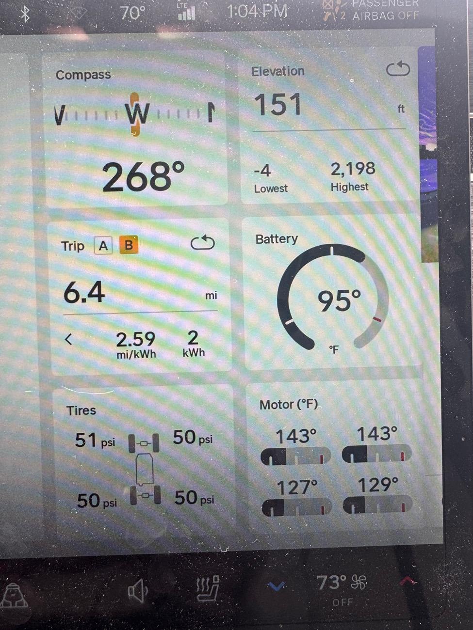

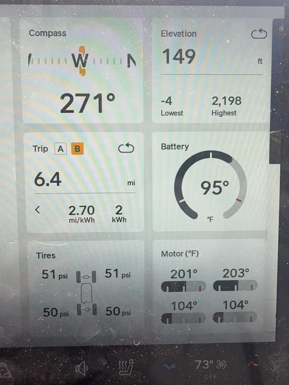

Actual test data:
Rivian R1T R1S Conserve Misconception IMG_0714
Rivian R1T R1S Conserve Misconception IMG_0709

LOL you win dude. What a complete waste of time. Now please, proceed to get the last word.
Have to agree on all counts, send your data (if/when u can ?)
