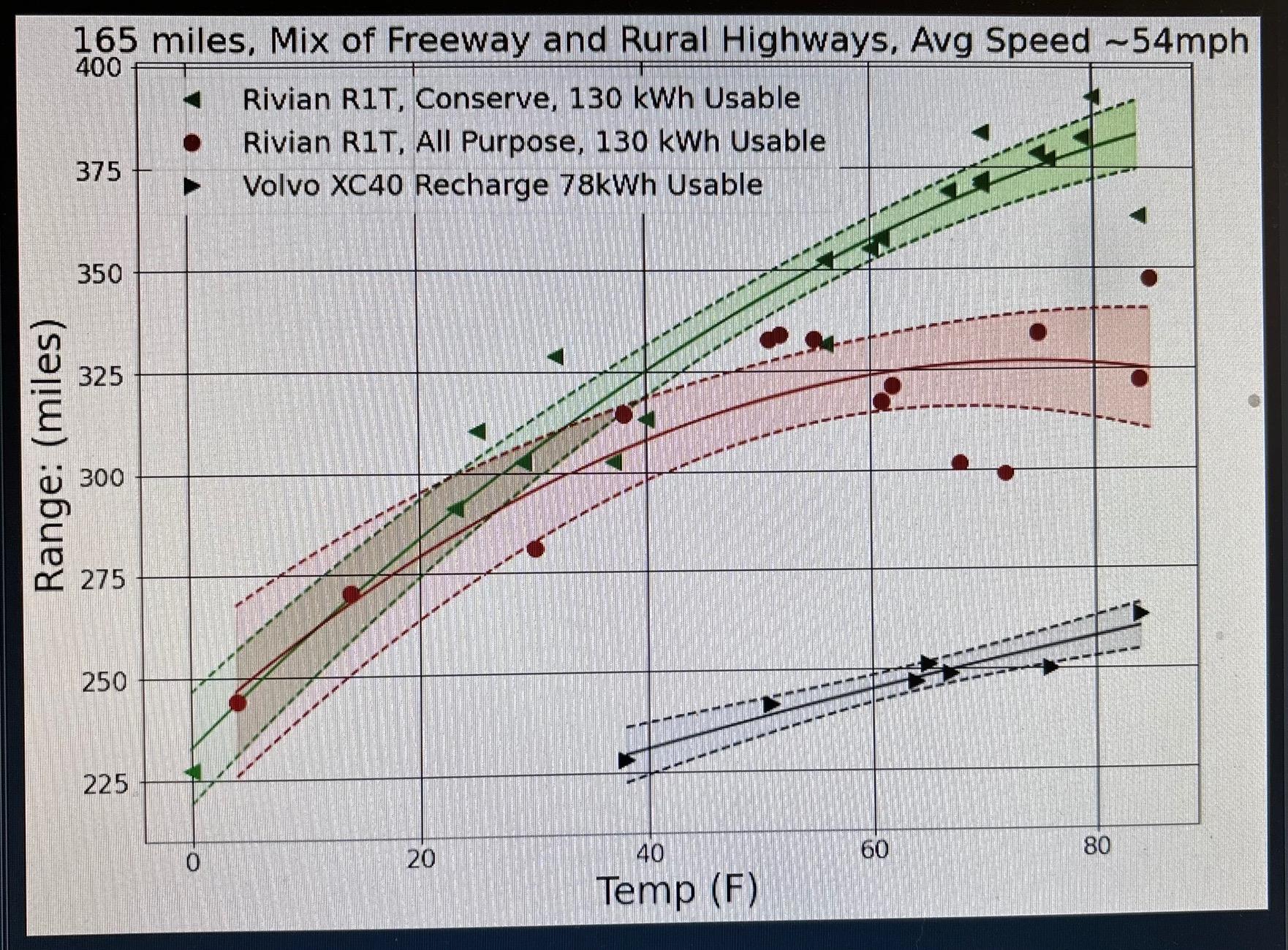

I agree with the OP. Conserve is fine for tire wear. And, as also noted, conserve only real gets better efficiency at warmer temps based on my data collection from the same 165 mile route driven many times.
Great work! That shows some legit range addition! Good to know much below the 30s you don't get a huge help. Have to do anything with how it heats the motors up to help with other stuff in the vehicle? Or another reason?
I think, and I’m only guessing, but it might be because at lower temperatures some energy from the motors goes into keeping the battery warm. If in conserve mode, the two motors have to work harder to provide that energy negating the benefit of shutting off the other two.

I'm such a dork and I love this data too. In my experience, the range estimates on the Rivian have always been "conservative" and when I'm in Conserve mode, that is even "conservative" in how it estimates range - to see that spelled out in the data shared here warms my heart.
Others in this thread have tried to downplay the value of Conserve mode by suggesting that it isn't that great - but in practice, we charge up at home to 100% for a long road trip - we use Conserve on the highway which easily adds 50+ miles onto the 280 mile range. Add to that a more "conservative" drive style (driving 65 on the highway instead of 80)... On a long 6 hr roadtrip, it can be the difference between stopping once for 30 mins charge or having to stop 2+ times for 90+ mins of charging. It all adds up and its all about being smart about how you drive an EV. Net net, an extra hour onto your journey.

Just confirmed via real world test:
Concern Mode = gimmick
Course: ~3 miles out, 3 miles back.
45 mph, ~70 F
1st Test - AP
2.51 miles / kWh
2nd Test - CM
2.62 miles / kWh
For this comparison (45 mph), CM is -~4% more efficient than AP, however, motor temps on front were >200 F using CM. In AP fronts were 140 F and rears were 130 F.
Based on a 100% SOC, this could increase range by ~10 miles only.
In order to get a 40 mile increase using CM, there would need to be a 14% difference between AP and CM. For example, 2.55 in CM vs 2.22 in AP.
