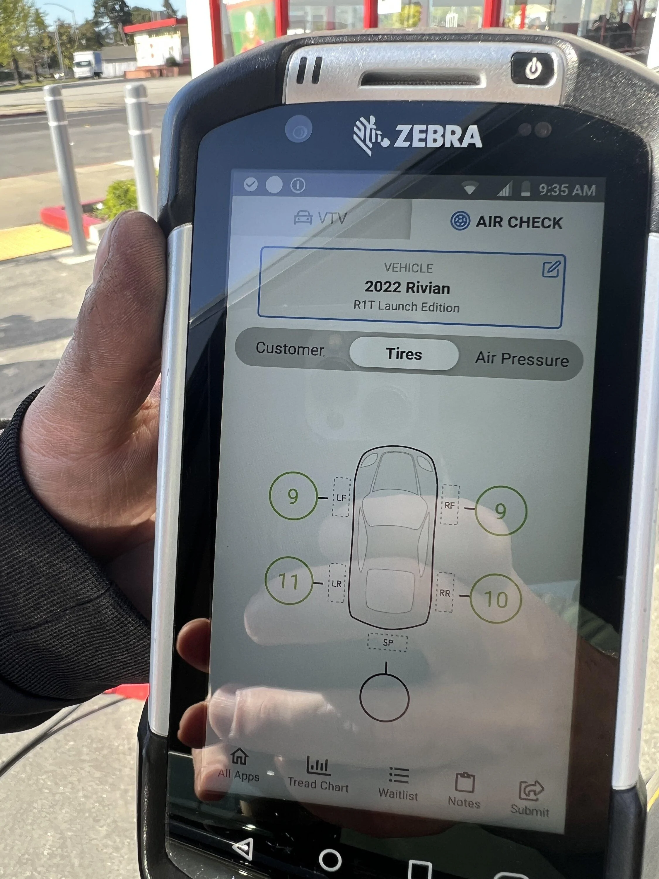

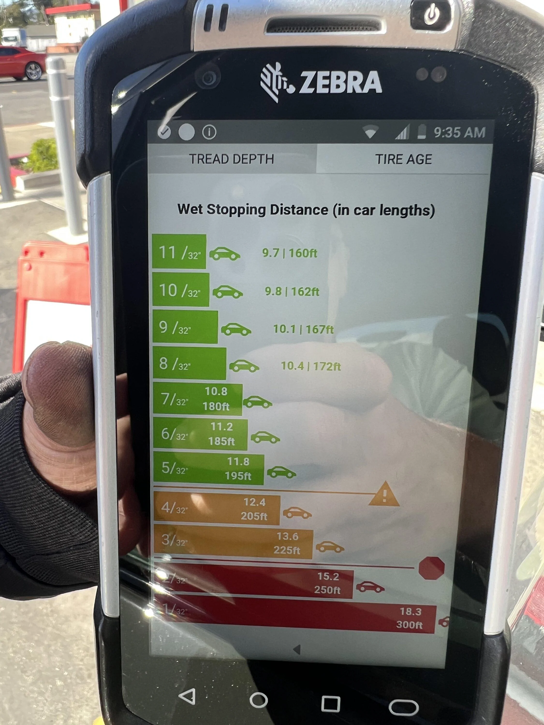

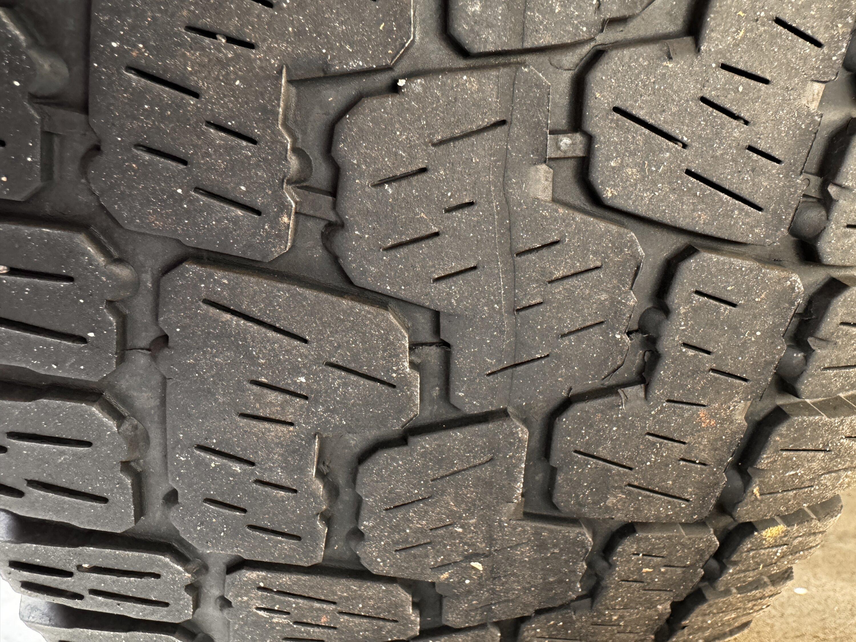

I wish my 20 inch ATs lasted over 10K. They’re gone and I was just trying to figure out how much to cost me per mile to drive the vehicle. So the cost of over $2000 in tires for 10,000 miles that’s $.20 a mile just for tires. That’s about 2x of what I pay for the electricity to drive the vehicle charging at my home. I pay about $.20 a kilowatt and that $.20 gets me 2 miles so in reality I used 500 kW so I spent $1000 for electricity and $2000 for tires. I rarely use conserve mode. Alignment sucks big time. Been aligned 6 months ago. In again tomorrow.
Do you have the suspension on "auto"? IMO the Pirelli's suck, but driving around in anything but "normal" suspension height will wreck your tires. I learned that the hard way too. I went to normal suspension and mostly AP mode on my second set of tires (Michelin). As of today have 35,000 miles on them and at 8/32. Excellent tire life.

This is why McDonalds has to tell people their coffee is hot. So you drove your R1T in front wheel drive for 10,000 miles and never rotated your tires? Yes, I would expect exactly what you have discovered, front wore out and your rear tires most likely still have a lot of life. I have 22’s, I’ll be rotating every 5k and I’m not expecting more than 20k from these Pirelli’s.
No OEM tires have a warranty that I know of unless they do a good Will replacement.
False, don't use the McDonald's example here. Their coffee was repeatedly too hot and they were warned on multiple occasions.
And while I sympathize with OP, he only has himself to blame. The info is out there and maybe even he was told in passing but didn't remember. Not Rivian's fault.
OP, use this as a learning experience for the vehicle. It was a relatively cheap lesson, no one got hurt.
The most egregious thing here is that OP was driving around nerfing that 835HP on purpose.
