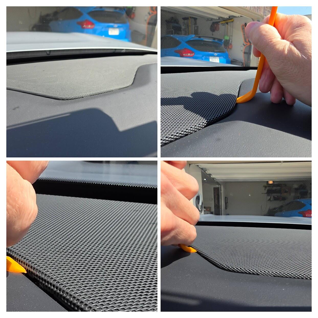

You won't see it in a picture as I pushed it underneath the grill with the plastic trim tools (mine are Orange, not yellow as the OP's :p ), but basically, I cut two pieces about 1/2 inch each and stuck them with the adhesive UPWARDS in-between the grill and the trim.
Here you'll see where I "forced" a gap to open a bit:
Did you do it only for the midsection? or the full length of the grille? Looks it'd be tricky to maneuver the tape into place while the adhesive side is grabbing and sticking.

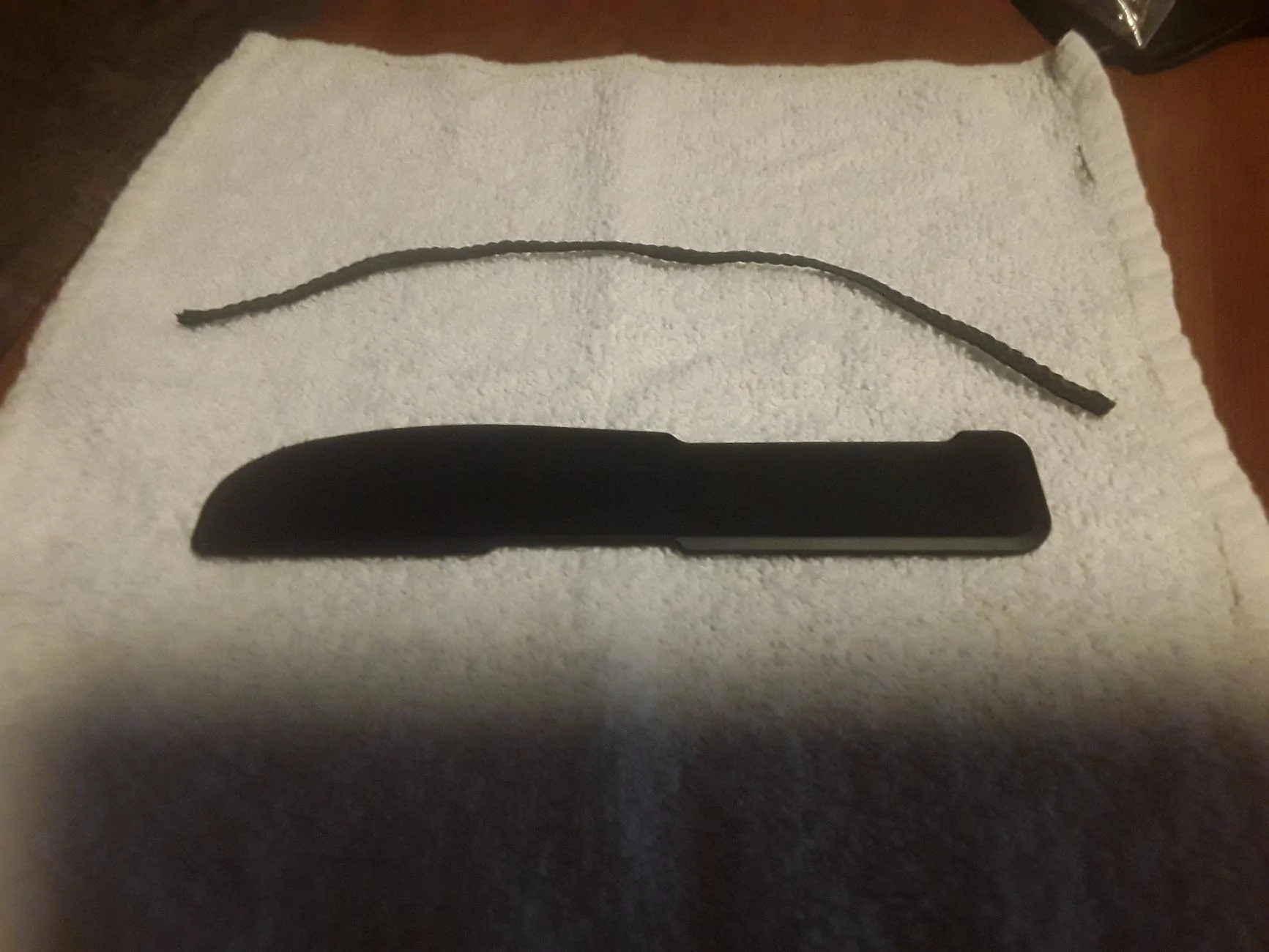

Success. I just used a 12 inch piece of thin cord and pressed it under with the plastic tool pictured. Any sharp edge plastic knife should work. You don't need to spread the joint. Just press the cord under until it disappears. Took it out for a 12 mile ride. 90 degrees and some bumpy road sections. Not a rattle noted.
Starting to sound like the rattle is the from the leather part slapping against the grille, not against whatever is underneath.
Thanks for sharing pics. I've pulled the dash apart twice trying other methods so will give this approach a shot; also nice FoRS 😉
