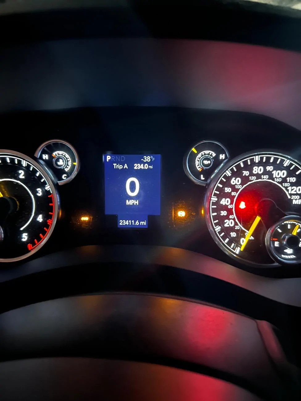

They do in summer, but not winter.
But you didn't define what each mean. Here, summer means 120 degrees, and winter means 50-80. As it should be. If your winter is below that, there are movers.
Thanksgiving night.
Rivian R1T R1S Do tesla superchargers derate in winter? IMG_0486
