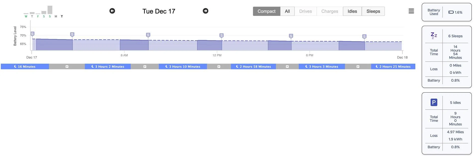

I only noticed something was wrong by observing the VERY frequent sleep/wake cycles using Electrafi.
How often is VERY frequent? I was out of town(so no chance of any proximity wakeups), with my car parked in the driveway with gear guard on and see a cycle that looks like this on my brand new gen1 R1S. Is this normal, or too frequent?
Mine was more frequent with Gear Guard off

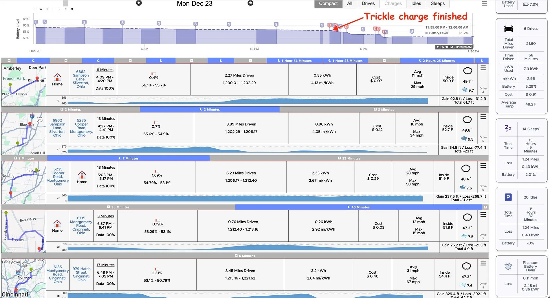

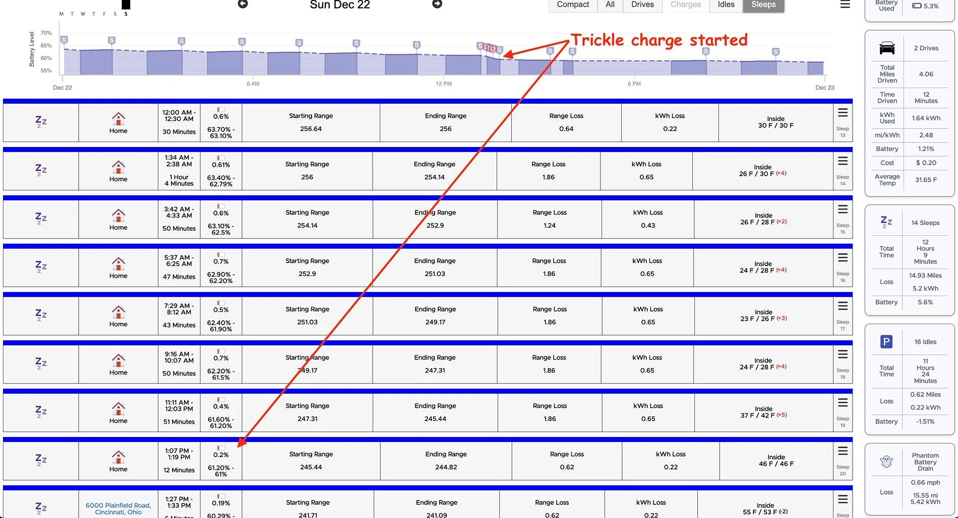

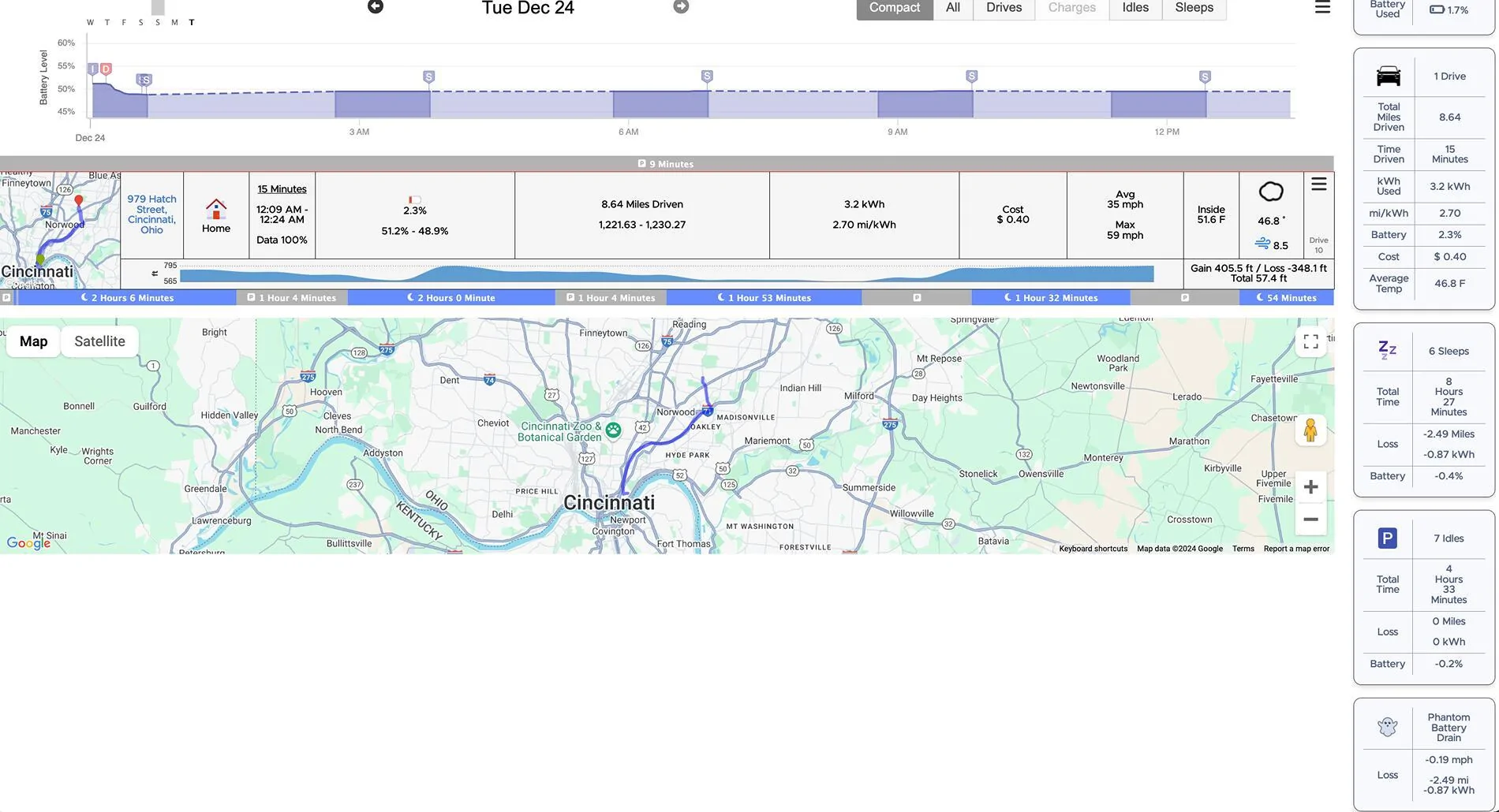

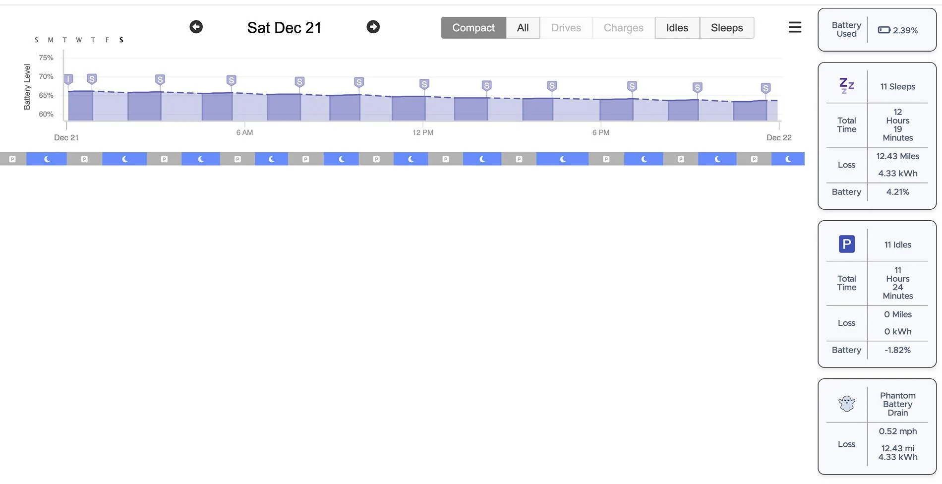

As promised I am reporting back on this busy post! I initially chimed in because the VD level I was seeing (in a near new R1T Gen 2) was crazy high, confirmed by the electraFi app.

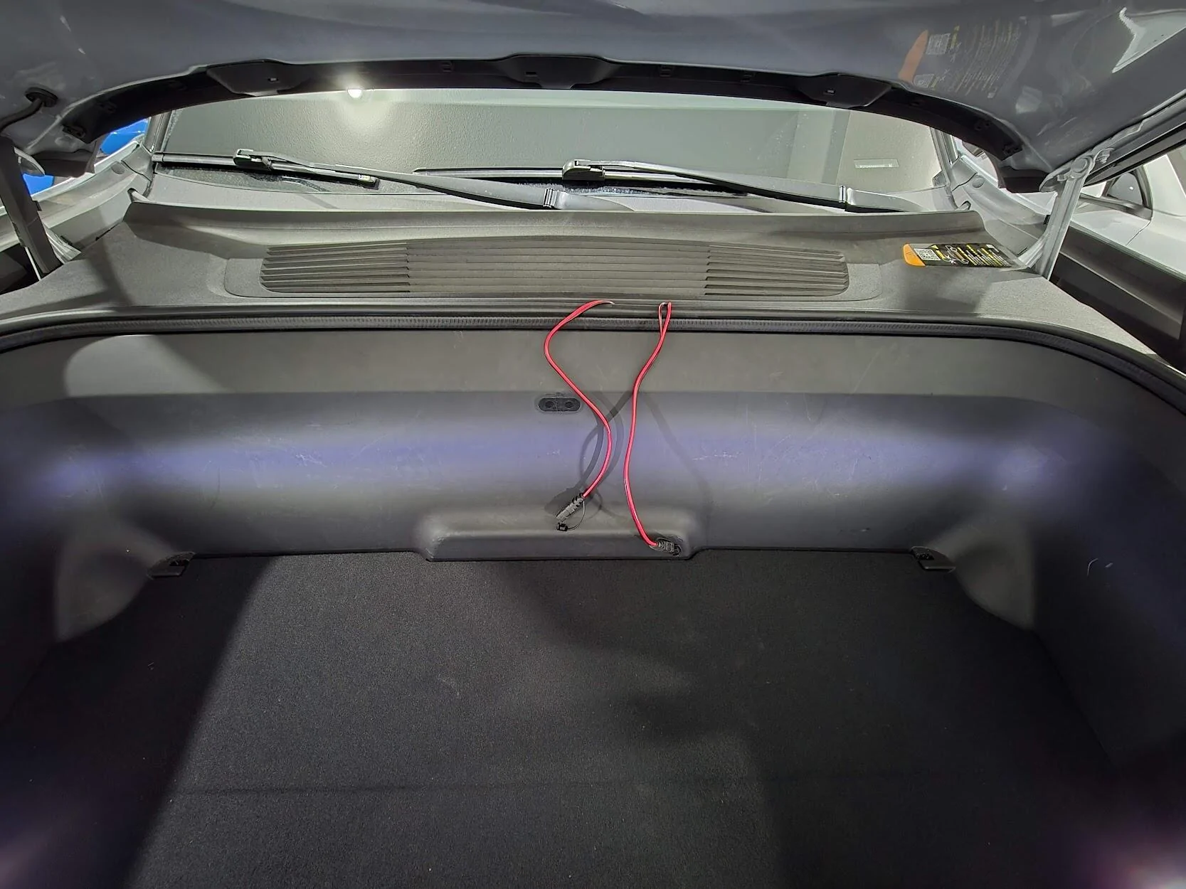

So I tested using a trickle charge to the Gen 2 12V positive access in the frunk, and chassis ground, using a 1000 Wh Jackery power bank for ~24 hours.
In summary, using the trickle charger pretty much reduced VD to zero - success!! But after disconnecting the trickle charger I was (so far) pleasantly surprised to find that the VD is still near zero, in fact a modest negative loss VD!
Question: Since I lodged a request to Rivian to update my software to correct this VD loss (per another users post which corrected their Gen 2 VD by software update) might they have installed a fix over the air? Or did my experimenting with trickle charging result in some kind of 'corrective' action?
Here are electraFi screenshots for Dec 21 thru Dec 24:
Rivian R1T R1S Gen 1 Vampire Drain (Possibly) Solved (or Hacked) TeslaFi VD Dec 21
Rivian R1T R1S Gen 1 Vampire Drain (Possibly) Solved (or Hacked) TeslaFi VD Dec 22
Rivian R1T R1S Gen 1 Vampire Drain (Possibly) Solved (or Hacked) TeslaFi VD Dec 23
Rivian R1T R1S Gen 1 Vampire Drain (Possibly) Solved (or Hacked) TeslaFi VD Dec 24
I think you're basically confirming what I explained here https://www.rivianforums.com/forum/threads/trick-for-maintaining-health-of-the-12v-battery.37720/
Your 12V charge level is healthier now. Still doesn't look like "new" to me, but it's wayyyy better 100%
