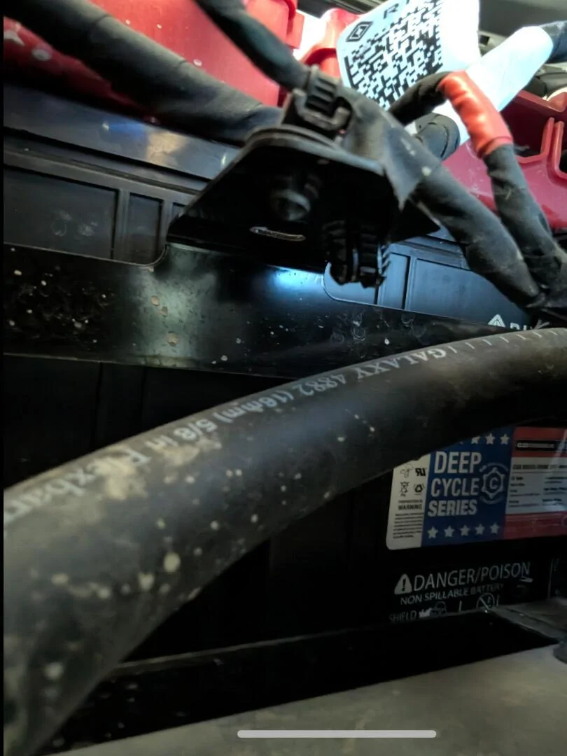

Did you connect one split line to both batteries? So both 12v batteries are now directly connected? Without opening mine and looking, I'm not sure if they are.
I connected each of my two batteries to a separate trickle charger. I wanted to keep the batteries separate so I could check their health status separately with my battery tester.
