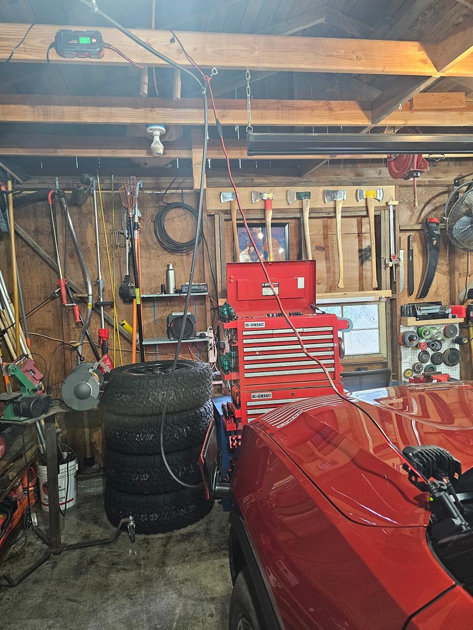

For ease of charging I'm connecting the 12v charger via a ChargeSafe - Magnetic Trickle Charger which I attached via included double sided tape to the left lower front windshield. The cable hangs down from the ceiling about 3 feet off the floor (as does by 220v charger cable) such that they are just in front of the left corner of vehicle where I park in the garage. This makes plugging and unplugging very ease. My 12v charger is rated to 4 amps, but I'm not sure if that matters.
I don't drive much, so the vampire drain was nearly half of my overall Rivian consumption and driving me crazy. I'm not worried about VD when on trips, since it's such a small portion of the time my Rivian spends inactive. I'm very happy with the results of this setup having cut loss down to about a 5th of baseline

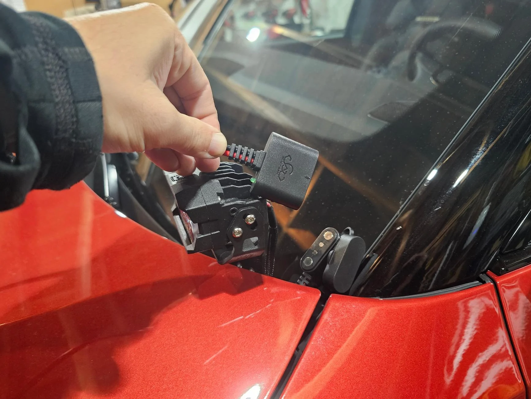

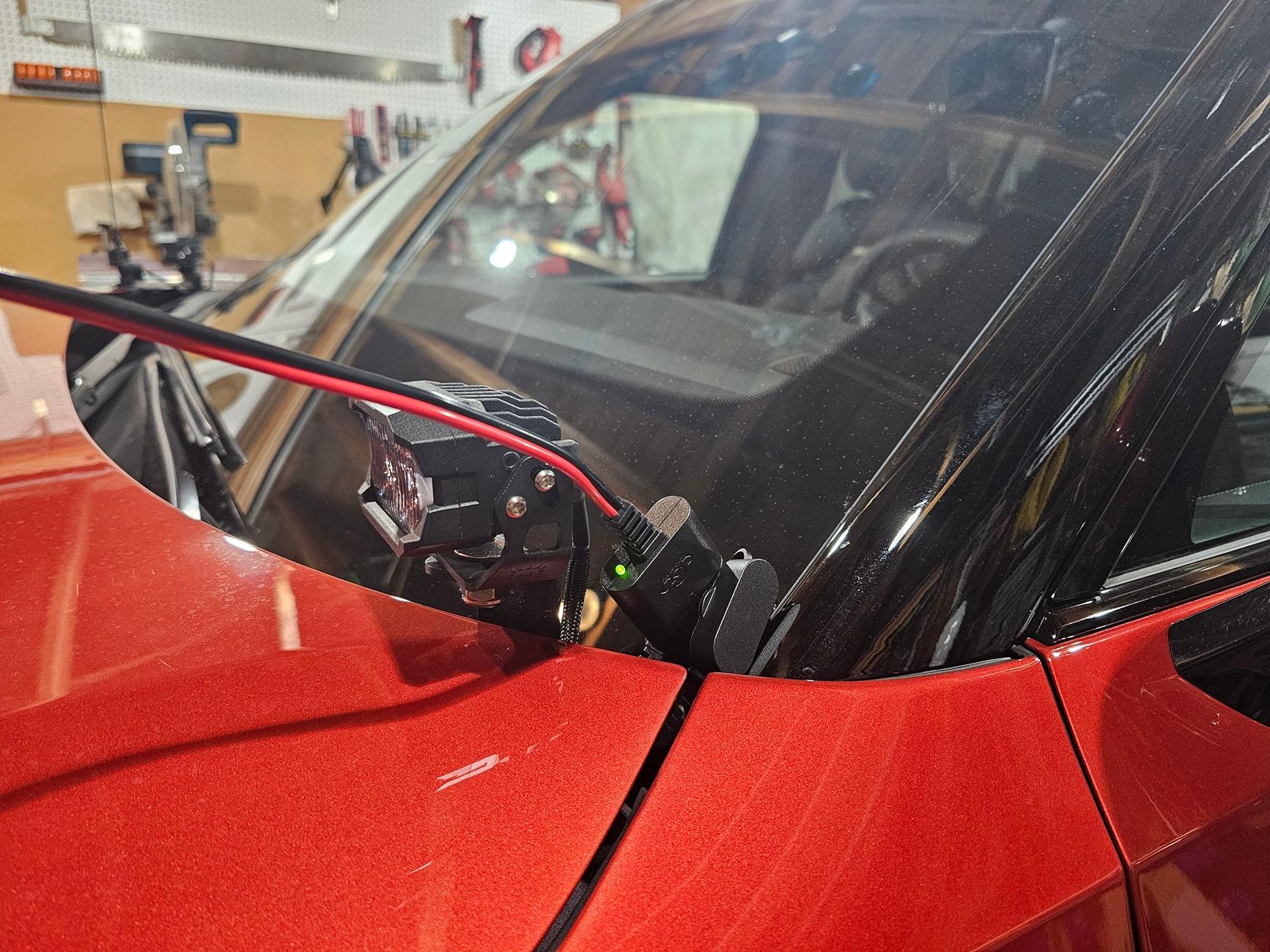

In any case, thanks to all your input on this subject (and for @shrink who started this thread), I decided to install SAE connectors direct to my two 12V batteries. This approach allows me to directly trickle charge those batteries as well as test the batteries for health before bricking (using a device like this https://www.amazon.com/gp/product/B0017R5EQK/ref=ppx_yo_dt_b_search_asin_title?ie=UTF8&psc=1)
I tend to drive my R1T regularly and at most may let it sit for 4 days. In summary, with both 12V connected to 2 separate trickle chargers (4 Amp ones), I lose 0 miles and 0% SOC over the extended 4-day non-use.
I first tried using the OBDII port (per @JerseyGreens) since it would be easy, followed by just trickle charging the primary battery direct, and finally settled on trickle charging both batteries (per@NY_Rob).
Here is my log for losses over 4 days:
OBDII charging lost 2%, 7 miles
charging primary 12V lost 1%, 3 miles
charging both 12V lost 0%, 0 miles
My data is just for 4 days at a time since that is my maximum period for non-use. Also, I didn't track how much power the trickle chargers use, but they definitely don't stay on long and I am sure they won't make up for the huge percent losses from the high voltage battery.
I placed my SAE connectors at the two corners under the hood towards the windshield (per @ascientist).

Do you have one on each side of the windshield, and both connected to both batteries?
I have one on each side of the windshield tucked in at the edge and each is connected to a single battery.
