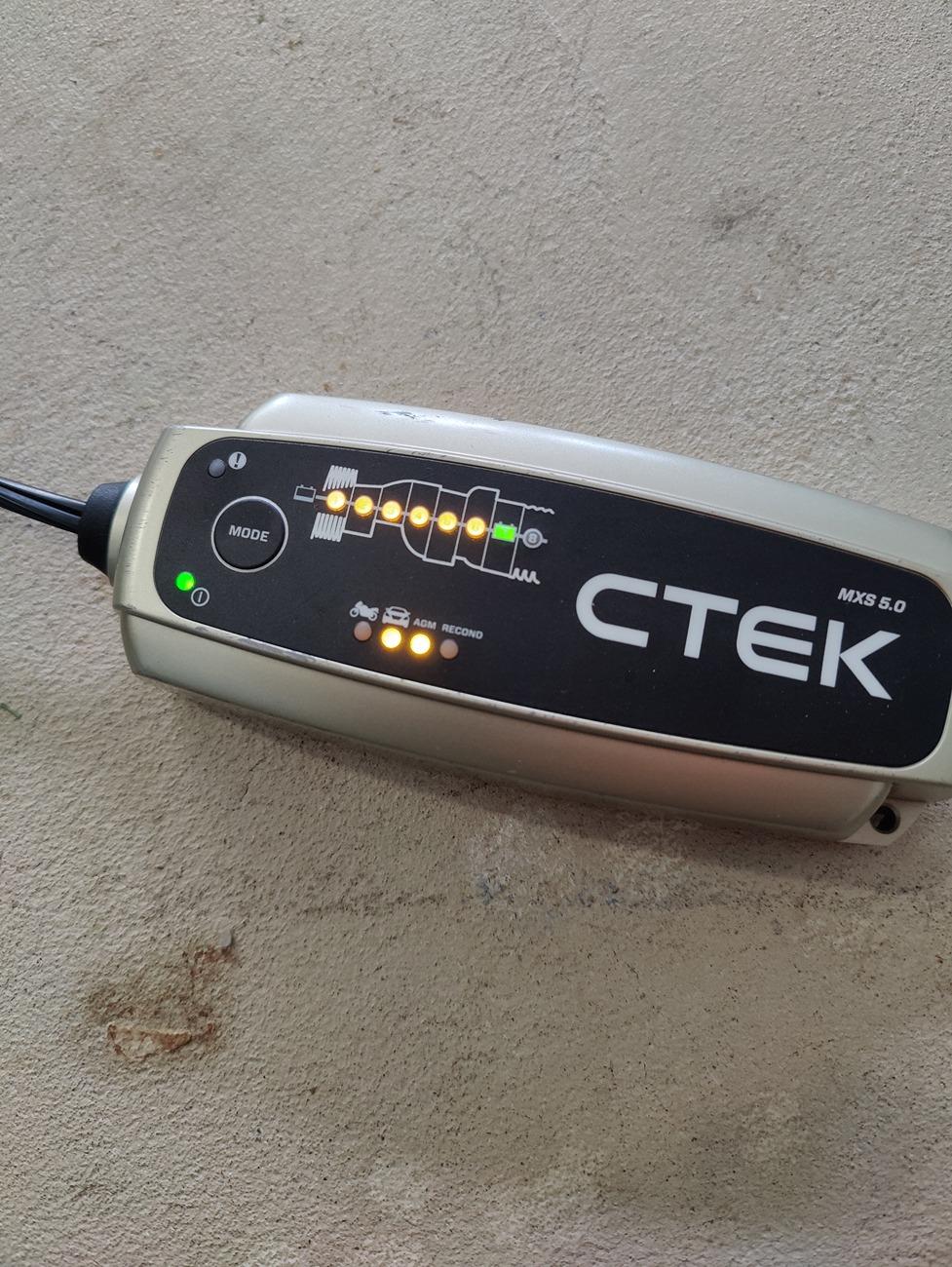

As expected no VD overnight. Sitting at 135 miles which is the same as last night. Awesome way to protect my excess solar production now.
Thanks for your posts! I also have a dual 12V battery R1T and was hoping to go the OBDII port route (just for ease of connectivity).
Have you been able to determine what happens to the secondary/passenger-side battery when charging via OBDII port? My understanding is that the OBDII port only connects to the primary 12V battery on the driver's side. I am wondering whether all the VD (wake up/sleep cycles) are using just the primary battery.
My alternae route would be to go with @NY_Rob's solution and wire up both 12V batteries for trickle charging.

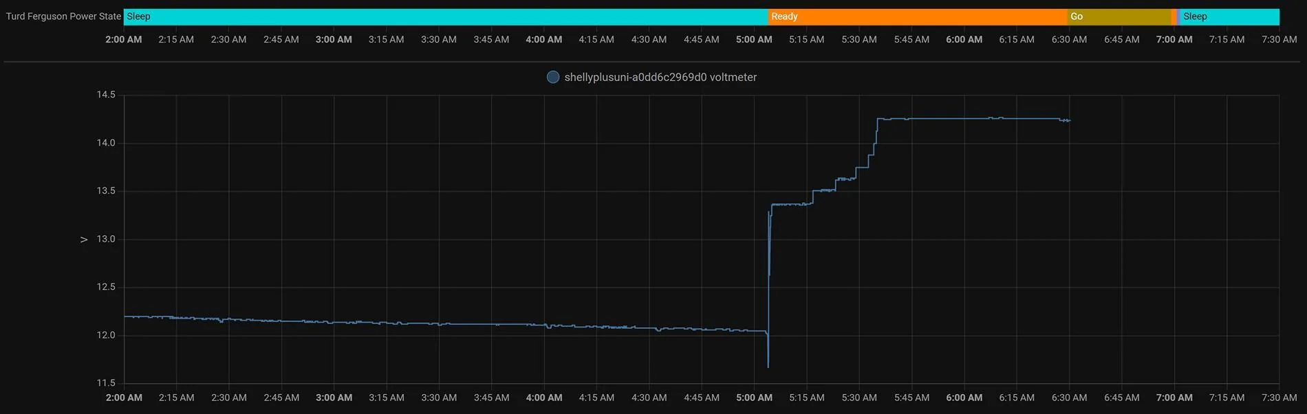

Also, FYI, I'm measuring the 12V Battery from the Ride menu every morning to see the voltage. I think in the future this will give me some data :)
I don't think this will give you any meaningful data. The vehicle will boost voltage to ~14.25v when it wakes.
Not always, I assume that's while charging only (? not really sure)
My reads are MOSTLY at 13.3 to 13.5. I do see it ramping up to 14.xx when plugged in :)
Well, yes, you are correct. ~ 13.5v when operational, but it boosts to ~14.25v when charging the 12v (which it does nearly every time it wakes in my experience). But the battery also drops to nearly 12v before it wakes to charge. If it doesn't... this is when we have vehicle problems. That's why several of us have installed real-time 12v battery monitors to detect when that charging doesn't kick off, so we can intervene to prevent a brick.
