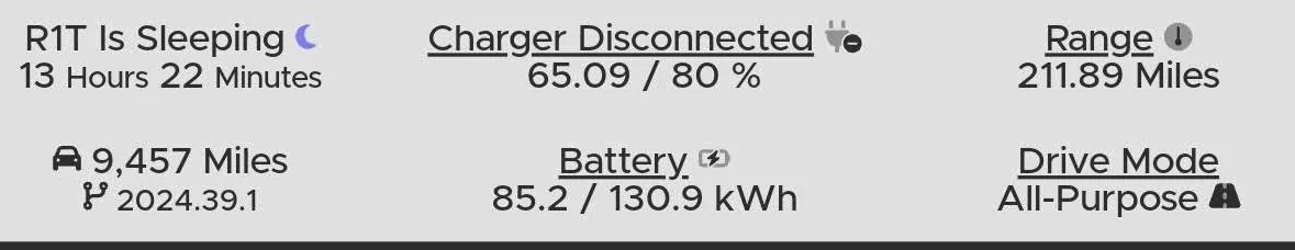

Well... With Connect+ and connected to WiFi in my garage, I still get this overnight
Rivian R1T R1S Gen 1 Vampire Drain (Possibly) Solved (or Hacked) 1729183729138-b4
(took this screenshot this morning)
So I don't think that might be a factor honestly
