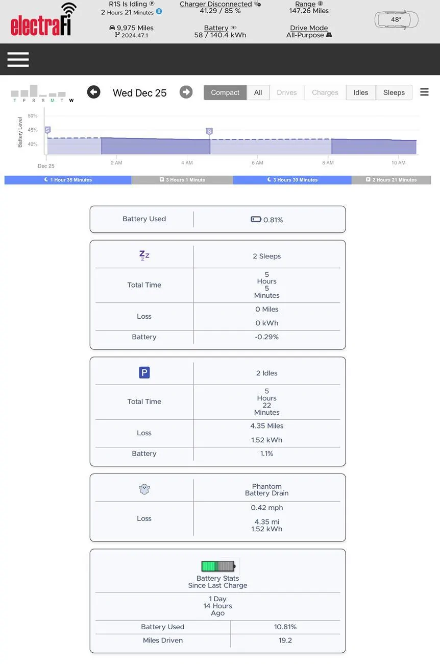

Mine’s the worst it’s been….
Rivian R1T R1S Has your phantom vampire drain significantly improved with 2024.47.x software update? IMG_4653

2024 R1S PDM Max Pack 20" AT
Apparently I've already burnt through 1.5kWh and it's 10:30am ? my eco-friendly kilowatt burner
Rivian R1T R1S Has your phantom vampire drain significantly improved with 2024.47.x software update? 1735151521749-th

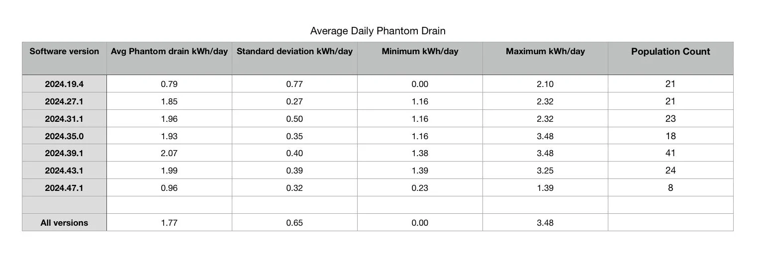

eletraFi today is reporting my capacity is back to 129.8 kWh
I parked the truck at the airport at 75%, and when I returned 6 days later, the truck was at 70%. This was half the phantom drain as recent trips with air travel.
I now have 8 days of data on this software version:
Rivian R1T R1S Has your phantom vampire drain significantly improved with 2024.47.x software update? IMG_1974
