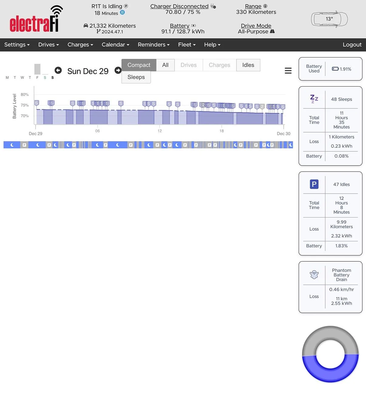

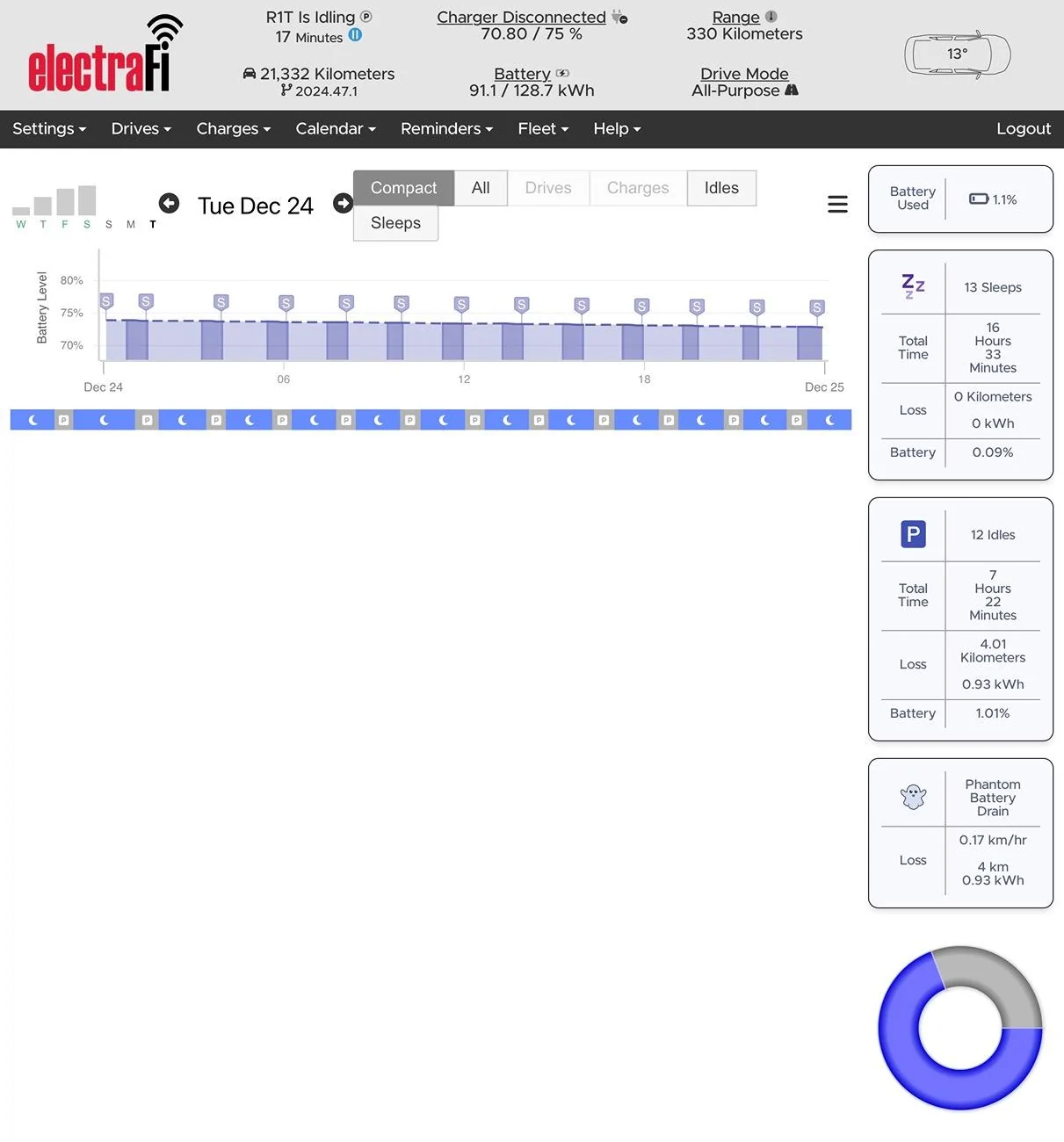

Here was a day the truck was sitting unplugged in an airport garage
Rivian R1T R1S Has your phantom vampire drain significantly improved with 2024.47.x software update? IMG_1975
And here was yesterday sitting unplugged in the garage which is below the living area. Proximity locking is off. Weird
Rivian R1T R1S Has your phantom vampire drain significantly improved with 2024.47.x software update? IMG_1976
Agreed. Is BT on via your phone for the second garage parked scenario? I ask because I beleive even when proximity is off there may be some polling going on with BT (nothing factual, just my hunch).
Yes, Bluetooth on when parked at home. The truck did 33 sleep and 35 idle cycles on the day before
My big reason for keeping track of phantom drain is while parked at an airport, or while snow camping at Mount Lassen. Iā€˜m not sure it’s cool to plug into one of two Level 2 chargers for 3 days at the Visitor Center
