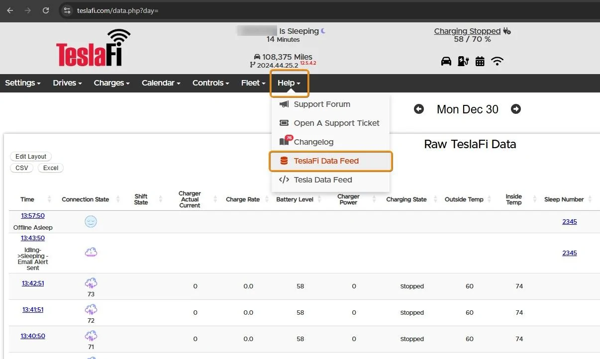

Do you have this data screen like below? For Tesla's you can see the 1 minute snapshots and edit whatever columns you want. It may let you see a pattern for your sleeps and idles. HTH

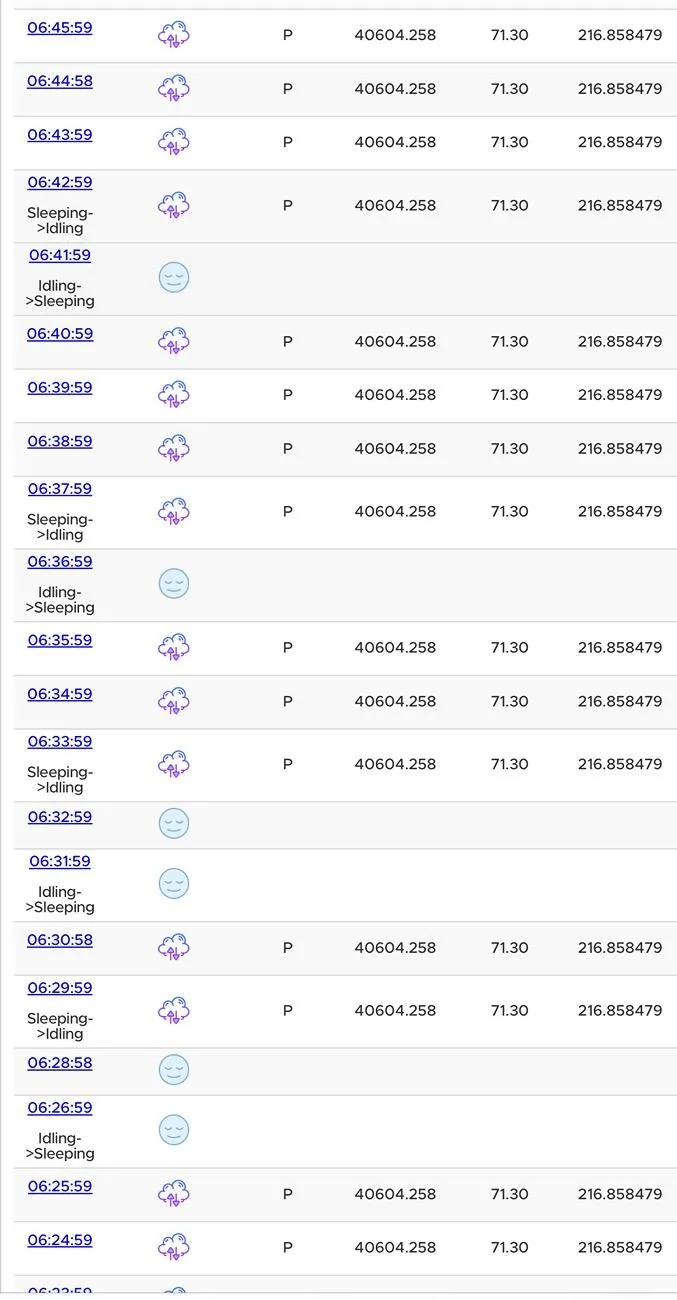

Thanks for that tip! I do have that option in ElectraFi as well.
Looking through some of today’s data, it looks like it goes through these random idle/sleeping cycles for about 15 minutes give or take 5 minutes, then will sleep for about 30 minutes before going through the cycles again.
You are very welcome. Always curious how non-Teslas are handled.
Did you happen to do the 'Edit Layout' option and take a wild guess as one of the tracked data values that is tracked which changes at all? eg. the 3 shown above are all fixed.
There are some that are states (on/off) like climate or 12v related (DC-to-DC) or ? ... just to look for something that changes and may give a hint (to you or Rivian). Certainly Rivian have downloadable logs to look at too.

Wow there are quite a few options available to add. I assume each <NONE> value can be assigned a value to track?

Ahh good stuff. I’ve had this with my Tesla and now Rivian but haven’t played around with it this deep before. Unfortunately there aren’t many parameters that work with the Rivian. It lists a ton but some are obviously Tesla specific, so they just show blanks for that data. I did test “Fan Status” which did turn on when I turned on climate preconditioning. But I don’t see anything else updating with that (preconditioning or Climate On variables don’t seem to be working).
I tried checking a bunch of variables that might be waking the truck, but either those aren’t available to Rivians or they aren’t turning on at all to cause the waking. I’ll keep digging, though!

Yeah, I realized that as well however you can change the Rivian specific ones.

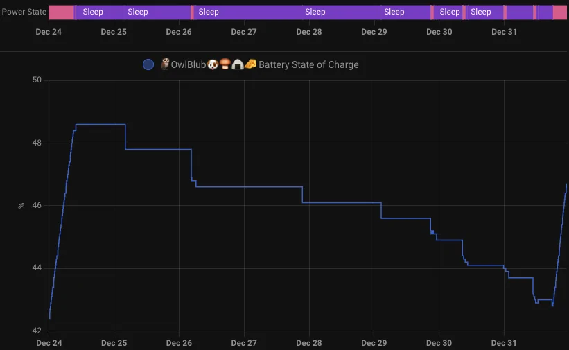

ElGuano
Oct 9, 2024
876
1,243
Cali
I have a full 7 days of data on 2024.47, car sleeping in the driveway while we were out of the country.
R1T Trimax
Not plugged into charger
Gear guard off
Minimal check-ins/remote wakes
Rivian R1T R1S Has your phantom vampire drain significantly improved with 2024.47.x software update? vIU5Mkt
Starting SOC Dec 24 9:58am: 48.6%
Ending SOC Dec 31, 9:58am (168 hours): 43.7%
Avg drain: 0.7% per day
Interestingly, the curve seems to steepen a few days in, not sure if I was checking in on it more towards the end. Looking at the power state records, there are a few more frequent 1hr4min wake cycles in the last couple of days. Why would the car be in ready state for over an hour at a time?
5,793
10,191
2022 Rivian R1T LE
R1T Trimax
Gear guard off
12v battery maintenance.
