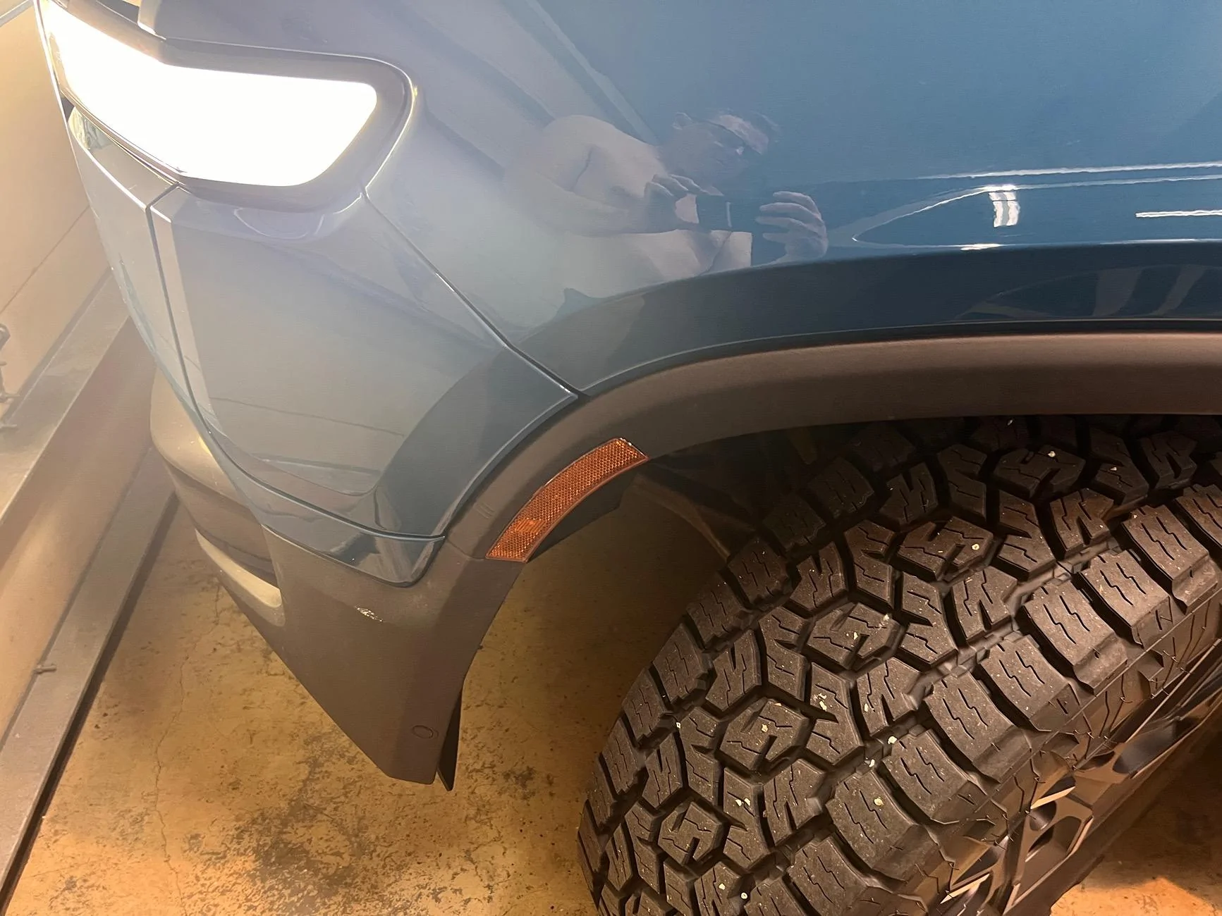

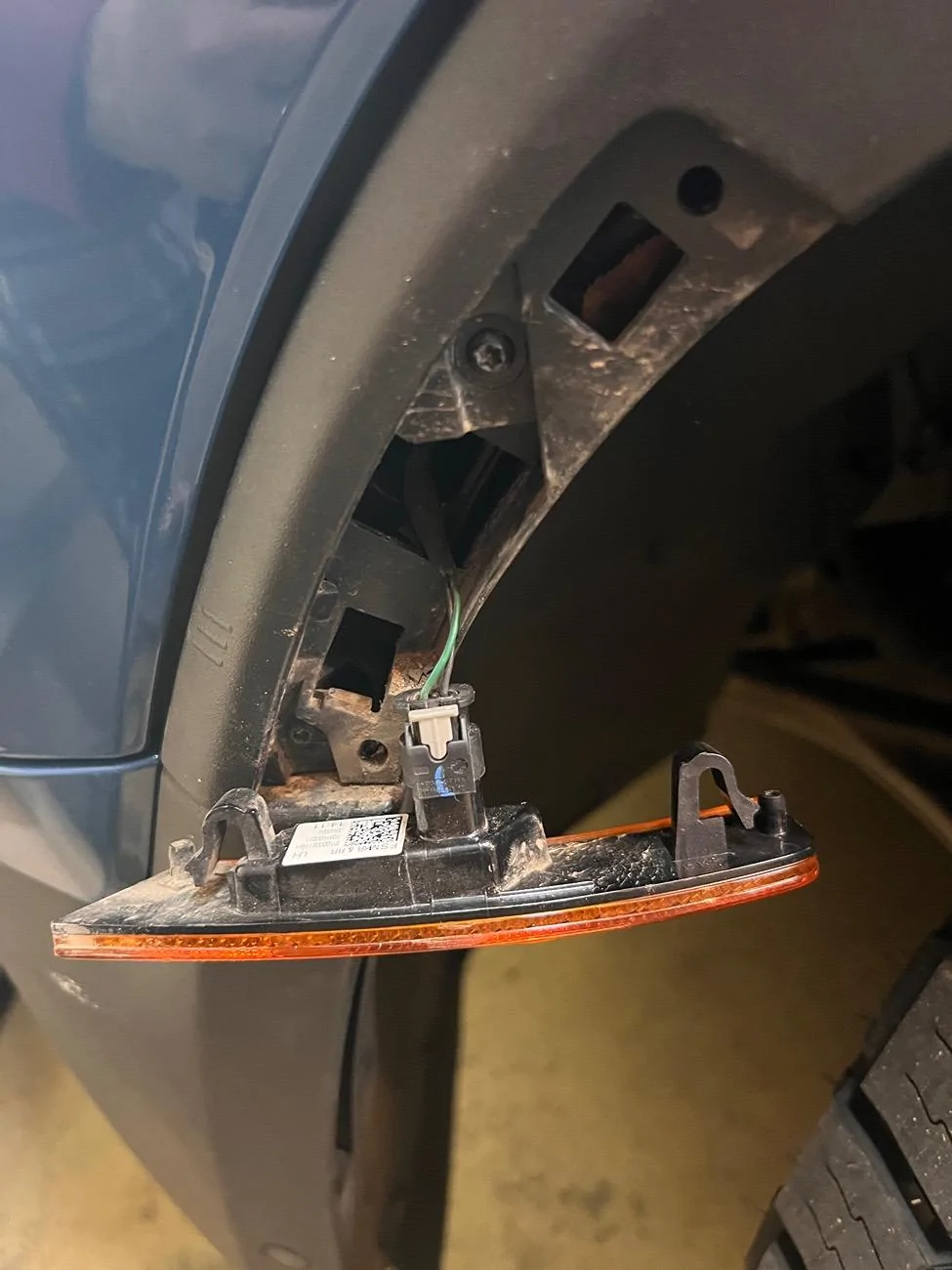

I'm going to use the amber marker light on the front wheel well as an ignition trigger. It doesn't come on when the truck wakes or unlocks. It first comes on when I press the break. The only time it doesn't look like it comes on is if you have the headlights/running lights/et al completely turned off (which I never do).
I was able to pop the light out with a trim tool. I plan to splice into the power line near the plug and then fish the trigger wire back up into the frunk area.
Great idea! Give us updates on how it goes and works! Assuming you’ll put a relay on the circuit to make sure not to overload?

The Switch Pro is essentially a relay. Main power for devices is straight off the 12v battery. The lead off the marker light connects to a trigger/sensor connection on the Switch Pro and the Switch Pro pulls a couple mA at most. I plan to throw a 1 Amp fuse on the trigger input just to be safe. Will post pics and some more details when I get it wired up.
