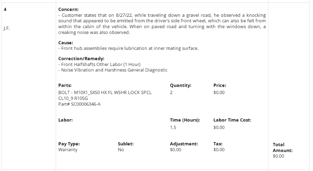

Mobile service came by and resolved the sharp "ticks" and creaks from the two front axles. I don't know exactly what they did (don't have the repair bill yet) but probably regreased, replaced, and retorqued the axle bolts.
Now those are gone I do still have a lower frequency quieter "tock/knock/clunk" but I am considering that to be normal unless it gets worse.

I brought mine in to my local SC about 3 weeks ago for this issue. They replaced both front axles which improved the knock significantly, but did not eliminate it completely.
They said the axles needed to be replaced, and also my front drive unit had a tolerance out of spec. They wanted to replace it and send the original back to Normal to be disassembled/inspected. The local tech said this was the second truck they heard this noise on, but mine was going to be the first they replace the front drive unit on from it. Had to wait for the new drive unit to be shipped from Normal.
It's in the shop right now getting the new front drive unit installed.
Perhaps Bosch didn't make these to the proper specification and there is too much play from something being out of tolerance inside the unit. Guess we'll find out over time.
I'm just happy that they are going out of their way to fix this properly. The Chelsea MA service center is top notch.

Just got the call that the truck is ready. I've yet to see/hear it but this is what SA wrote:
Rivian R1T R1S Low speed 'Tocking' when stopping or starting 1662737866301
PurpleTrain
Jun 10, 2022
45
Mine is nice and quiet now....
"Concern:- Customer states since the end of July 2022 there is a low speed clunking sound when steppingon the accelerator, sounds as if something is loose. Customer believes it is something dealingwith rear motors as noise isn't present when vehicle is in conserve mode.Cause:- clearance between splines on axle and hub. noise minimized.Correction/Remedy:- Front Halfshafts Other Labor (1 Hour)- Rear Halfshafts General Diagnostic- Rear Halfshafts Other Labor (1 Hour)Labor"
