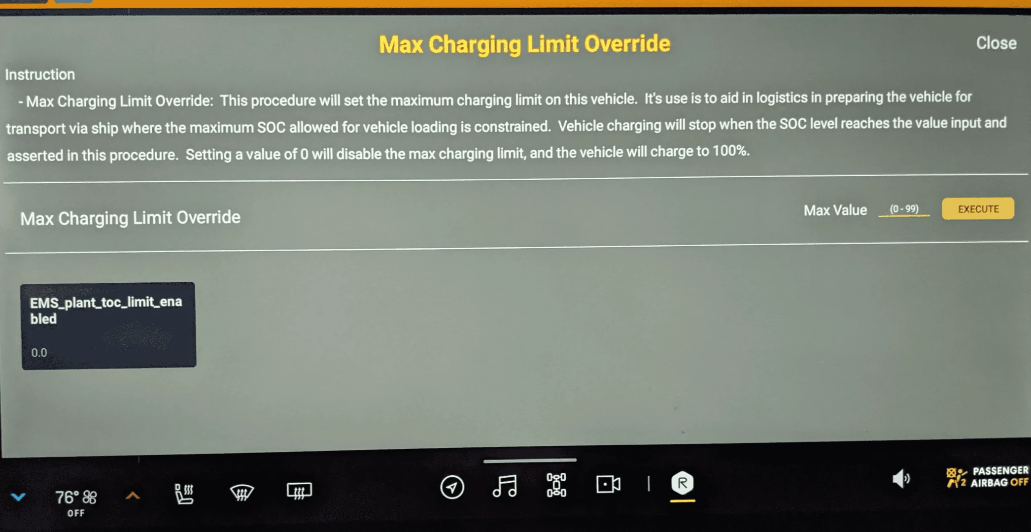

I was in the service menu and saw this... Anyone else seen it or know what it does? I think I just unlocked the constant 220kW charging! ⚡⚡⚡⚡

Probably refers to SOC charging limit but just a guess.

Well that's was a let down...
USDOT regulations state you cannot ship a gas/diesel vehicle with over 50% fuel. The regulations say nothing about EV SoC so the expectation is that batteries would not be charged over 50% during transit, just to keep the spirit of the regualtion.
I can also see this being good for fleet or rentals limiting them to ~90% to save battery life.

Well that was a let down...
I always wanted to check it out but was too chicken shit... I thought it would allow the charging curve to be temporarily less restricted, and allow a service center to DCFC at a more consistent rate than normal to ensure quick turnaround.
I wonder if this can be used to push the Standard to Standard+ limits? Like if it's the same code limiting Standard to 85% 👀. If a Standard user plugging in 99, maybe miles go beyond 270 and % goes 💥
Folks shipping to Hawaii have said things about what the shipping company requires.
