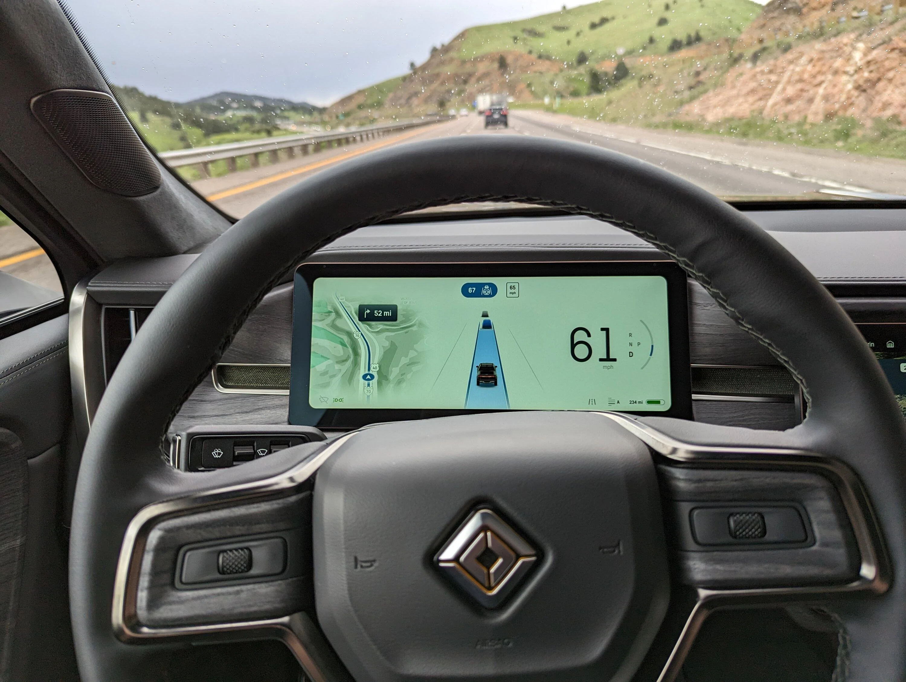

I've got an April build and I pull hard to the right. The below is straight for me. Glad to know they at least know what to do. I'm tempted to just get an alignment before going into the SC because driving into Brooklyn is a pain

That is brutal - I think most of us here have a really small (1-2 degrees) misalignment to the left. Yours is a totally different issue. Not sure how you drive like that...

haha the good thing is that it’s at my PPF guy until Friday because he’s backed up. I’m hoping with the severity it’s an alignment thing at which point I’ll take it to get alignment instead of heading back to the SC

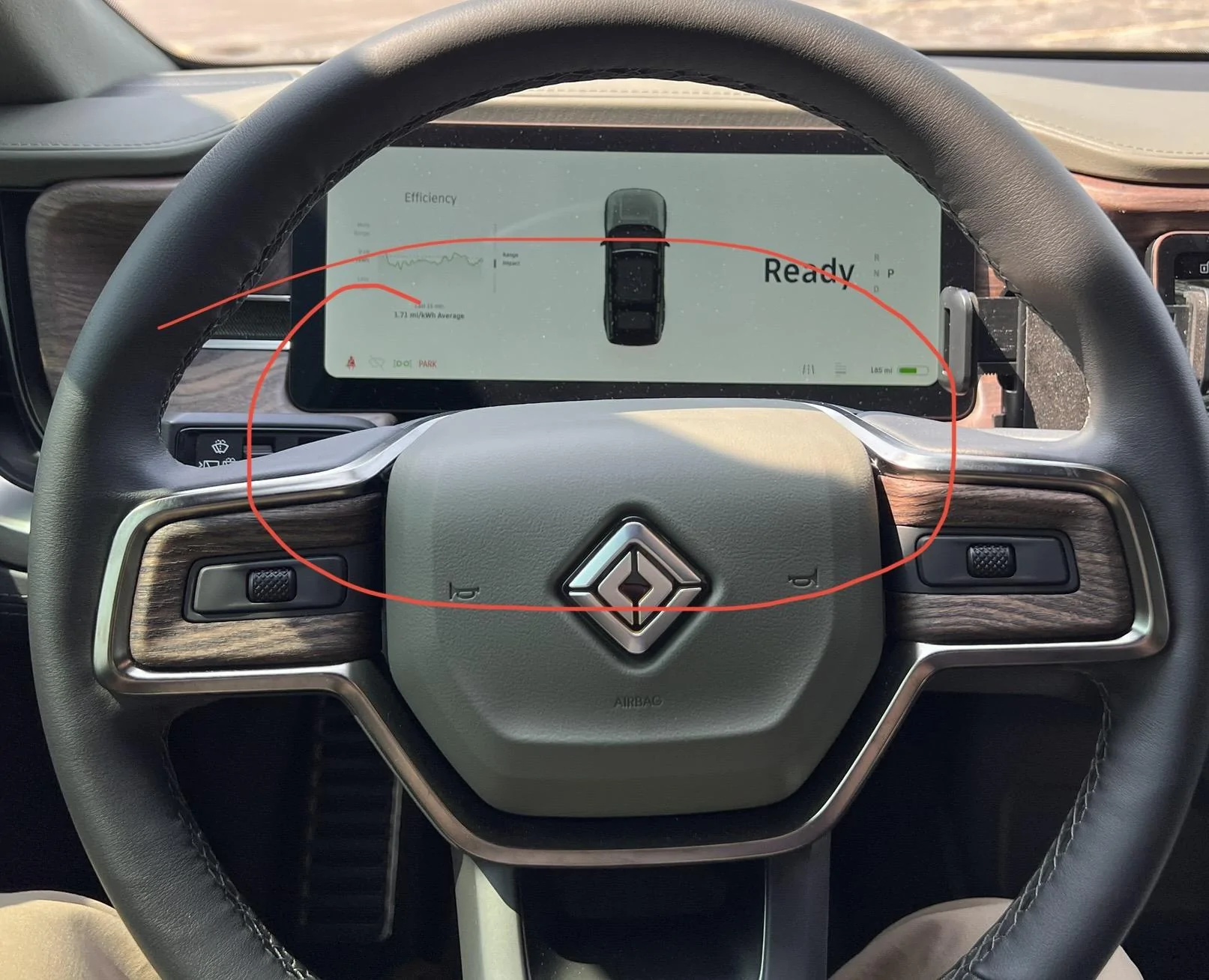

Like others, my steering wheel was off a couple degrees upon delivery (VIN 18xxx, Jan 2023 build / Feb 2023 delivery) and pulled to the right. Had a local motorsport shop who specialize in corner balancing, modified suspension alignments, track set ups, etc (as well as road cars) perform an alignment versus going to the SC for one. It was off for sure, although we didn’t have any factory specs to work with. Post alignment though, the steering wheel was straight and tracked straight.
cross post here
You have a very good point - maybe I just schedule an appointment with Discount Tire to make a wheel alignment. They are partnering with Rivian, so they should have the specs (I hope).
I have the same misalignment of the steering wheel as in your picture, and also a bit of pulling to the right. It is probably a problem with factory machine calibration.

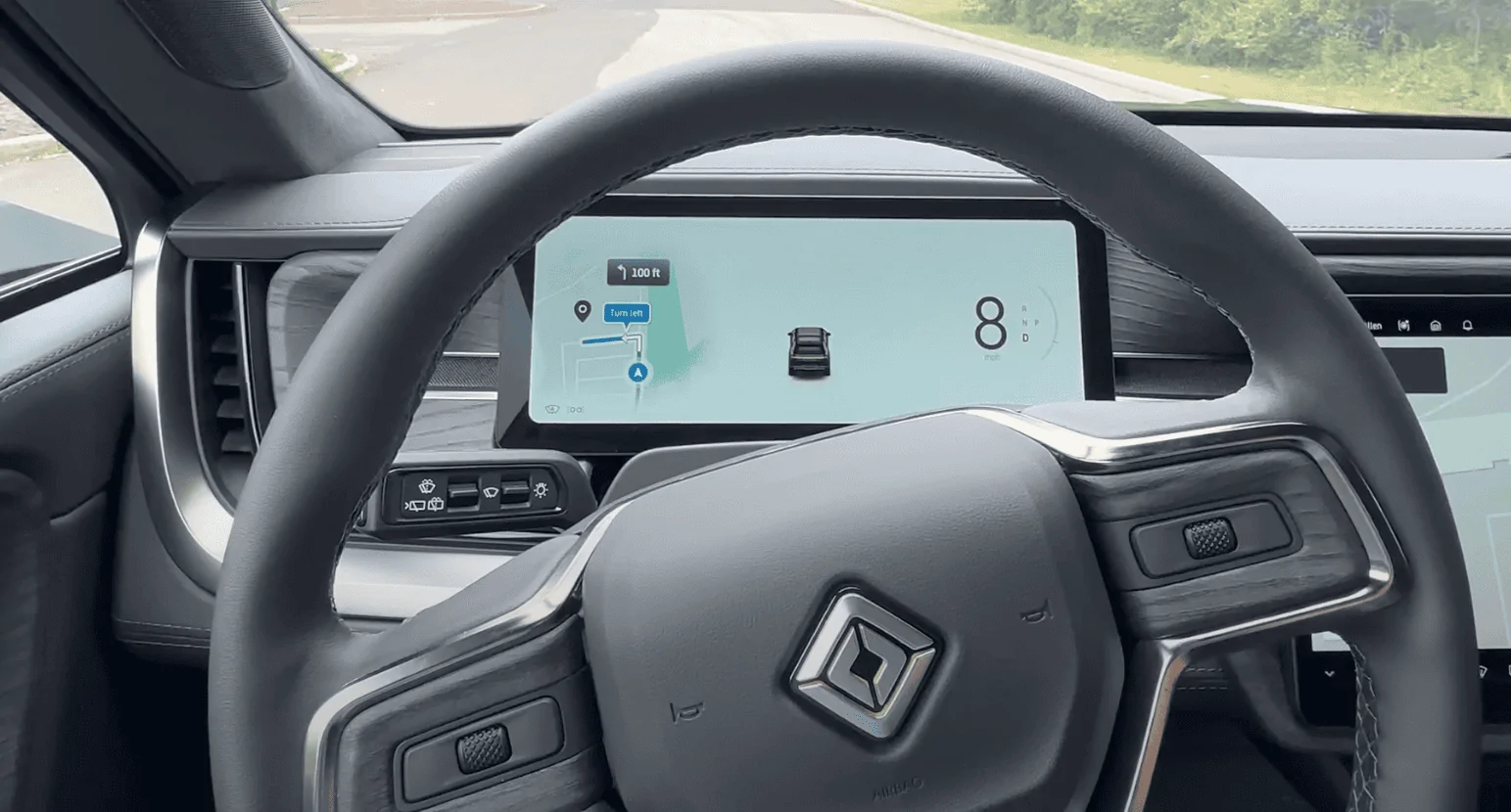

Took delivery of a March build R1S last month and yes it has the same issue. Car is currently in the Chicago SC now also to fix some misaligned panels. Was told it’s gonna take a while because they have 80 cars on schedule and only 3 technicians working.

I have exactly the same misalignment. And all other r1t's I saw. So it seems a factory issue. As it is not radical misalignment , most people probably just not reporting it.
