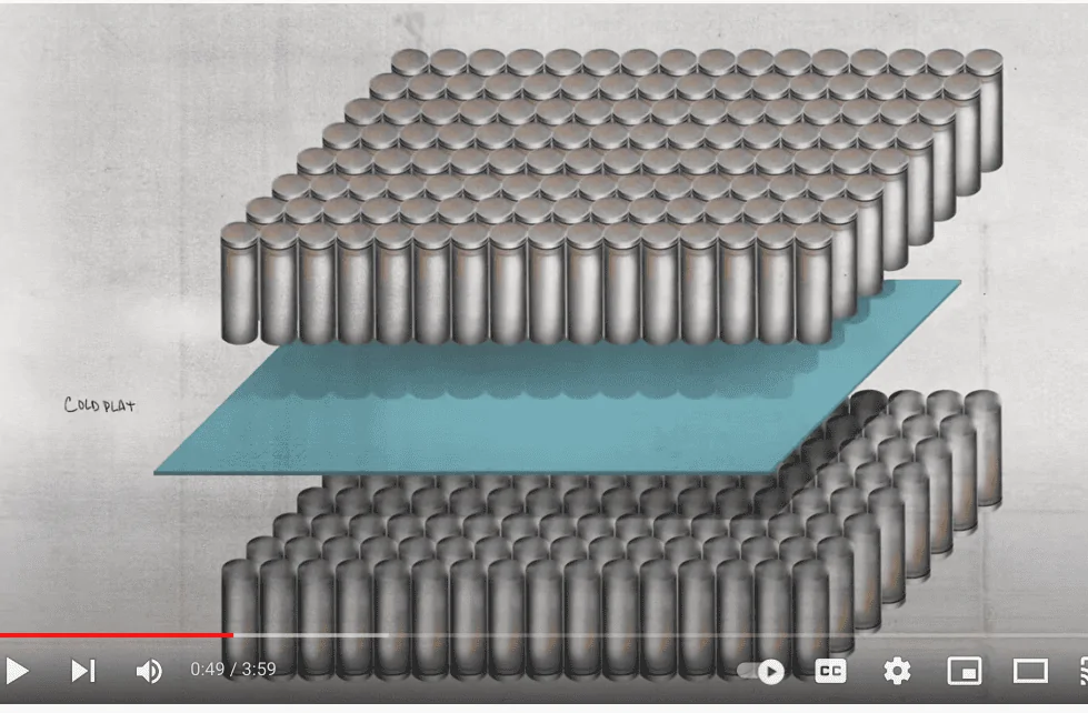

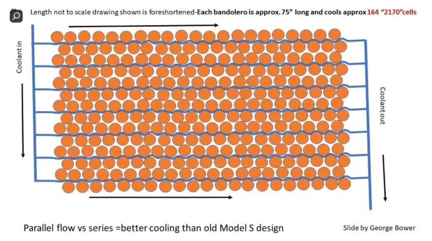

The R1 battery is massive in comparison to most at 135 kWh. Charging at 150 kW sustained is only 1.1C and should be totally reasonable. I'm starting to get a bit concerned they have a thermal problem.
I think this is likely to be the case. From this video Rivian published, they appear to have much less cooling on the battery than Tesla.
Rivian: cooling plate only touches the cells on 1 short end.
https://www.youtube .com/watch?v=sdaUnjn1Da0
Rivian R1T R1S My R1T Charging Session Data - From 25% SOC to 85% 1647442507807
Tesla: Cooling plate snakes it's way around touching each battery on the long end. Much more contact with coolant.
https://insideevs.com/news/338711/tesla-model-3-battery-cooling-much-improved-track-mode/
Rivian R1T R1S My R1T Charging Session Data - From 25% SOC to 85% 1647443046871
r1t_kev
Jan 2, 2022
236
748
PA, USA
Subaru Crosstrek
Watch this video if you haven't already. Lucid uses the end cooling method and Peter explains why it's better than side cooling in general. Also a lot more interesting bits, but this point was one that struck me.
