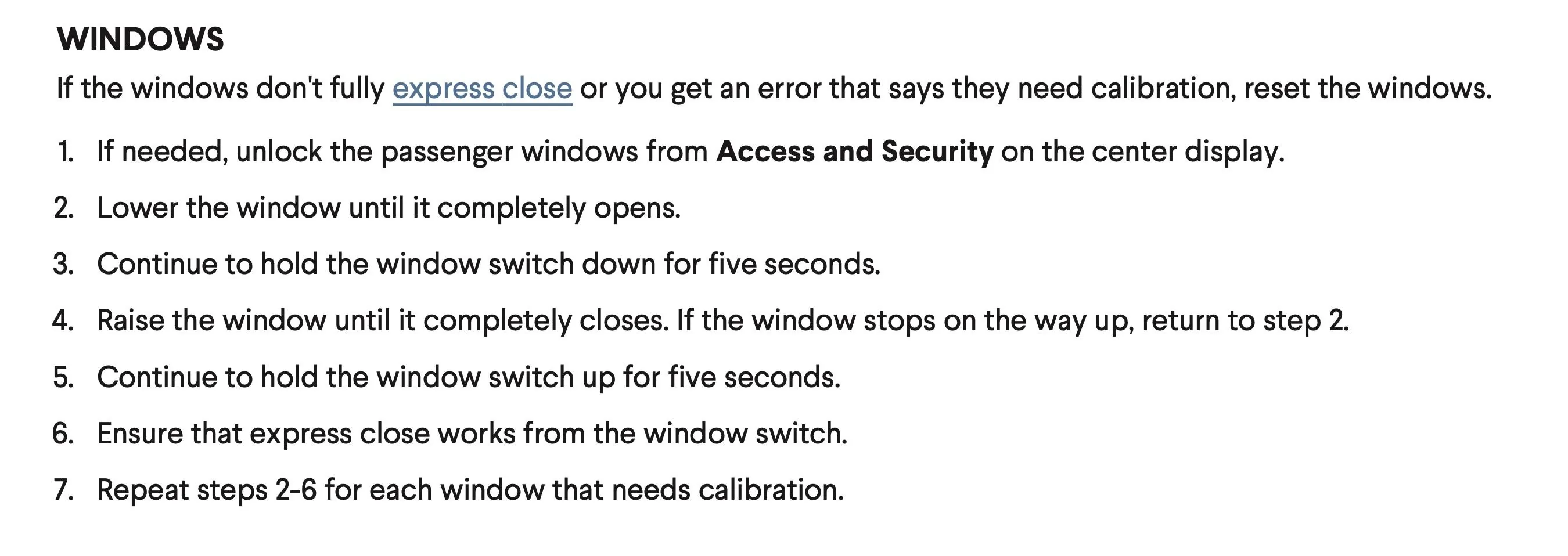

Sounds like you need to recalibrate the windows. Check the manual.

Can you give me a pointer; I can't find "calibrate" anywhere in the manual.

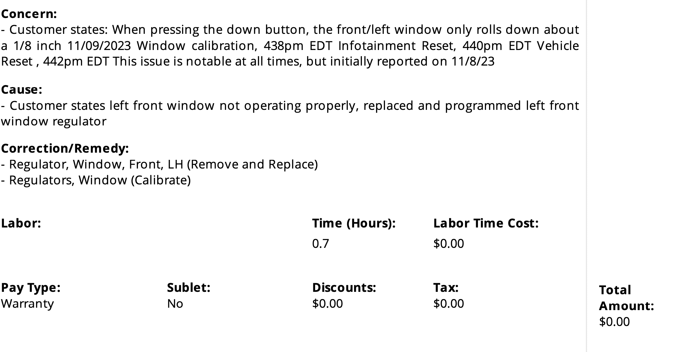

I had this exact same issue with the same window. I could hear it try to roll down, but it only moved an 1/8" or so and the app showed the window as being open. Soft reset, hard reset, calibration didn't help. Ultimately it required a service visit to replace the Regulator. Here's a screenshot of the invoice. Edited to add that the service visit was quick and painless. In and out in about an hour.

Thanks @VSG & @COdogman; I had an old manual downloaded, now have the new one. @Riv_Goat thanks, I'll probably end up there but will try the calibrate first. Although I don't see how it can calibrate if it won't go down at all...

Most window issues are one of these:
1. Faulty switch (no noise)
2. Broken motor - electrical (no noise)
3. Broken gear on motor - mechanical (grinding noise)
4. Broken window regulator - mechanical (the pulleys and cables that convert the motor rotation to the up/down motion of the window)
Replacing each is straightforward (on old Audis, Jeeps, Mazdas, and Crown Vic’s - been there , done that). But getting the door off can be the hardest part - especially with single use clips.
Easiest thing to do is hold the switch up for 5 seconds. That tells the truck “roll up the window” for the first 4 or so seconds and reset the up position at the 5th second.
Do the same in the down direction next.
For fun, try resetting the up position afterwards. The order should not matter once both up and down resets are performed.
If it doesn’t work after that, Rivian needs to fix it.
Edit: don’t let the window issue get you down. It is an easy fix. Think of it as getting a better/newer window switch, regulator, motor for that window. The other windows will be jealous.

@Glembi2 Thanks. I guess my other windows will be jealous; the up-down-up seesaw was met by silence.
