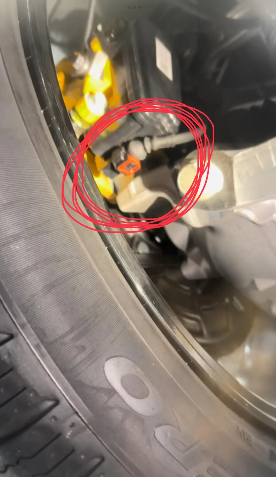

I have my R1S with the wrap guy to do a bunch of stuff and after the second day with the car at the shop I get a call that says “so, in order to paint the calipers we unhooked the rear brake control briefly and even after hooking it back up the car won’t go back into park. It’s stuck in neutral.“ (see pic attached)
Rivian R1T R1S Painting Calipers + Rear Brake Release IMG_0378
Bummer.
Rivian Mobile tech gets called out to the shop and after some time, explains that the electronic rear brake controls throw an error whenever they’re unplugged for a period of time, and the only way to avoid this is a tool that overrides the sensors and tells them that everything is a-okay. However, according to the mobile tech, they don’t sell that part to the public. Luckily, he was able to do something to fix the car and get it back to normal (SSOC told me later it was a 12V reset?).
At this point my options are:
  1. Just go ahead and unplug the brake sensors, paint the calipers, hook it back up, and call the mobile tech out again. We’ve called SSOC and our local service center four times and no one will tell us if A) this voids the warranty B) this would even be possible to fix C) what the cost of the fix/reset might be
  2. Buy this Electronic Brake Release Kit part, which no one at Rivian will confirm if it is the right tool. Hope it works and then sell it on eBay. I called the RivianServiceTools.com line and they’re glad to sell it to me but have no idea if it will serve my purpose or not.
Feeling a bit lost - does anyone have experience with this? Has no one else painted their calipers or taken their brakes off? This seems like a pretty normal modification.
Thanks!

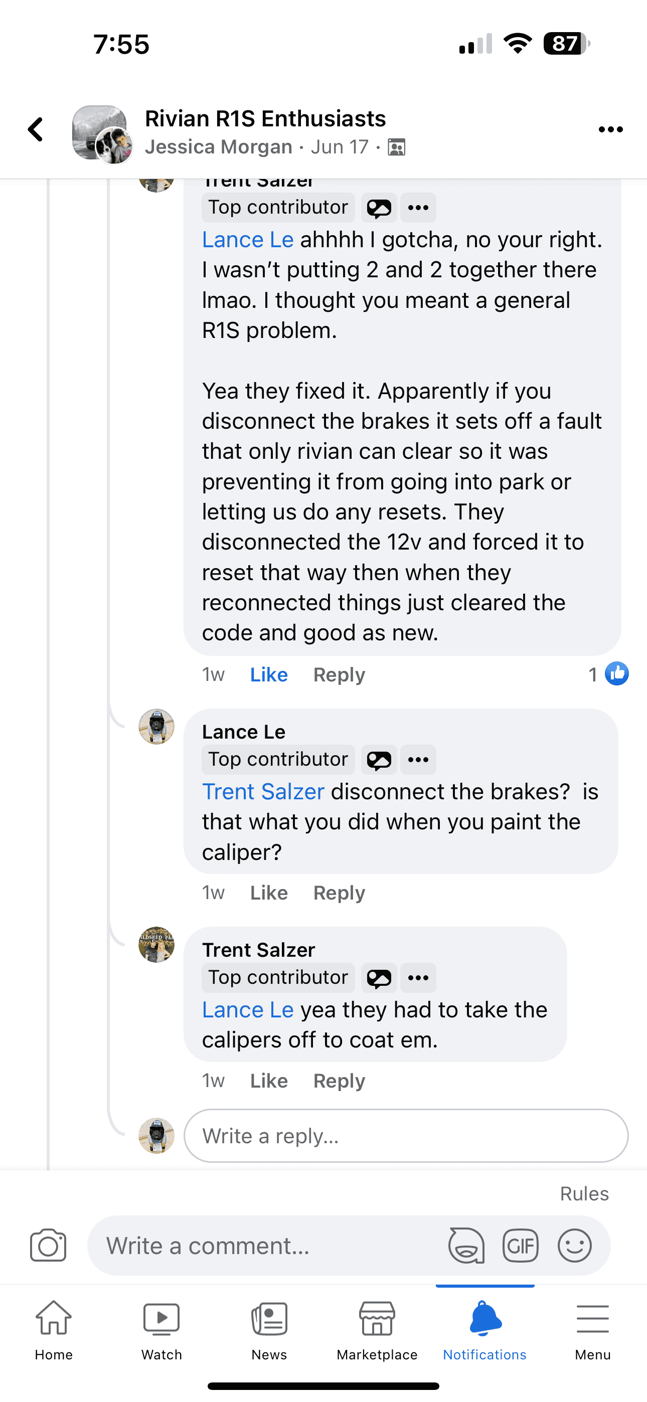

A member on Facebook forum did the samething as you did. Read the reply
Rivian R1T R1S Painting Calipers + Rear Brake Release IMG_2022
