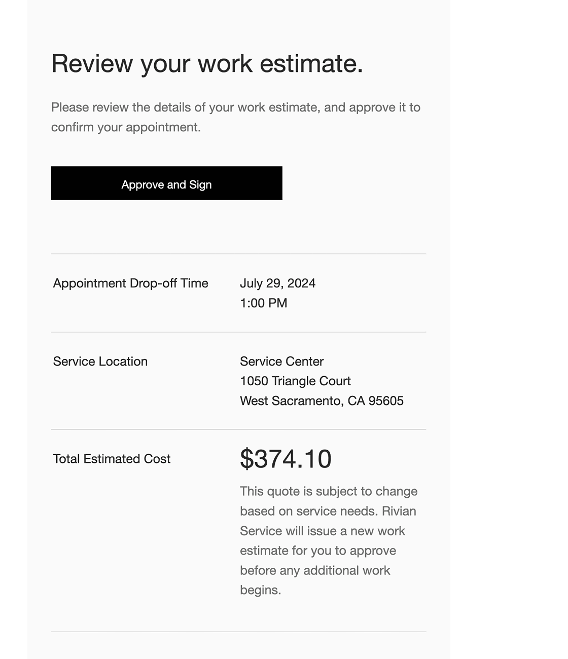

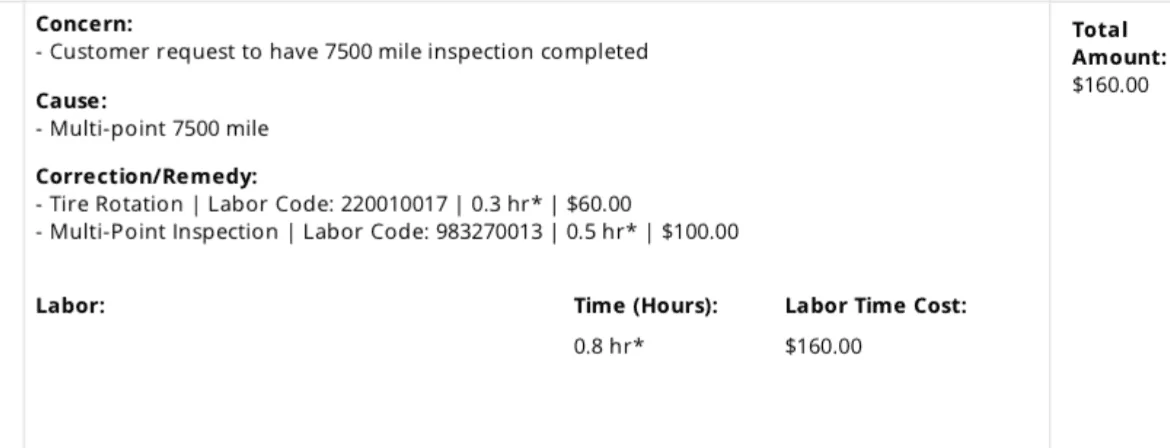

I scheduled my 7,500 mile service and they told me $160 including tire rotation. Then I got this notification to "approve and sign" an estimate with ABSOLUTELY NO DETAIL for $374.10. I called and they something about wiper blades and a cabin filter. Ford and Audi pulled this kind of crap - I thought better of Rivian.
I shall drill deeper to warn others.
