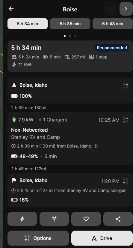

As a general point, not every public charger (DC or L2) that you can use is included in Rivian's route planner or ABRP. For example, there's a level 2 site at Southfork Lodge on the road up to Stanley on PlugShare that's not on Rivian's map and is well-reviewed; just be sure you have a J1772 to NACS adapter with you. It's not going to save you total charging time but it does give you options to do things at different locations for less time at each one.
And while I know this is an illustrative example, I plugged the round trip into ABRP and starting from 100% on Boise and allowing a 10% buffer on return, and using a 2.9 mi/kWh reference consumption at 65 mph it estimated that you'd arrive at 40–43% depending on whether you picked the northern or southern route and need to charge for just over an hour at the RV park to get back. Even if it's off a little, 2 hours at the RV park would do it—or an hour at Southfork Lodge and then an hour at the RV park or Redfish Lake Lodge.

Thanks. I have used a few sites to find potential charging stops but I don't think I've used that one. That drive is very nice, hot springs in the area and plenty of hiking. I'm still planning on getting the R2 as I explore my options.

Even ABRP thinks you could make it charging for like 5 mins on one of the slow chargers:
5 minutes of charge, 1% gained. That's a little funny.
ABRP may not be accurate until more R2 miles get added if Rivian is using their 330 miles range data, then factor in some battery loss and I'll want to charge higher than it estimates until I get comfortable with it.
Looking at the area there might be a small selection of lvl 2 chargers, even if that means renting a camp site for the night while we charge and hike.

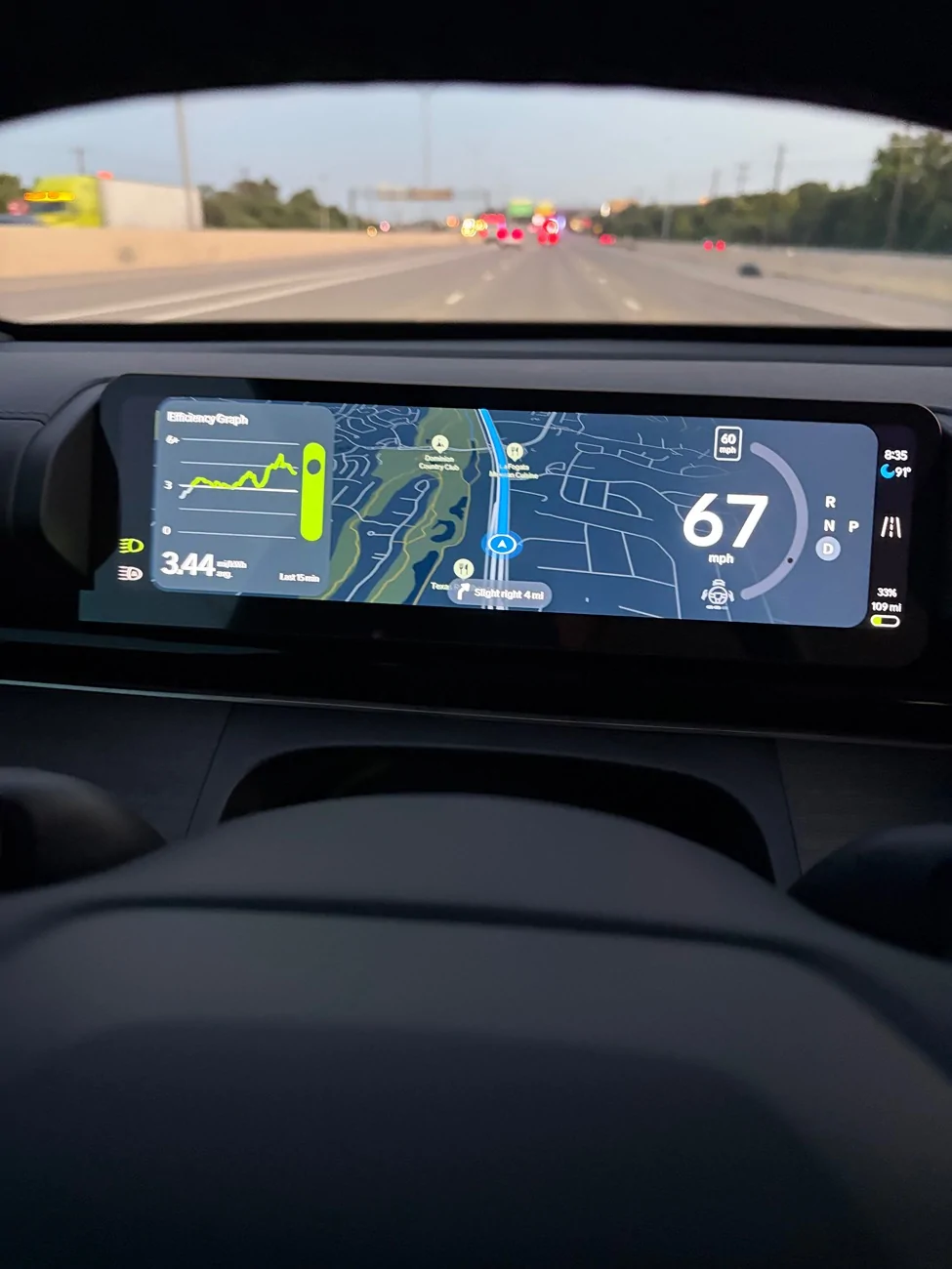

Ok, so I drove from San Antonio to Fredericksburg west on I-10. This is a hilly stretch with some flat areas for 45 miles. I used UHF and set to 72 actually, temp was 95° A few vehicles ahead of me but not drafting. (Says 67 mph for a second while wife took the pic and I turned off UHF before exiting). No worries about range. 😎
109 / .33 = 330.303
No worries about range 👍
