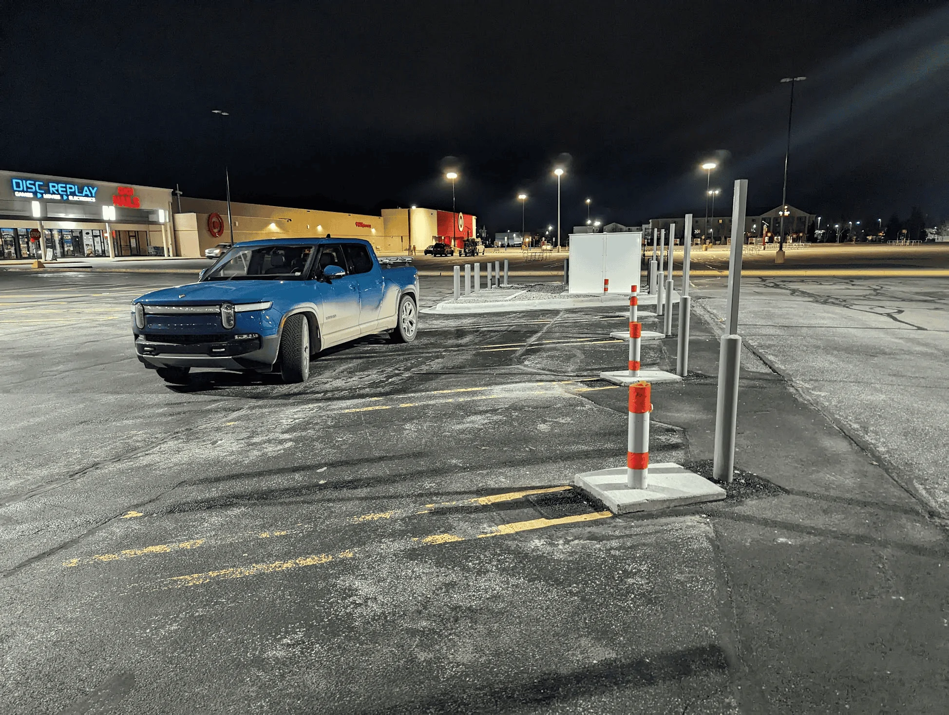

Any updates on the Shasta City RAN?
I will be up in that area in a few weeks but haven’t seen a potential address posted. Will look around though for any signs of it.
I believe it's in the Best Western Plus Tree House parking lot just off I5 Exit 738 West Lake St.
Heading thru there on the 7th. Hasn't been added to PlugShare yet.

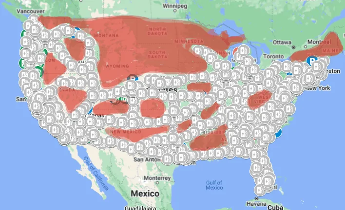

Thanks for the detail - and pointing out the EA portion of the map.
Hopefully Rivian(or someone else) will fill in the red areas. Looks like there may be a some RAN locations near the edges of the dead-zones, but it does not look like they have made much progress on closing any of the big gaps.
Rivian R1T R1S RAN Rivian Charging Stations Locations Map via Google Maps Screenshot 2023-06-28 2.10.21 PM
EA has added some chargers in that red zone around MT and the Dakotas and more coming soon. I am planning a trip through there this summer Oregon to Wisconsin so I have been watching closely.
Based on the Southeast, at least, that scale is extremely misleading and makes the gaps in EA seem not so bad, but keep in mind those are all 4-charger locations in the SE, and they're often pretty far apart, which can create very real problems if a station is down or full. You often wouldn't be able to just skip over a station to the next one without having a much higher SOC planned out when departing each stop. The good news is that access to superchargers will help quite a lot on interstates and major routes at least. I hope that means Rivian will prioritize things a little differently but still plan to build something close to their original layout so there are reliable non-Tesla options.

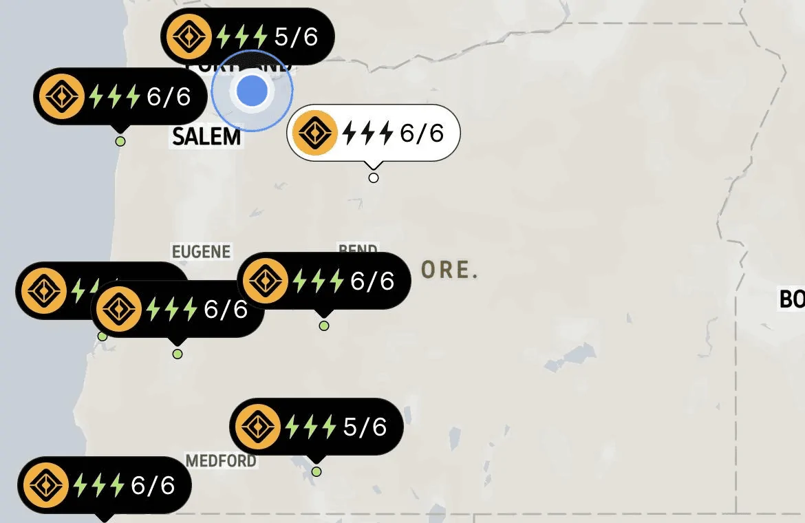

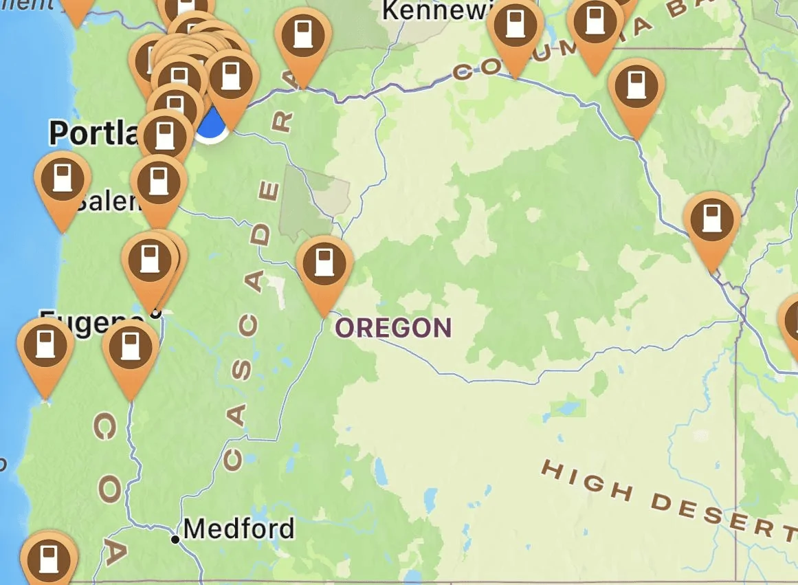

Is this map able to tell us if Rivian making any attempt to enable EV adventuring in areas that you couldn't before?
Are any of Rivian's chargers more than 50 miles away from competing chargers? Or are all of them placed in areas that are already served by equivalent chargers operated by other providers?
Oregon got a bunch of RAN early - almost all in corridors badly served by competitors. Once you leave the Interstate-5 corridor to Central/Eastern Oregon, or Interstate-84 skirting along the Norther edge, there was only one >50kW station - a 4-stall EA in the biggest city in Central Oregon.
Rivian added three stations to that part of the state, making highway US-97 drivable from Washington to California.
Here's what >50kW CCS looks like for non-Rivian vehicles:
Rivian R1T R1S RAN Rivian Charging Stations Locations Map via Google Maps 1687987003504
Here's RAN:
Rivian R1T R1S RAN Rivian Charging Stations Locations Map via Google Maps 1687987149355
The three down the center of the state, three on the coast, plus, two along I-5. Those coastal stations add a lot more >50kW plugs to US-101 along the coast (one of the EA on the coast just opened up last week, with another having half of its stalls broken for months.) More than doubling the number of total >50kW stalls on the coast between Washington and the Redwoods in California. (The station at the bottom is a couple miles into California.)

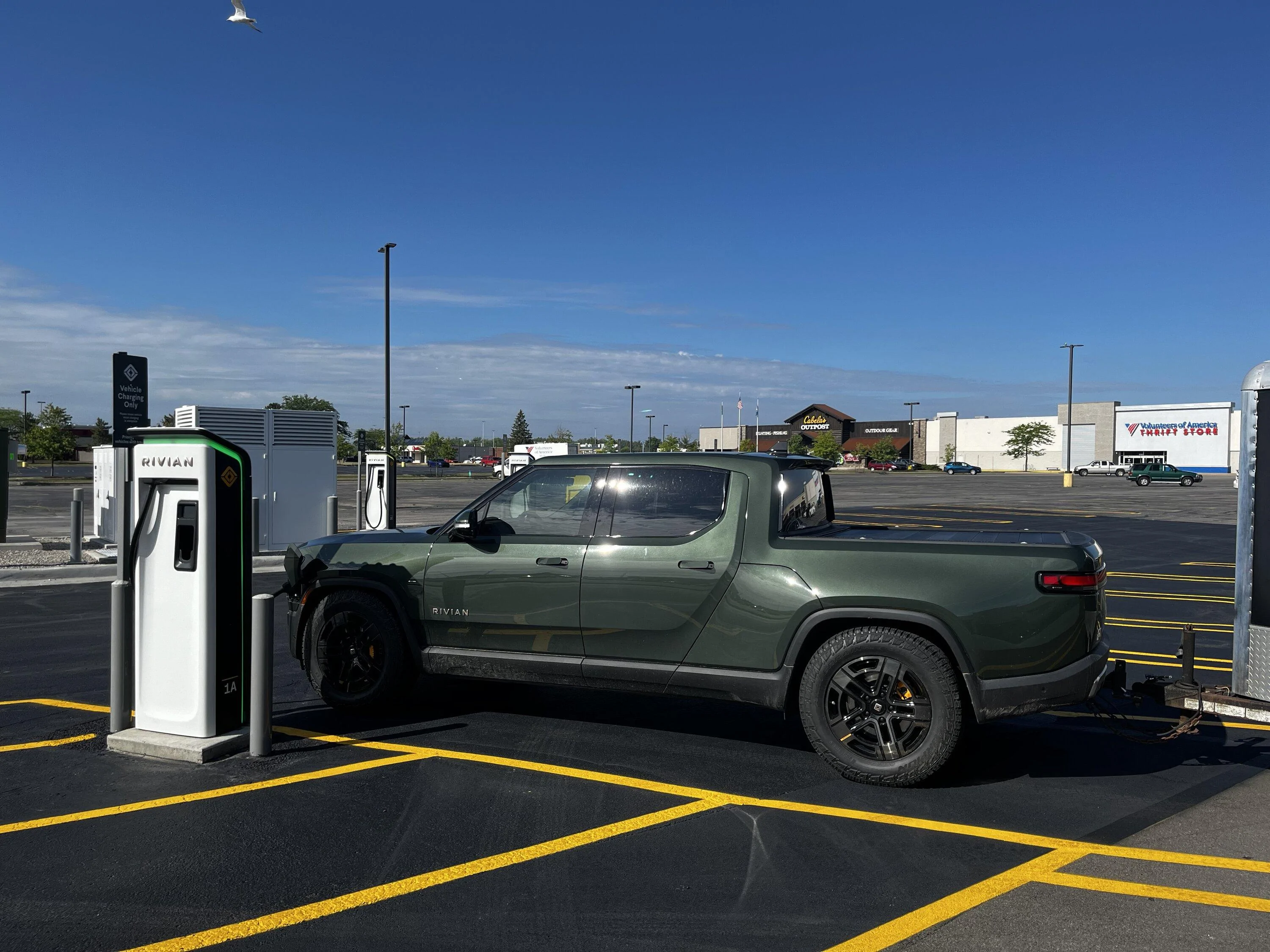

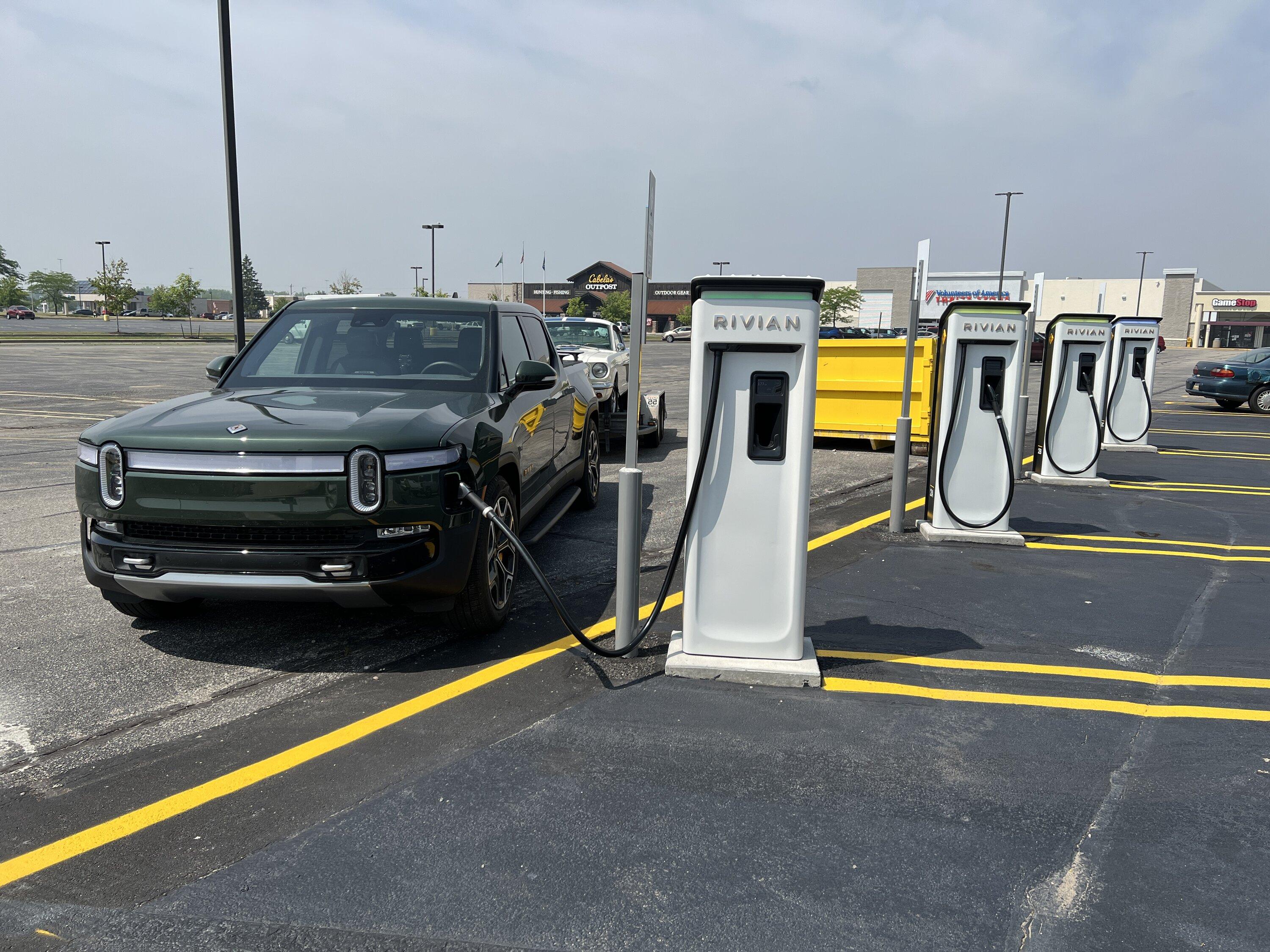

The Saginaw, MI location is now online and working great. Location is also showing up in the truck, Rivian app, and ABRP.
I used this station today while towing a car trailer north. The pull-through stall in your picture was ICEd so I had to use one of the others from the far side - and that was almost blocked by the placement of a big yellow dumpster there...
Rivian R1T R1S RAN Rivian Charging Stations Locations Map via Google Maps 20230628_153452210_iOS
