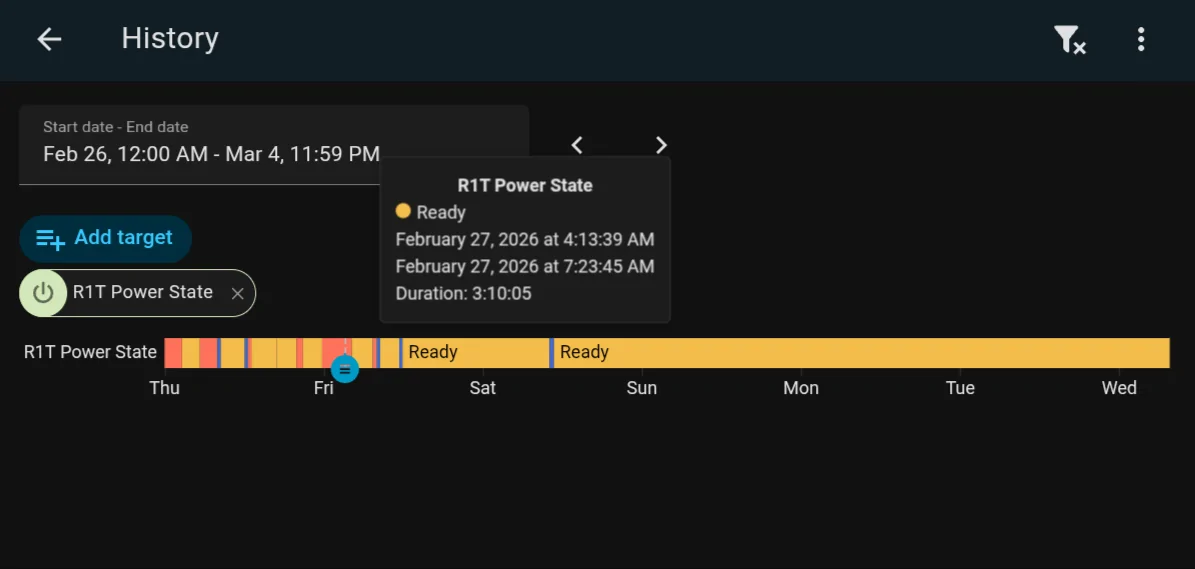

The truck hasn't been sleeping much, at all.
If you charge them with trickle chargers frequently, it'll probably start sleeping more, due to improved health of the batteries.

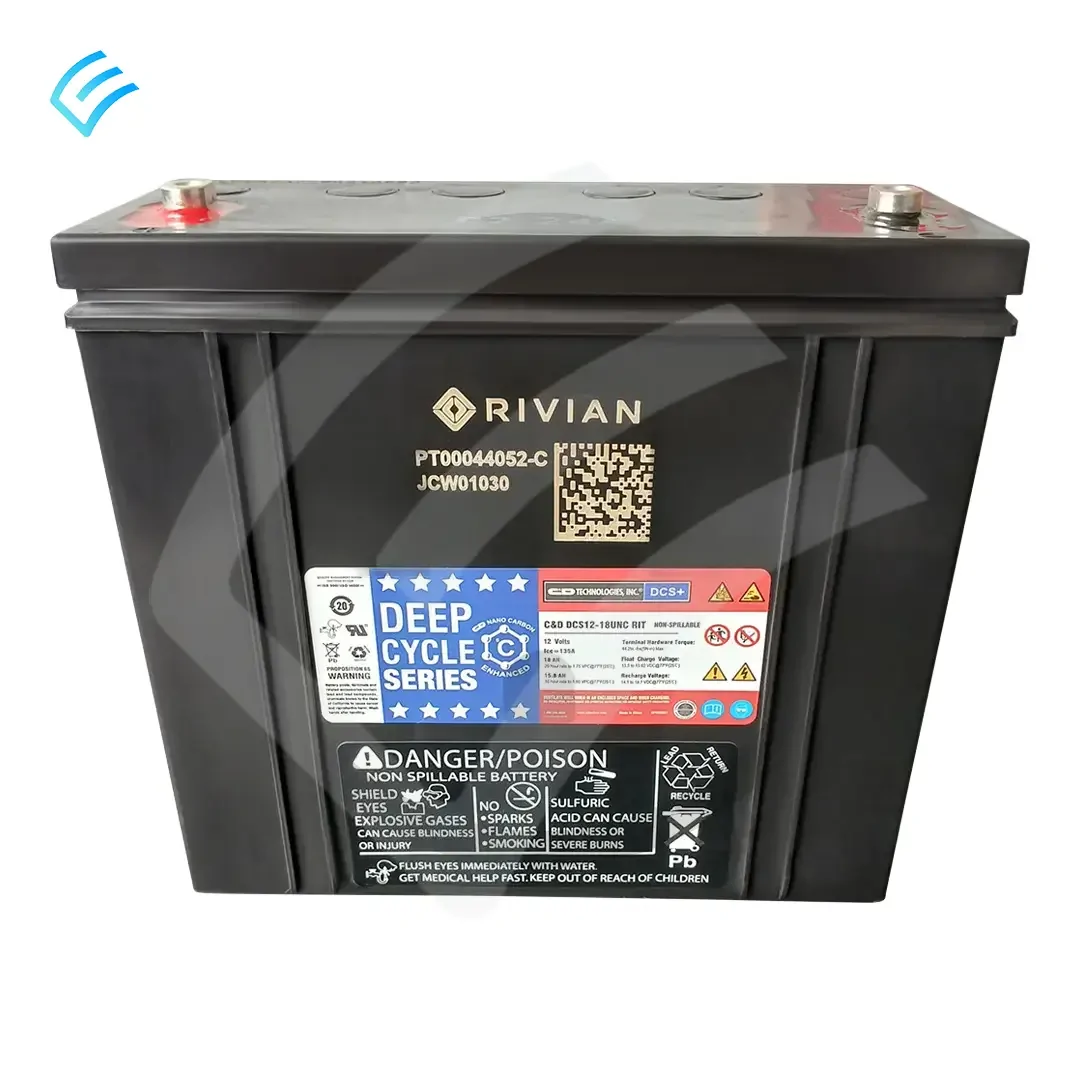

The part # on the work order reads "PT00044052-C" which a google search got me this

Yeah, that's Lead Acid for sure. Sulfuric Acid & Pb (Lead) right on the label.
