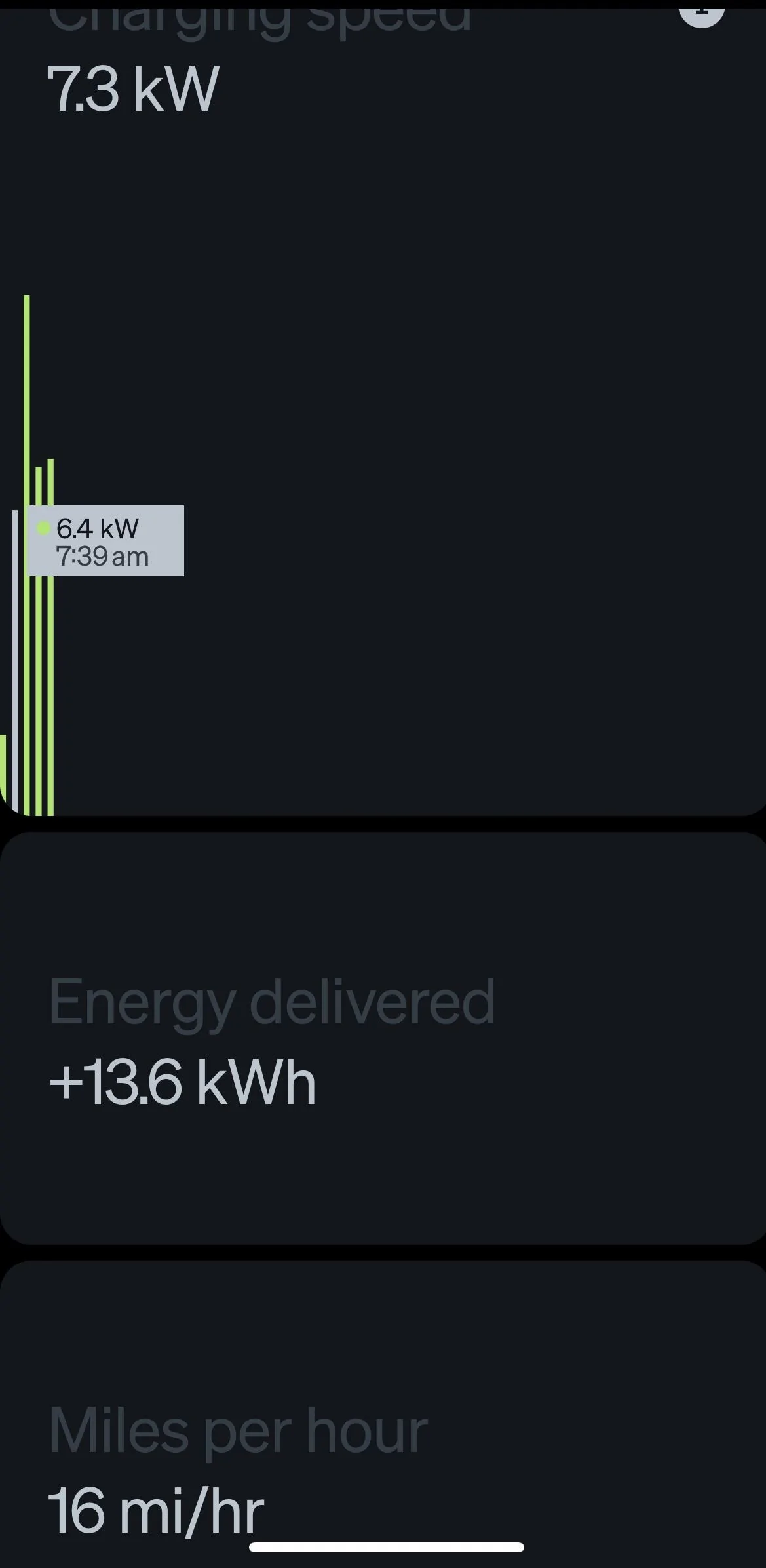

Joining in the misery here. Have a long trip planned for later today and my gen 2 max-pack R1S will pull down 6.9kW from a 48A charger that has no problem delivering 11.5kW. The R1S pulls full power fine normally when I charge to its usual 70% limit, but I boosted it to 100% this morning due to the long drive and it seems to have slowed down right around 80% charge. Pretty frustrating, won’t hit 100% in time, but should have enough charge to reach my destination - just won’t have as much as a buffer.
When I was messing around with it earlier this morning, I could get the car to pull full power if I turned the climate on - so it’s clearly the vehicle and not the EVSE (Gen 3 Tesla HPWC).

Sometime around the latest vehicle update to 2023.50.01 the charger started acting screwy. It will charge for the first hour at max speed (10.9 kw/h) and at the end of that hour drops to 6.9 kw/hr and stays there, regardless of state of charge. If you unplug and replug it starts the clock over, works for an hour and then drops. We have a different level II charger that chargers at about 9 kw/hr and will charge at that level consistently to the desired max charge rate.
I have reset the breakers for the charger. Performed a hard reset on the vehicle. The problems persists. Rivian chat support sent my problem to their “charging team” two weeks ago and only crickets in response. Anyone else having this problem?

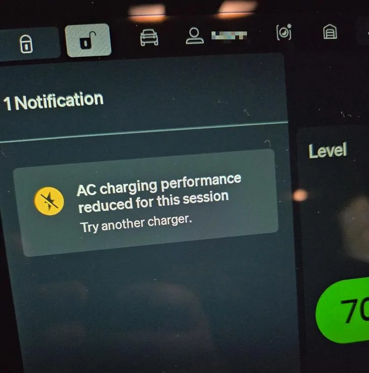

Hopping on to say I'm seeing this behavior as well. I've been using a Grizzl-e Classic charger for almost a year with zero issues. Went to my 2022 R1T this afternoon to setup a new PaaK and noticed the charging error/information.
Gen1 R1T with 4xxx VIN. 12v's replaced about a month and a half ago.
Rivian R1T R1S Rivian Wall Charger Keeps Dropping to reduced level charging-notic

Just had an overheat with 38 Amps and it's 70F outside and shaded.
WTF happened to the last update?
