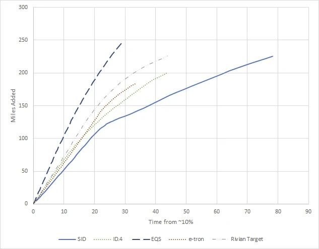

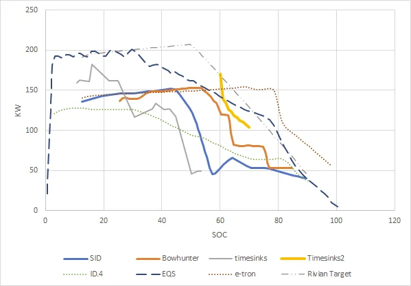

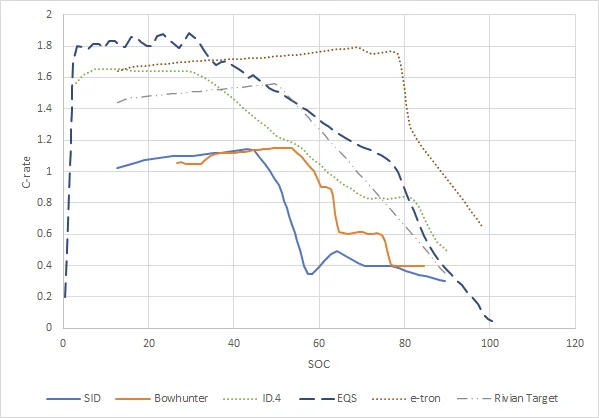

Thanks to a few folks who've posted charging curves with their R1T, I thought I'd go through and plot them up against some other 400v class vehicles for a frame of reference. So far from what I've seen, the R1T charging performance up to about 50% seems pretty good and is limited by architecture. However, between 50% and 80% state of charge, the R1T seems to currently have the most conservative charging curve I can recall.
I've plotted up the curves from three R1Ts. I'm still a little suspicious of the curve that @timesinks had initially, so I'm not retaining it beyond the first plot showing power vs state of charge. I added @fastwheels data on the first plot as well, but with a guesstimate at the power at 80%.
I've also included a simulated curve showing what I'd consider to be pretty reasonable for the large pack given the battery size. That's the "Rivian Target" curve. As a total coincidence, this curve seems to provide a pretty good match to a couple of the better curves I have heard of from employees. However, I haven't actually seen proof of that.
Because the vast majority of people seem to be getting the 20" ATs, I'm doing mileage calculations based on 293 miles, which seems to generally be what the GOM calculates in conserve mode for folks at a full SOC.
It's worth noting that I believe both of the curves from SID and Bowhunter are on 350kw chargers that seem to be limited to about 375 amps. It looks like it'd probably save about 5 minutes from 10 to 55%+ to charge on a 150kw charger that can provide 175kw than a 350kw charger that's limited to 375 amps. The very start of the timesinks 150 curve is a good example of this. Regardless of what appears to be a very conservative curve, it is really being limited by the 400v architecture.
One other piece of context that I personally find a little interesting is that with the upcoming update to the ID.4 charging curve, the even the "target" curve I've created for the R1T would not be any faster at road tripping than the ID.4.
Currently looks like around 50 minutes around 50 minute to an hour for a 10 to 80% charge if the curves we are seeing continue to be good reference curves.
I'm coming around to the theory that the curves are being limited by a conservative thermal limit that Rivian has set given the shape of the curves, the very sharp drop in charging speeds, and that they are not following a similar consistent backbone curve despite all of them except maybe Timesink's first curve hitting the limits of the charger to start.
We should also be getting a pretty good set of curves from @OutofSpecKyle shortly. And as a reminder, he was able to get clarification that the launch edition vehicles do not have hardware capability for the 800v switch.
Oh, and towing for any distance more than about 75 miles will really suck with the curves we're seeing. Without changes to the curve, the max pack isn't going to help that much either.
