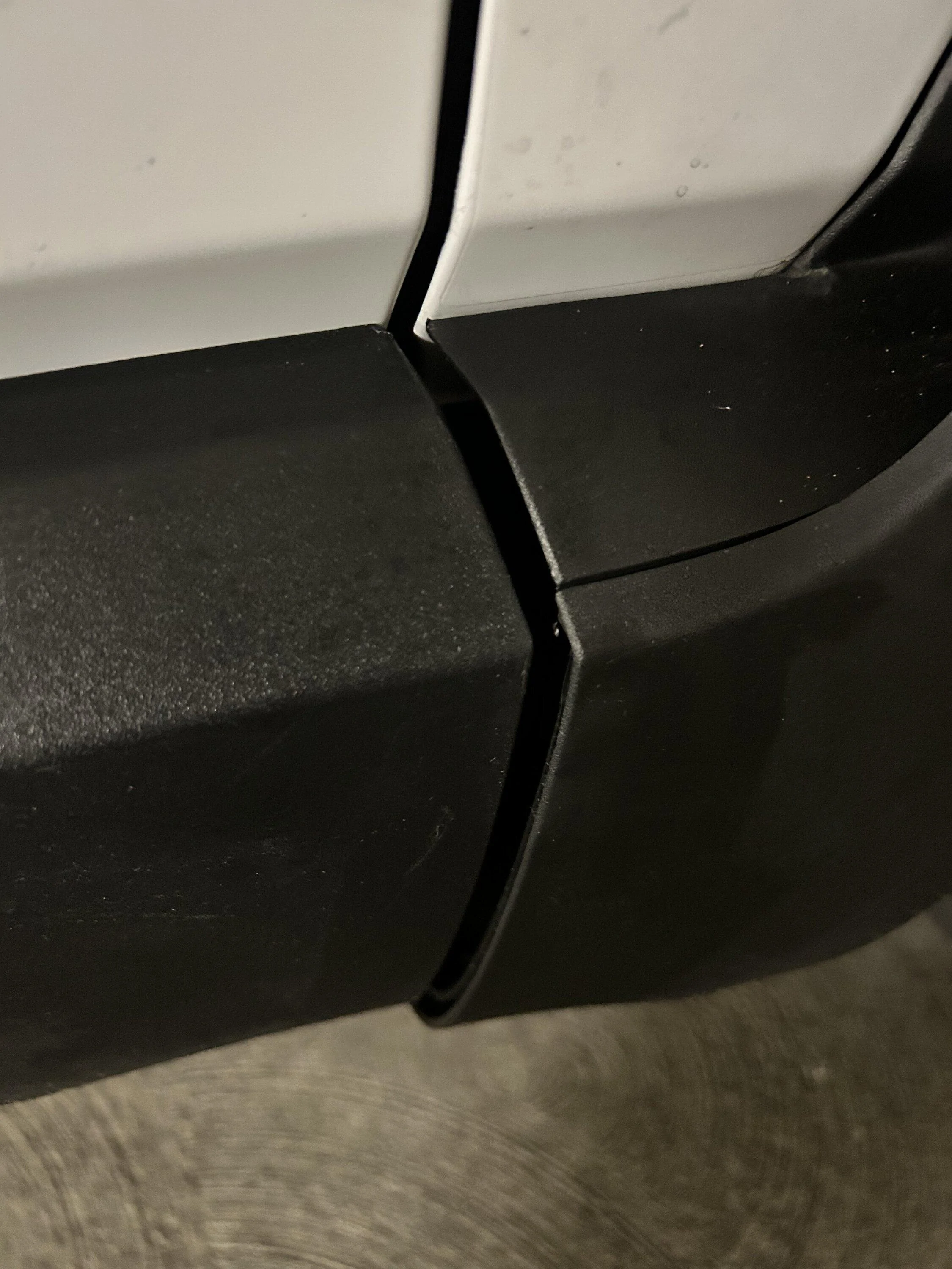

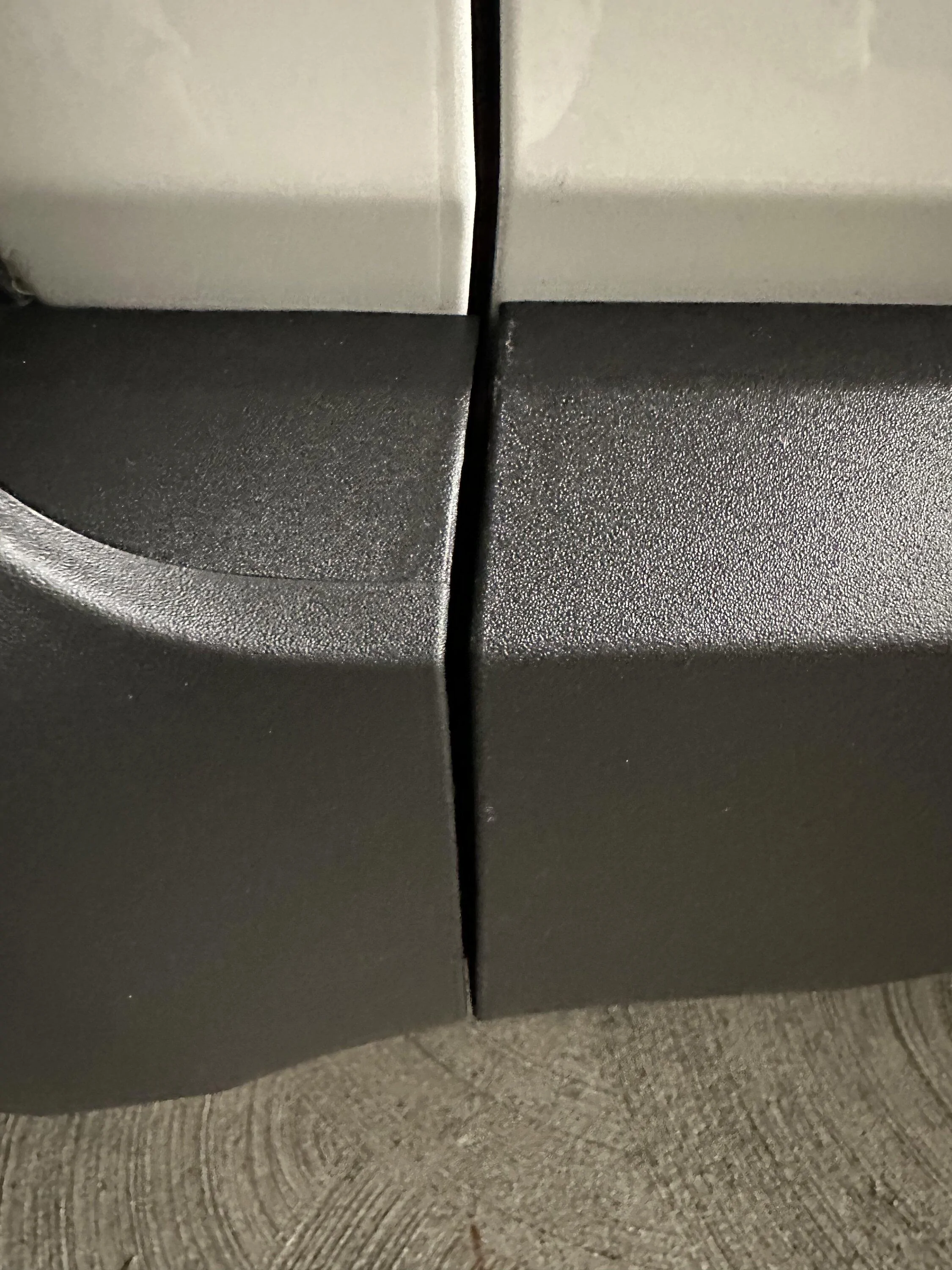

I am a software engineer. People only see the he issue. The sw defect need to be reproduced. So I reached and found the same issue. I also reported two he issued: my blind spot is not working and the plastic trim is indented. I have an appointment for these. Yeah, it is a hw issue that you can see and believe.

I’m not sure what some slightly mismatched trim and the fact that your blind spot monitor isn’t working is supposed to prove? It doesn’t really add or subtract anything from the matter at hand here. Nor does your career hold any real significance either.

FWIW the plastic trim issue is present on every R1 I've ever seen, including mine. It's just the way they fit, I doubt the SC will fix that up much.
Maybe I'm wrong though - I haven't asked them to fix mine since I've not seen any without it yet.
I have twice and they quietly ignore it...
