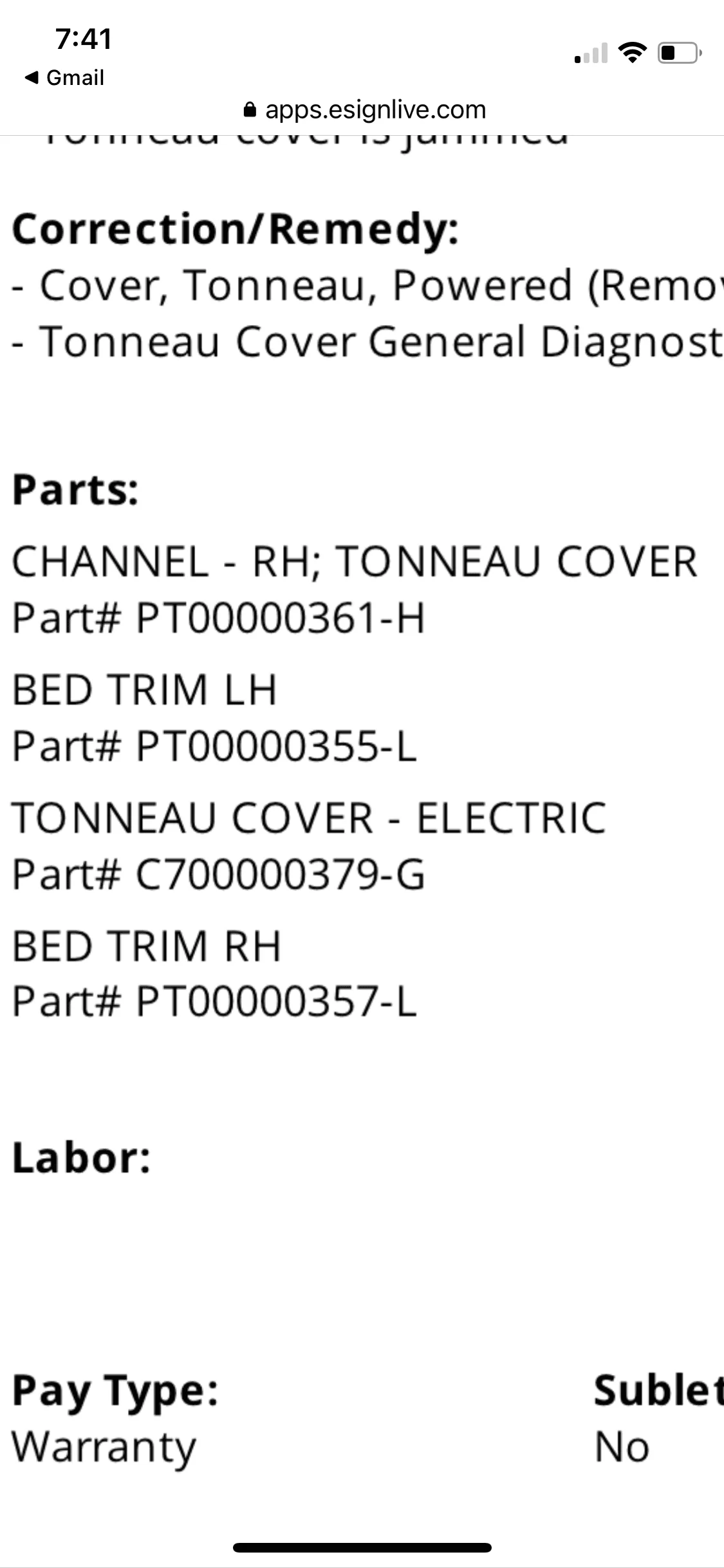

I can do that… it’ll definitely work better than it does now… (jammed diagonally)

I think that the 1 just came over in my copy/paste from the quantity column… so looks like number is the same, at least on my repair order… maybe the actual part is different? Or the revisions don’t show up in the part number and are tracked separately?
Revisions should not be included in a part number. It is bad practice. (Part numbering convention rant goes here)

Interesting— say more? That seems like the easiest way to track, I’d love to learn more…

I hope it’s the new new design. They tried to install a new version in my truck last week, it broke on install. Guys said they are 0/5 on installs of the latest tonneau, they all broke on install. They couldn’t get the panels out even once to just keep it closed for the winter unfortunately. New rails and all.
Oof— are you able to see the part number on your repair order? Would be curious if it’s the same

App keeps crashing for some reason, here is a partial screenshot
A part number should use no significant characters/digits.
Ideally they’re just sequential.
If a revision is substantial enough that the part doesn’t interchange, it must receive a new part number.
ASME Y14.100 section…6 I think is a good guide.

Looks like the same as mine, except mine calls for more parts…
