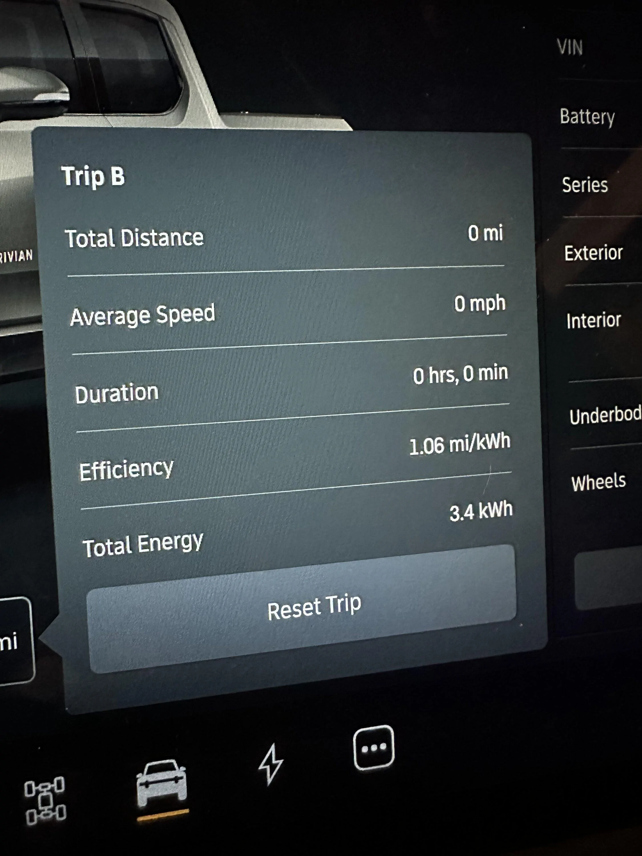

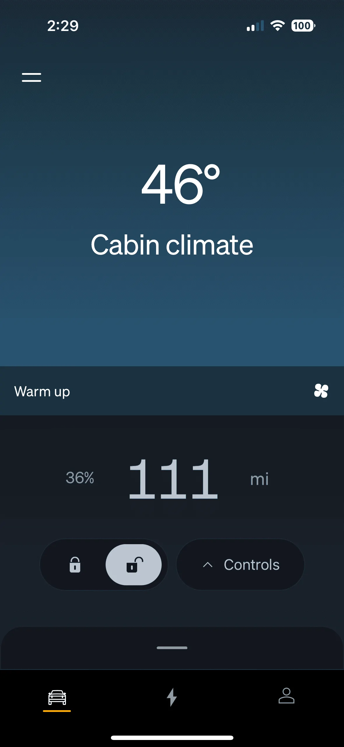

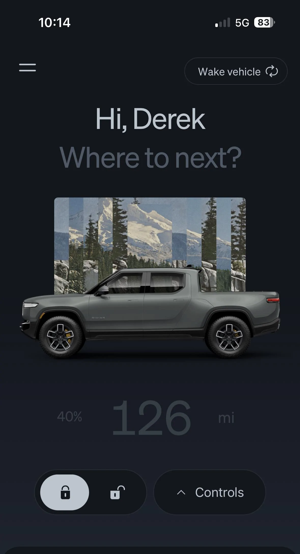

Finished a test over the weekend, as we had to drive our ICE vehicle to the mountains for a ski trip because I don't have a tonneau cover yet...but that's another story. Left the Rivian in the garage, unplugged, climate off, audio off.
  • Started Thursday at 10am at 40% SoC and 126 miles of range.
  • Came back today (Sunday) at 2:30pm to 36% SoC and 111 miles of range.
  • Total energy usage was 3.4 kWh.
  • 76.5 hours total time.
  • Not scientific - lost about 4.7 miles per day, ~1% SoC
  • Scientific - Using 0.044 kW/hour when sitting idle for this test or 1.067 kWh per day.
It's not good, and I want it lower, but it's not terrible.
