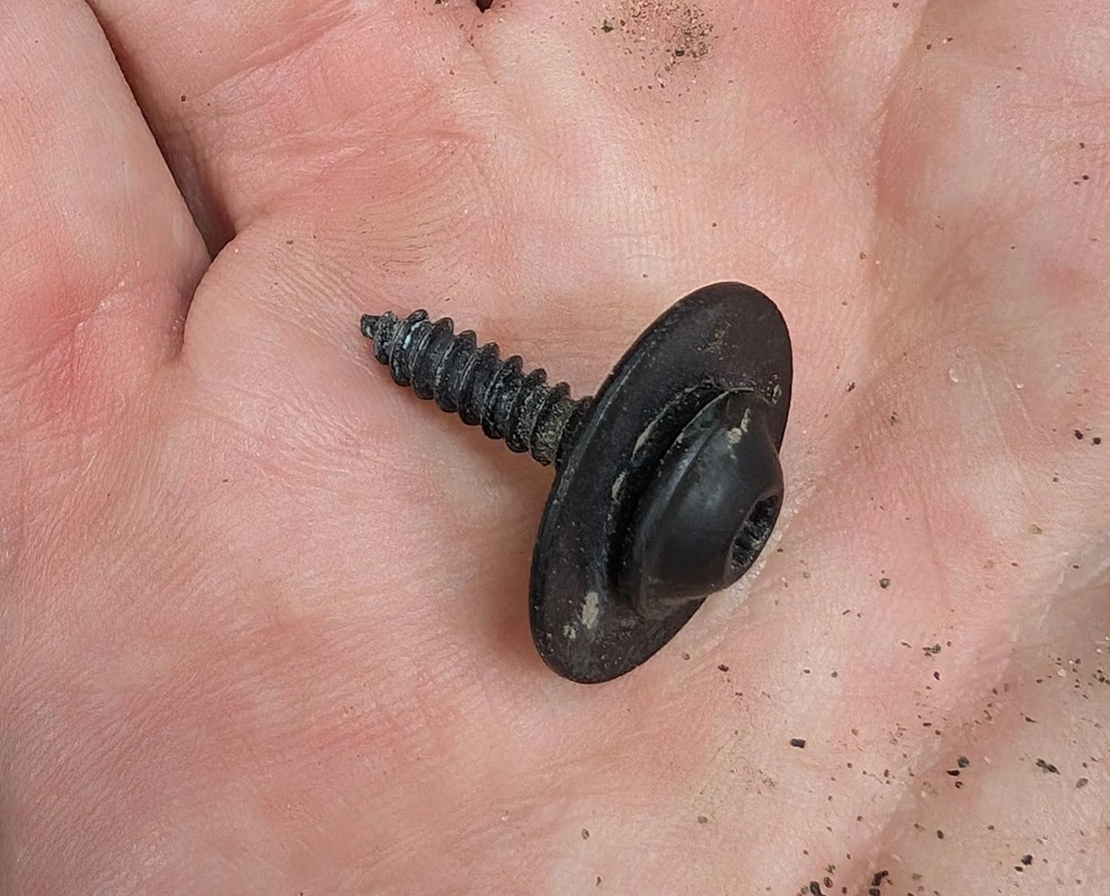

I hate to beat a dead horse (when there's already a million threads on the topic), but did we ever figure out a solid source for the T20 bolts that hold the plastic body panels on?
These suckers:
Rivian R1T R1S Where to source replacement Torx bolts? 1728339682579-m6
Just noticed one of mine is missing, LOL. ??
These suckers:
The closest I found was on Amazon - https://www.amazon.com/gp/product/B0BFGGXX31/ref=ppx_yo_dt_b_asin_title_o00_s00?ie=UTF8&psc=1
The Torx head is a slightly different size, but all else is the same.
I searched McMaster-Carr, Grainger, etc. but could not find a match in black oxide.

Thanks for the link! I confirm these fit well enough for mine. Or as the saying goes, "close enough for government work". ?
Awesome! Yea... not perfect, but 98% of the way there!
I ordered several on Amazon... these were the only ones that worked.
