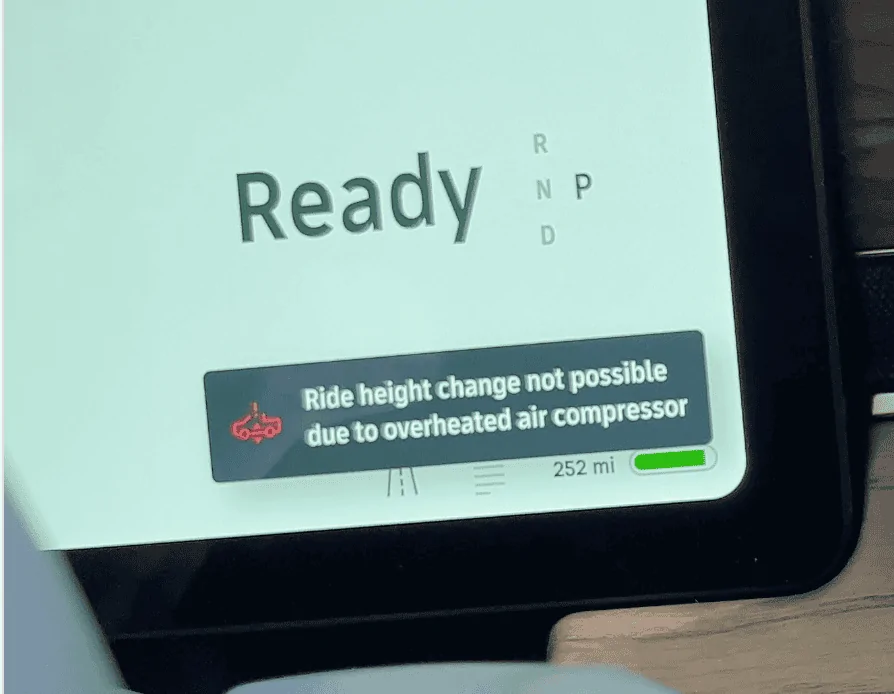

After two plus years I took delivery today of my R1T Launch Edition. They delivered it on a flatbed and walked me thru all the setup and LOVE the looks and size of the truck even more in person. Delivery folks were very nice and helpful.

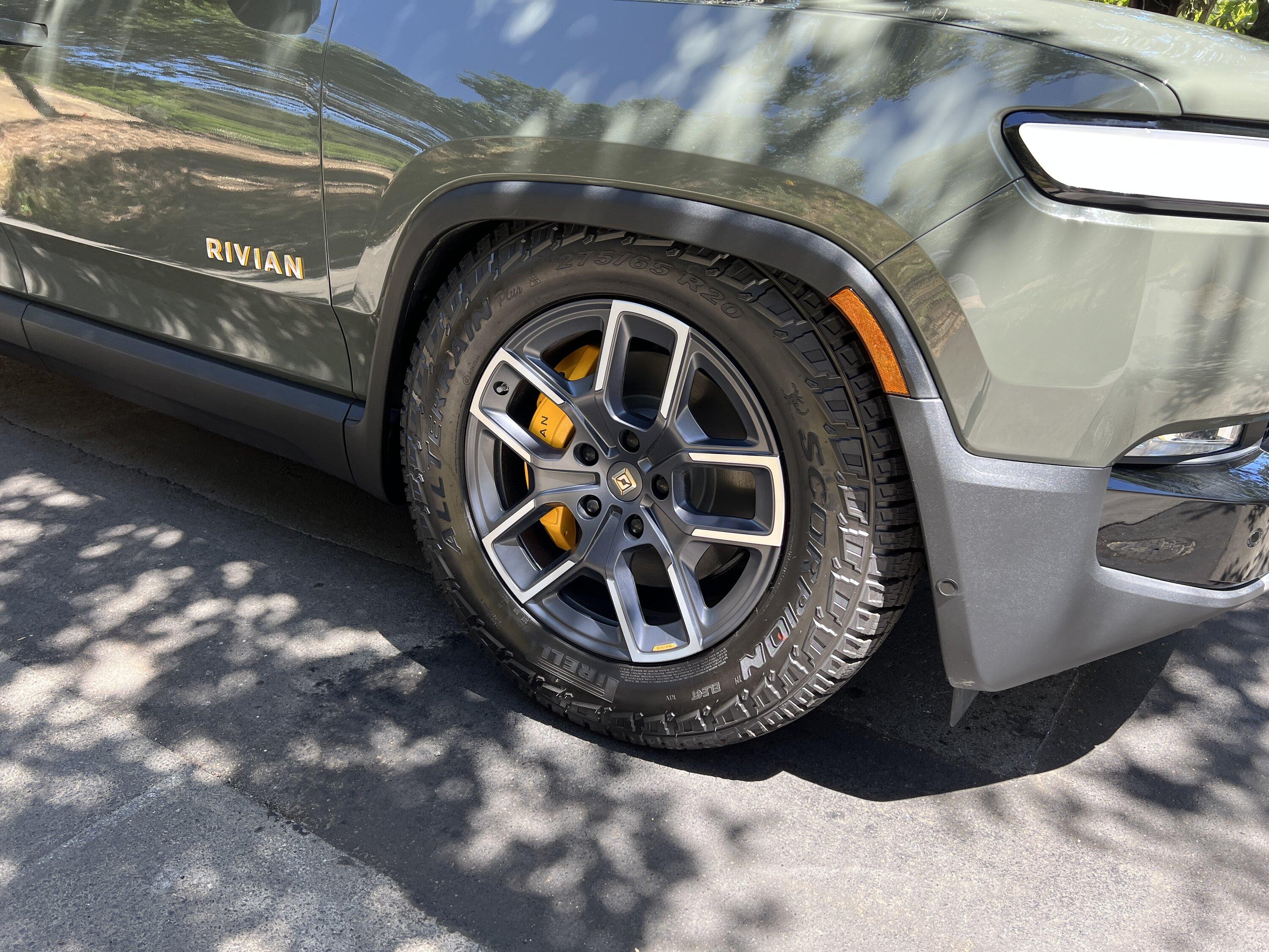

I crawled around the vehicle for 10 min checking things out and then said 'let's go drive this beauty'. I left my house in Conserve mode and then got to a windy part of the road 1/2 mile from my house and thought I should put in Sport mode. I promptly pressed "Sport' and expected to feel the truck handle the curves even better. Instead I hear this horrendous rubbing sound and soon realize the truck is grinding against the tires. I try to raise it back up but nothing. I pull over into the shade - it's only 75 degrees here - and get out and see the truck is all the way down sitting on its front tires. I try to change ride height and nothing happens (with "Ride height change not possible due to overheated air compressor" error message).

I saw a warning that the air compressor was overheated even though it's not hot here and therefor it could not raise the vehicle.

The compressor overheating issue hit me once as I was showing the truck off to some people. It was stuck at the lowest and would not raise. After a few hours, dinner included, it was working just fine. Not sure how long that compressor overheat timeout is.
But that horrendous rubbing and grinding does not sound good at all. Hopefully it's a quick fix.
Thanks - truck was sitting in the sun while the delivery folks showed me the features but it's not hot here. I can only assume a hose came off or something. I sat for 20+ min in the shade at 60 degrees (?) waiting for the flatbed.

I left my house in Conserve mode and then got to a windy part of the road 1/2 mile from my house and thought I should put in Sport mode. I promptly pressed "Sport' and expected to feel the truck handle the curves even better. Instead I hear this horrendous rubbing sound and soon realize the truck is grinding against the tires. I try to raise it back up but nothing. I pull over into the shade - it's only 75 degrees here - and get out and see the truck is all the way down sitting on its front tires. I try to change ride height and nothing happens.
Am I correct in inferring from this (see above), if the air compressor is not working when the R1 is in its lowest height setting, the R1 is essentially not drivable --i.e., horrendous rubbing sound?

Similar thing happened to me on my first mile drive. The rivian employee showed us the highest suspension setting while in the driveway. Then we went to test drive and it wouldn’t lower due to compressor overheating. It restricted the speed to 25mph (or around there). Drove for 5 mins and then it was able to lower the suspension and we continued the test drive.

I can all but guarantee the compressors aren't overheating from normal adjustments. More than likely there is a leak or other problem causing the compressor to be overworked which leads to the overheating. Or perhaps even a bad sensor or software issue causing a false alarm which shuts things down. In the OP's case, it looks like there was a leak causing the compressor to work overtime to compensate (which it can't when there is a leak) until it had to be shut down due to overheating.
This was my experience with RangeRover air suspension. After about 55,000 miles It would overheat from time to time. I changed out my compressor at about 60,000 miles after it wore out trying to keep up with the leaks in the system.
