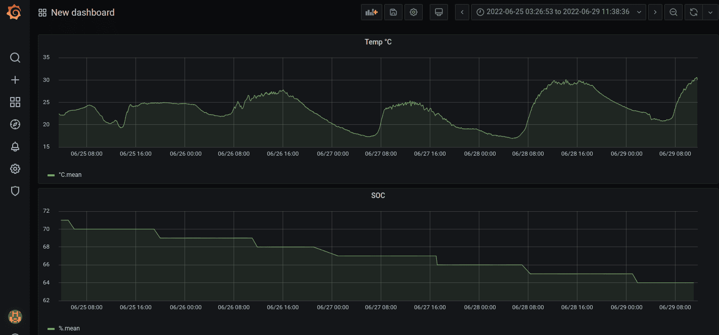

Rivian R1T R1S Any tests done on Vampire battery drain? Screenshot from 2022-07-05 15-15-14
With gear guard off on 2022.19.3. About 7% lost over 102 hours. Hoping this has been improved in 2022.23.3.
Looks like the battery loss is not a slow continuous loss but rather comes in big sudden losses about 16 hours apart. Not obvious related to temperature but we would really need to look at battery temperature not ambient temperature to know if it is going to battery cooling.
