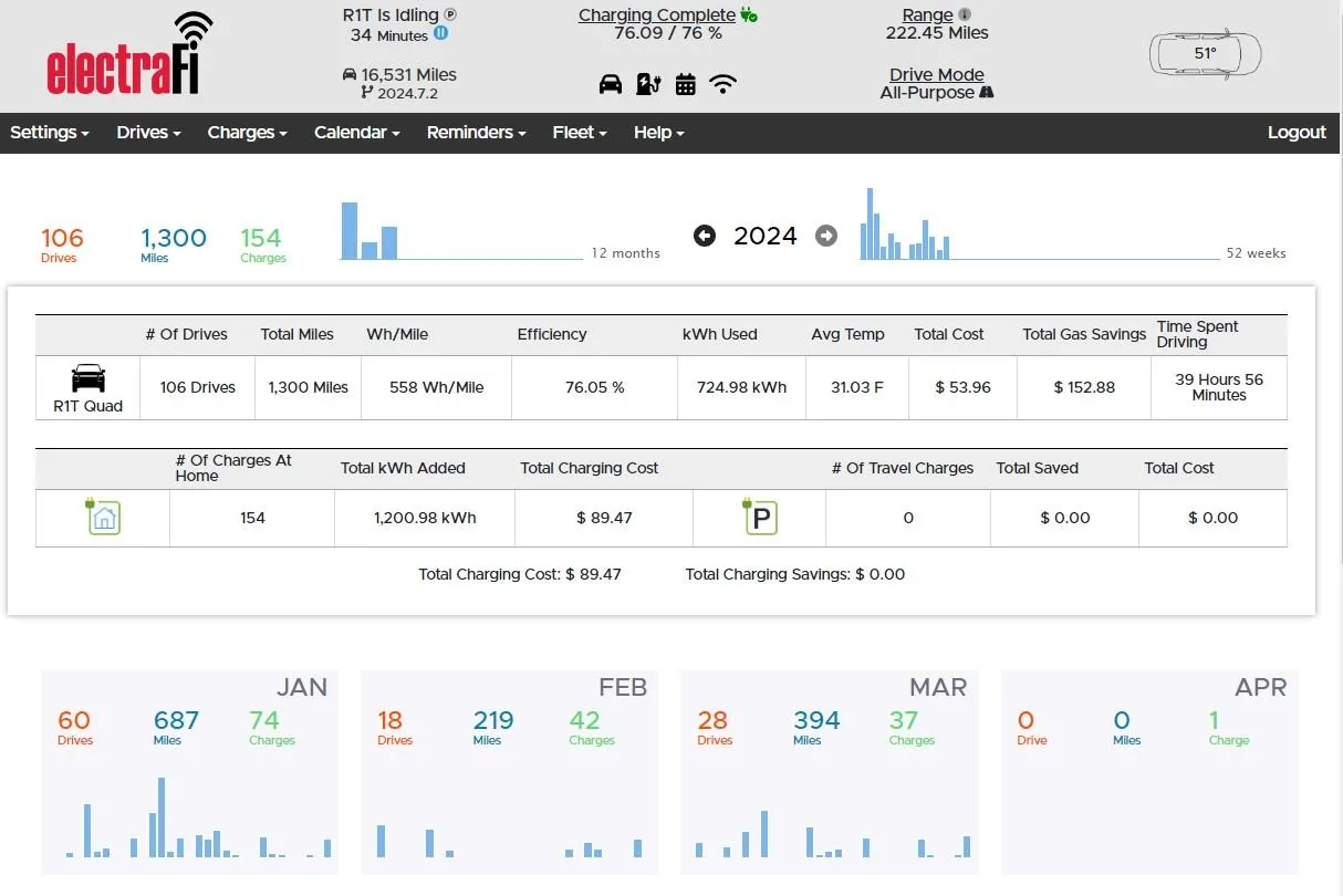

I'm also addicted to ElectraFi and love checking it to see my stats. I'm a data analytics professional for my career so I love stuff like this.
There are literally only ~400 connected Rivians out of 10s of thousands of drivers. Would love to see more of us on there so we can compare to our peers. I do understand peoples' hesitations with their data, however it's all being collected by Rivian anyways, why not be able to use some of it?
