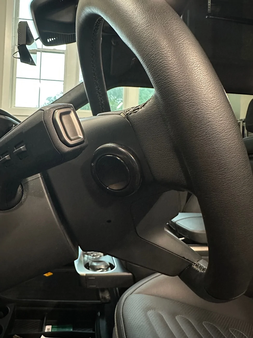

I forgot to include a photo of the toggle button behind the wheel. Here is a photo of it.
