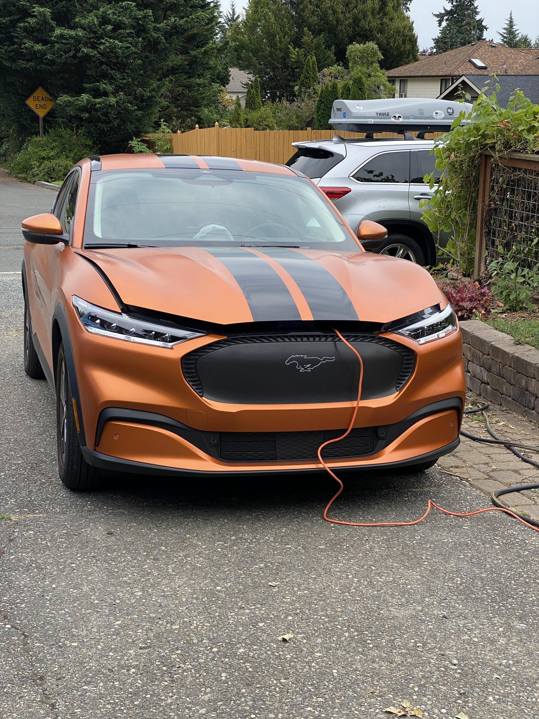

This was my ‘21 MachE a few months after I bought it, same situation 12V died while I was charging overnight; Ford did release a software update a few months after many experienced it, still did not solve all issues. Had to pop the frunk and charge the 12V - once I did that carried on with my life. Irony of using a 12V charger on a 400V EV ?
