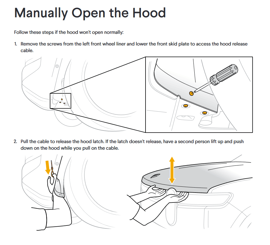

If you're comfortable doing stuff like this, you can manually pop the hood open then charge the 12V batts with a regular battery charger...
Does anyone know if there is a video (perhaps on YouTube) for this procedure? The instructions and diagrams in the Owner’s Manual are barely adequate.

Have you started to charge your 12V yet OP?
Looks like we’ve covered almost all the methods in the thread, from the rear 12v access - to manually popping the hood which from the instructions seems very straight forward (and honesty a little worrysome as that makes the frunk that much more insecure in my eyes)

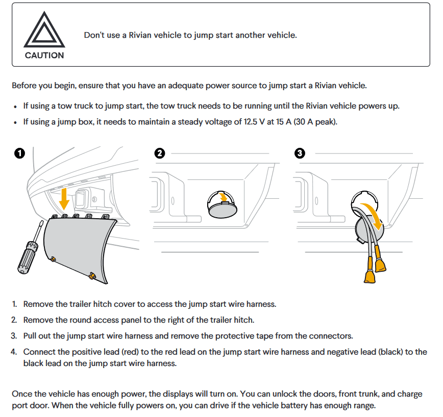

Are these “pigtail leads” the socket for the trailer plug or a separate set of leads back by the hitch? Trying to figure out what I’m looking or before sticking my head under my R1T.
Rivian R1T R1S Bricked 1704648686569

Thank you. I was on my phone and w/o access to the manual, and quite frankly wasn’t sure what to look up! The thought that it would be referred to as “jump starting” actually never occurred to me, although it does make sense.

Yes. 3000A peak when only 30 is required.
To be clear, Rivian calls for a constant 30A within the range of 13V to 16V. I would not be surprised if most jump packs with really high peak current aren't able to sustain 30A for any meaningful amount of time here.
