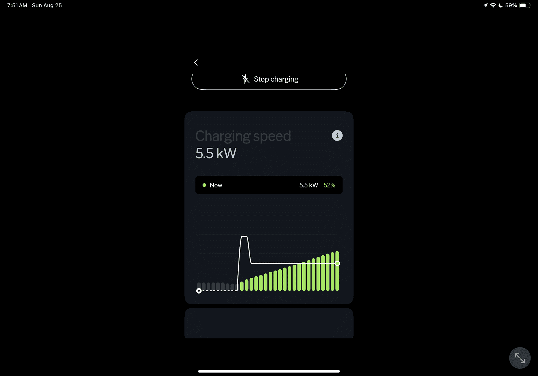

Wondering if anyone else experiences this.. When charging at home (with a Tesla charger) my R1S will charge at a reasonable rate for the first hour and then will drop often by half for the remaining charge time… Any insights?

Mine does the same thing. It's the thermistor in the NACS handle getting too hot and thermally throttling the charge rate. At least, that's my first guess. It gets - and stays - really hot in the garage here in the Florida panhandle. I've wrapped cold packs around the end of the plug, but it doesn't last much longer than a few extra minutes.
Does your Tesla wall charger have a red light at the top, but still shows the green lights "flowing" (charging at a reduced rate)? If so, it's likely the handle is getting too hot and the wall charger is protecting you from overheating. That's a (very) good thing.

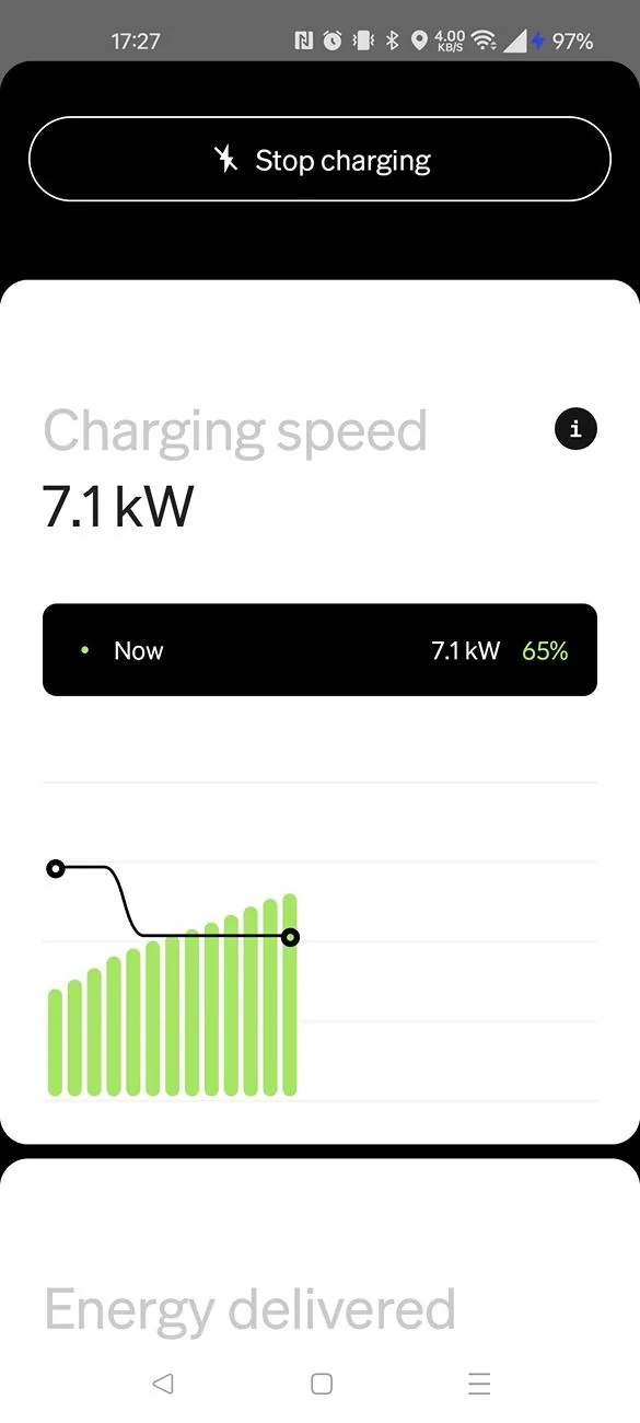

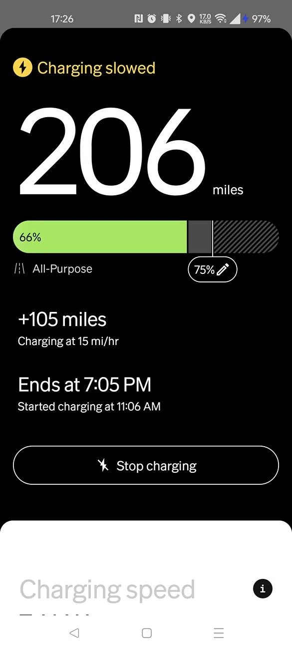

Same issues. Might be due to latest update. Not sure. Haven't had this issue before. Using rivian wall charger
Rivian R1T R1S Charging Rate Drops After an Hour… 1000010790
Rivian R1T R1S Charging Rate Drops After an Hour… 1000010789
