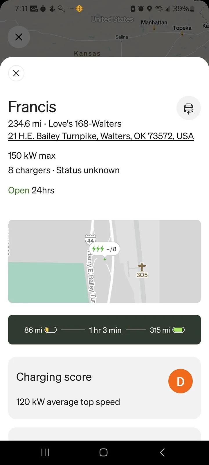

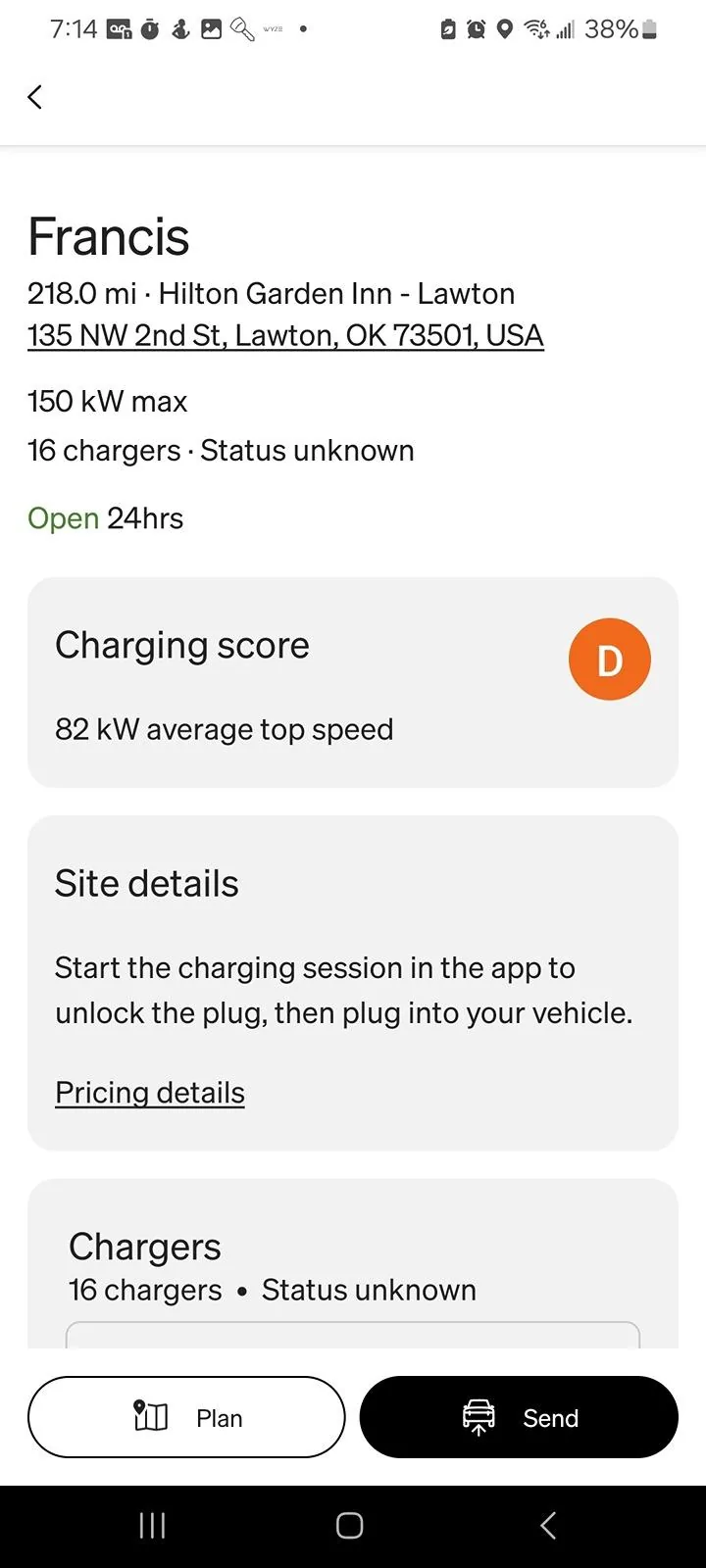

Well at least now that I got the update I know, lol. Went and bought 2nd R1 yesterday. Father in law along on other vehicle. Thought I would be stuck in Lawton. Seems the units that Francis units in OK don't "talk" well with Rivians. I just used in KS amd MO week before but seemed to be different units. Seems the D should be an F at both locations for R1s
Finally got one 50kwh unit to work at the Hilton. After going through a total of 11 and having to wait on it to try. I really thought Other oems came and charged fine. Never had an issue before so of course father in law was with me in chase car lol. Added 2.5 hours to what was supposed to be a 7 hour trip.
Also the recent layoffs did seem to impact call service. I have called Rivian in past amd got someone to answer within 30 seconds everytime. Both times yesterday 20 min and no one answered.
With 3 EVs I'm an adopter and willing to deal with "crap" but damn there are definitely regions you have to really consider ICE instead if only options are all the same type of units.
