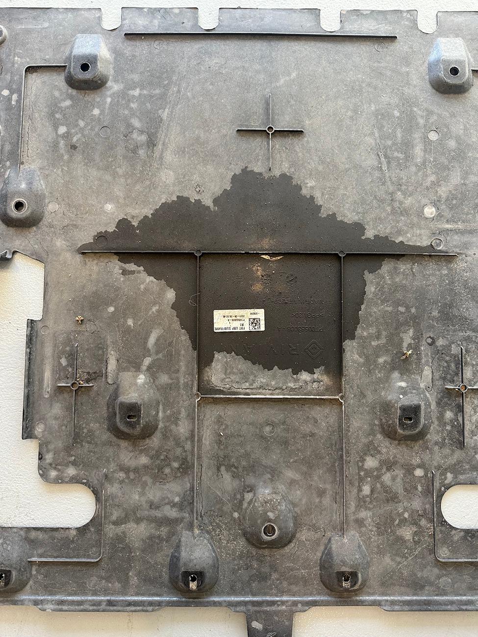

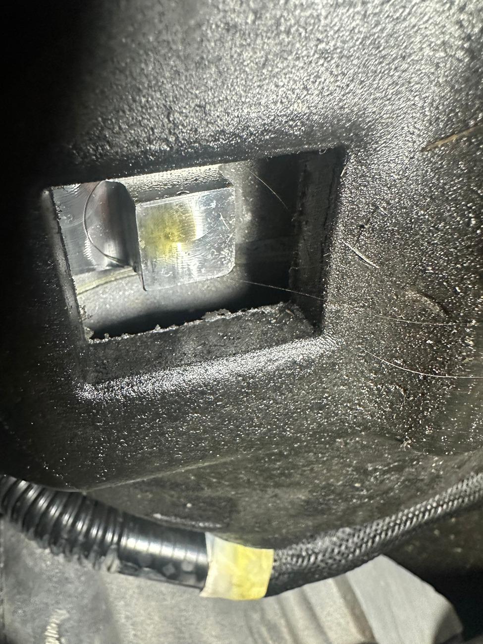

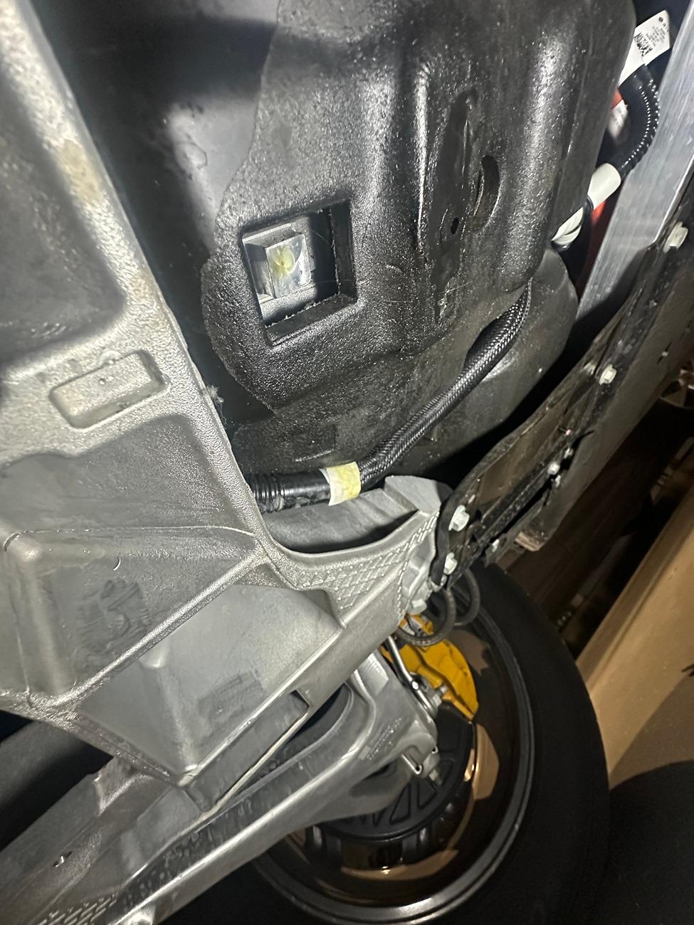

With another upcoming appointment in a few weeks I decided to see if I could locate the source of my 'clunk' since the time I asked Rivian to look at it they reported that the clunk was "N"ormal.
The clunk and suspension noise and harsh feel is the result of excessive play in the front driver half shaft where the shaft mates with the drive unit (see video). Passenger side appears to be fine.
https://youtu.be/A3ae653iTCg
As a bonus I also found that one of my front drive units is leaking oil. Exciting for having 7k miles on the truck
Rivian R1T R1S Clunking sound from front end. IMG_3129
Rivian R1T R1S Clunking sound from front end. IMG_3132
Rivian R1T R1S Clunking sound from front end. IMG_3131

Definitely show them this video so it's on record. And thanks for posting. Apparently the refresh solved this issue.
Yup, attached it to the service quote. I am sure they will take care of it now… just frustrating that when I first requested them to take a look at specifically the half shafts and demonstrated the clunk when going over bumps they said it was Normal. Again, sure they will sort it now that I had to pull apart the underside and fully illustrate the failure.

I just checked and mine is the exact same way - just on the driver’s side
I've had half shafts and hubs done on the front. Quieted it down mostly, but still occasional clunk when starting out. I've often thought its caused by the brake hold sticking or not in sync with the right side.

The tulip joint is held in with a circlip. Unless the clip is not retaining the shaft, there's likely nothing that can be done. Have to put it on a lift. They usually float like that. The other side might be under tension. Could also be a manufacturing tolerance issue. There is a seal which tends to leak at the rivian tulip.
I always thought the clunk was related to the air struts but yes it could be the driveshafts moving in and out at the drive units.

Subframe?
No, it's play in the half shaft—see previous posts in the thread—which is what Rivian's ting washer recall aimed to address (but not a permanent fix).
