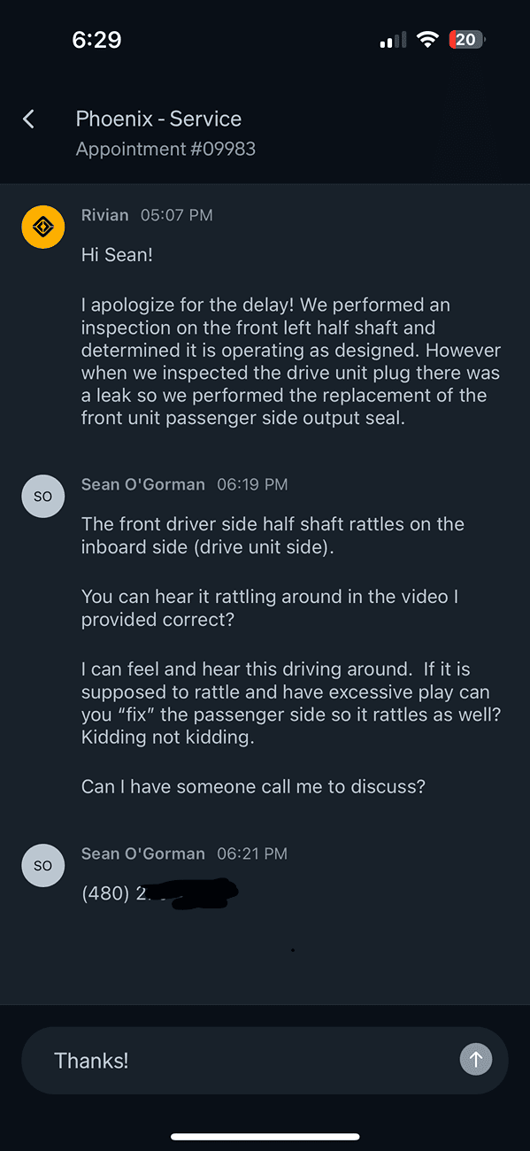

Update: and a sanity check from the group:
I have my car into service (been there two weeks). I created a ticket for the clunk on my front left of my vehicle which I believe I have nailed down to the front driver half shaft having excessive play in the inboard connection. I attached this video to the ticket (forgive me saying rear in the video, it's the front).
After Rivian telling me that my 'clunk' / 'thunk' that I am experiencing is "N"ormal on a prior service visit I took it upon myself to further diagnose this and provided the above video along with the write up in the ticket. Today After inquiring into the status of my repair here is the message I received.
Am I being unreasonable... crazy.. both or neither? This is a somewhat known issue with gen 1 R1s
I literally love everything about this truck but I have spent the last 8,000 miles trying to get it to not have a front end clunk when going over bumps, speed bumps, etc...
super frustrated.
super frustrated.
They eliminated some noises and clunks when they replaced half shafts and hubs on mine…but still get a clunk occasionally. I’ve kinda given up after two years.
super frustrated.
Seriously laughed out loud at fixing the passenger side, thanks for that! I'm frustrated with you and will probably have the same unfortunate experience with service here again in a few weeks. Fought Tesla for years on the Model X acceleration shudder too until they finally came up with a solution.
super frustrated.
It's not worth it... There's no fix as of yet... I just stopped trying(after 4 visits to the SC) and I go over bumps at 30+mph, so the suspension don't have time to oscillate, it just hops over them at higher speeds(it's fun too ;)). I'm sure it's not good for the suspension but it's good for my mental health :CWL:
