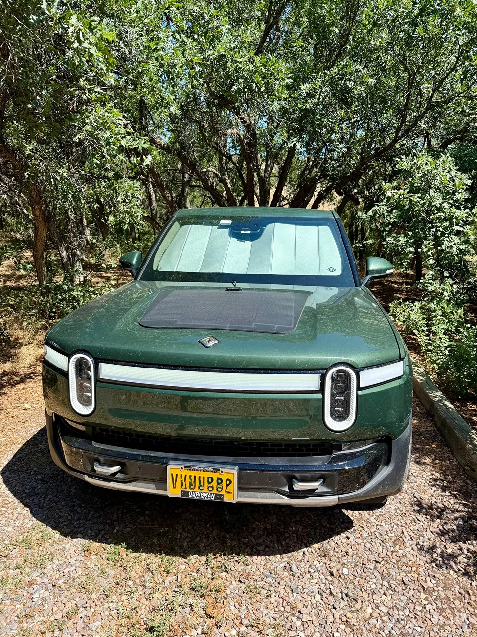

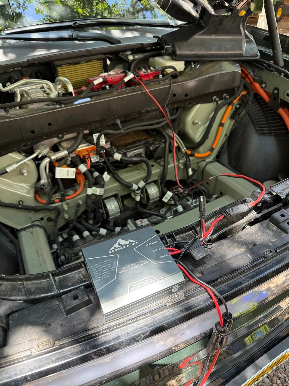

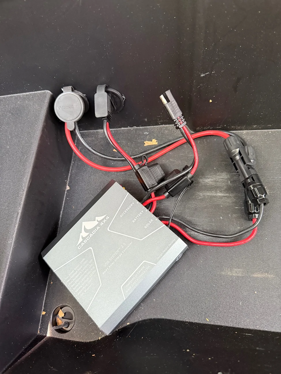

I finally got around to wiring up the Cascadia solar panel directly to the battery! I'll leave the truck unplugged for as long as I can to see if and how it affects the VD. It's a 94 W panel (I think, would have to check the label), and even in partial shade where I have it parked right now it reported that it was charging the battery at nearly 5A. I ended up running the wires from the solar panel to a panel-mount Anderson connector with an MC4 adapter, and then a similar panel-mount SAE connector with a long SAE to ring terminal cable leading to the batteries. I considered switching everything to Anderson, but I think I like the unambiguity of having the the connection that actually goes to the truck's 12V system be a different connector, and that's what the charge controller was using there. I do still intent to eventually put a battery and DC to DC charger in between the charge controller and the truck so that it can continue to charge overnight as well as just adding capacity for high-draw accessories like a powered freezer, but this is at least a good step in that direction and will let me make sure it all works before investing any more in it.

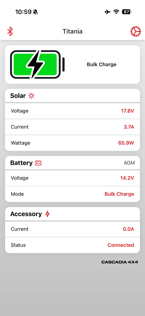

Well, I lost 1% off my SoC since yesterday, however I didn’t get the panel set up until the afternoon, and it never got full sun, so it wasn’t a great test. The panel is currently in full sun, at a decent angle, and generating 65.9W. I wish it gave better info on the charging performance, but at least I know it is charging (the battery’s at 14.2V compared to the 14.0 it showed yesterday). Tonight should be a better test; hopefully with a full charge the 12V system won’t lose enough to trigger charging off the HV battery before the sun comes back up and takes care of it.

Do you have a charge controller between the panel and the battery?
Yes, the Cascadia 4x4 branded box in the picture in my post from yesterday. Cables from the solar panel are routed into the frunk to the controller, then another set of cables is running to it from the 12V battery.
This is a photo the setup being tested before I routed all the wiring.

Sorry I missed that, looks fancy and may have temperature compensation. It looks like it's cooking where you parked. Lead acid batteries don't like to receive full voltage when hot and this could damage the battery if done repeatedly. Good charge controllers adjust the charging voltage accordingly. Also be aware that a solar panel's output diminishes with temperature (e.g. 0.3%/'C is pretty common). E.g. a 100W panel might, maybe, make that at 20'C (and perfect angle, etc.) At 60'C panels temp you are down 12% just due to temperature. (60'C is "hot to the touch", you don't want tp keep your hand on for more than a few seconds). With the panel laying directly on the hood, I bet it gets smoking hot. I am working on a similar idea with a small LifePo battery that charges during the day and trickles the truck battery during the night (and during the day). Vampire drain is a bit of a misnoma, as drain also happens during the day, we just don't pay as much attention to it. Keep up the good work and I look forward to your results.

Yeah, the temperature is definitely a concern. I already actually have the Lifepo battery that I’m planning to put in the middle, just haven’t had the time to get everything else sorted yet, and wanted to have this set up before I leave the truck in an airport parking lot at the end of the week, which should be the first real good test. I’m planning on using a Victron charger in the final setup, so temperature compensation should be doable.
